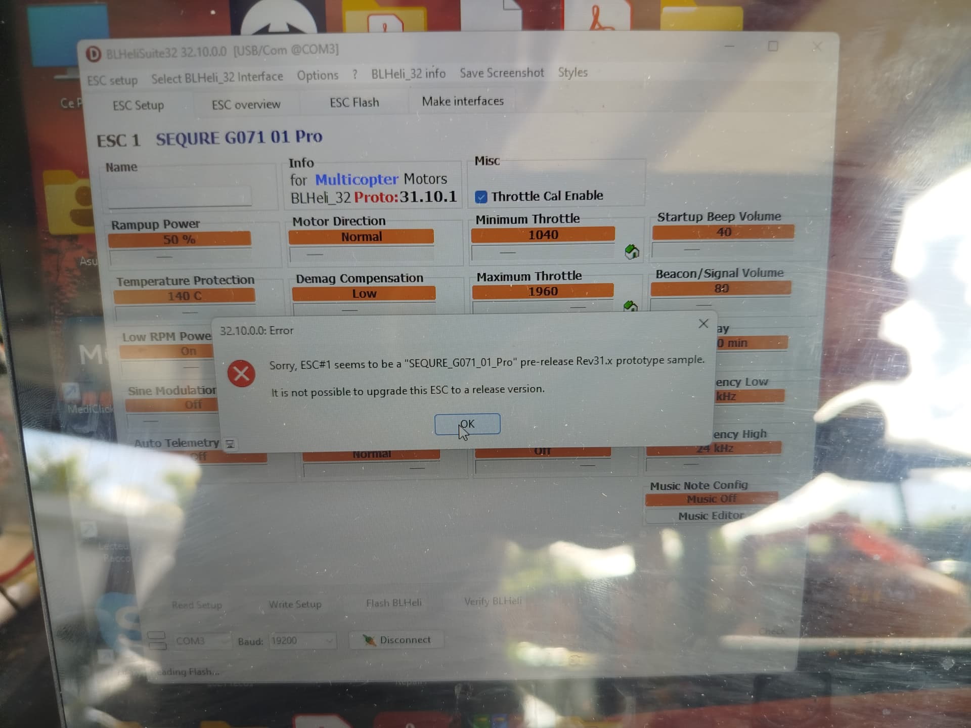

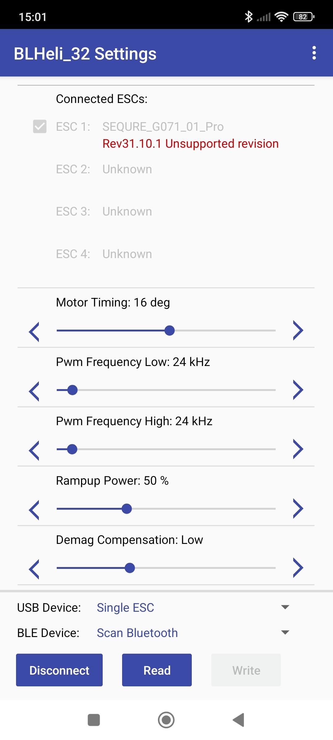

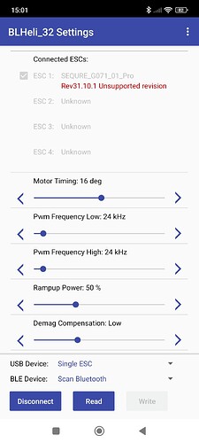

Sequre 12200, unsupported version, impossible to connect
Do you know this problem with Sequre 12200 Blheli 32 ?
Sequre G071 unsupported version
Thanks
Hi! I can’t really tell from the picture… are you using the tester version from blheli that floats around here?
yes I tried
BLHeliSuite32testactivator 31.10.0.1 and BLHelisuite32 32.10.0.0
You need BL Heli_32 Rev.: xx.xx.x
It’s been released by the esc manufacturers for post bl heli support discontinuation use.
Secure provide a link on their site
On this site there is no xx.xx.x version ?
Ah apologies for that, I checked the site and saw the link and assumed it would be the correct version. I’ll see if I can find where I got my version ……
I managed to connect after formatting and reinstalling Windows. Thank you for your help.
