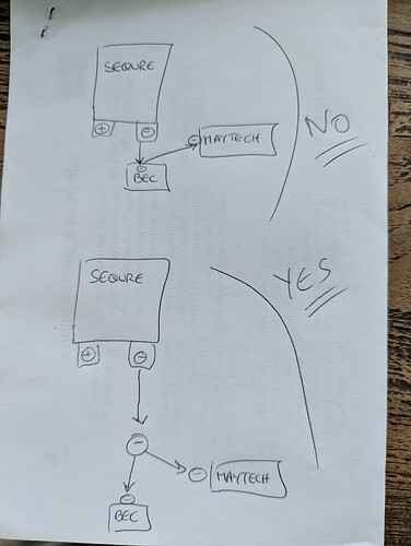

@foiling_moose I found the problem of cutouts with Sequre 12200
This is due to the negative wiring, it should have been wired in a star configuration.
How was yours wired ?
Could you explain it more precisely please ?
My english is too poor to explain, so I send this picture :slight_smile:

The Sequre 14200M has a built in BEC so no need for an external BEC as you have drawn. Negative and 5V out from ESC can go straight to RX :call_me_hand:t3:
Have you tested and confirmed the star wiring setup made an improvement? Good to know for other ESCs
Sorry, I read too quickly, I thought you were talking about the 12200. (I have one 14200M too, no cutout)
Yes no more problem with star wiring setup. I verified with two 12200 setups

If I understand between BEC and Receiver you only connect a PLUS 5V ?
I tried the shared GND connection on the 12200 but no luck, still getting desync issues.
