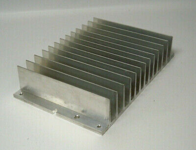

Similar to this but make it full perimeter flange so it can be mounted through a box or housing to expose the heat sink to water. I still think you will need some sort of box or enclosure as other electronics aren’t waterproof anyway.

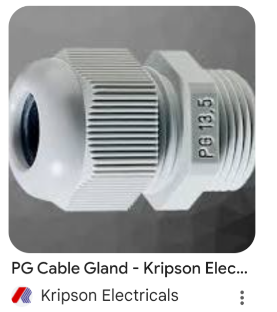

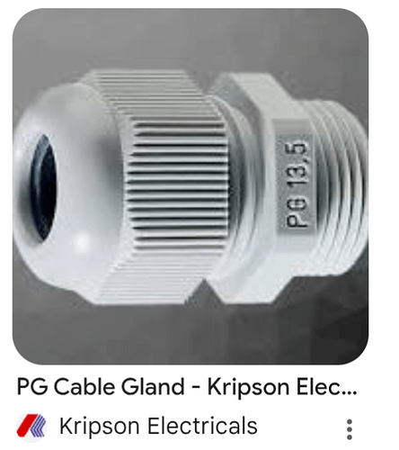

I plan to mount this esc outside of a pelican and connected to the battery and receiver inside through a PG
How would you prevent the ESC from moving if mounted outside of the housing/box ? Adhesives ? Like @mekanism I had in mind a 3D printed ESC enclosure (not waterproof) guiding and masking the cables…
What do you mean by “PG”, even this without cut ?
PG also known as a cable gland

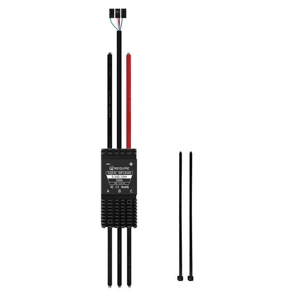

It turns out the waterproof ESC is already available for purchase:
@mekanism @Jezza
BTW you suggested flange and they did it…

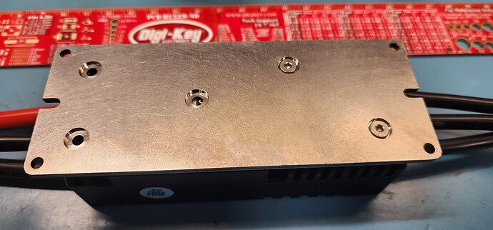

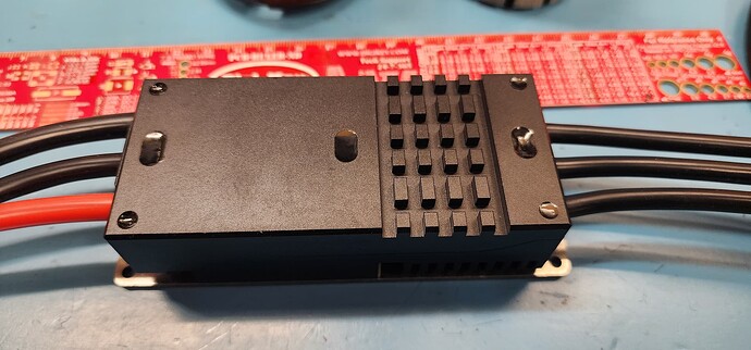

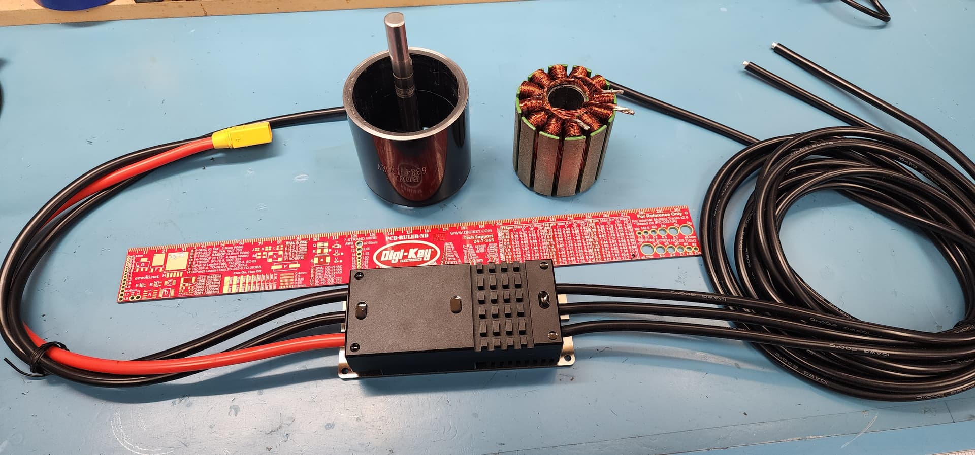

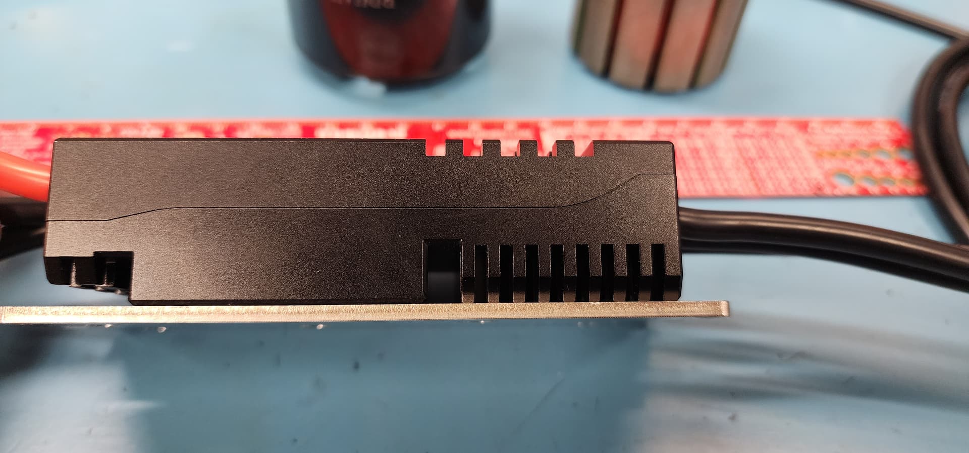

I thought I would share a few photos of the unit I received. The ESC seems to be working fine after some trouble getting it to connect to my PC (I had outdated drivers, my computer is 12 years old). I haven’t connected it to a motor or receiver yet but the build quality looks great. The mounting plate is stainless steel and is heavy, and only has 2 screws holding the plate on but seems stout. I purchased the long cable am32 configuration. I included a ruler and a 6384 motor in the pics for scale.
