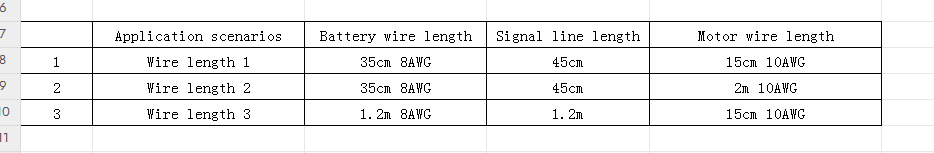

The length of the motor and battery power cables is still undecided. What length would you suggest?

  • motor cables long enough at least to escape the waterproof housing, ideally long enough to reach a tow boogie motor… (30-60cm?) with some appropriate bullet connectors. You can always cut them.

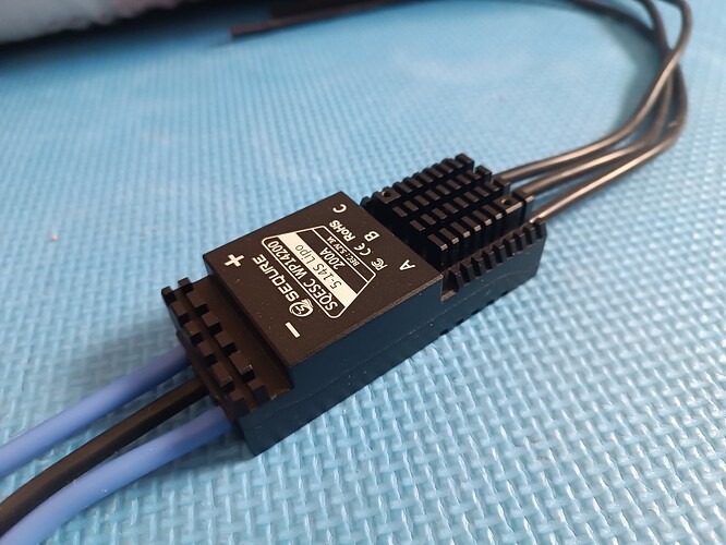

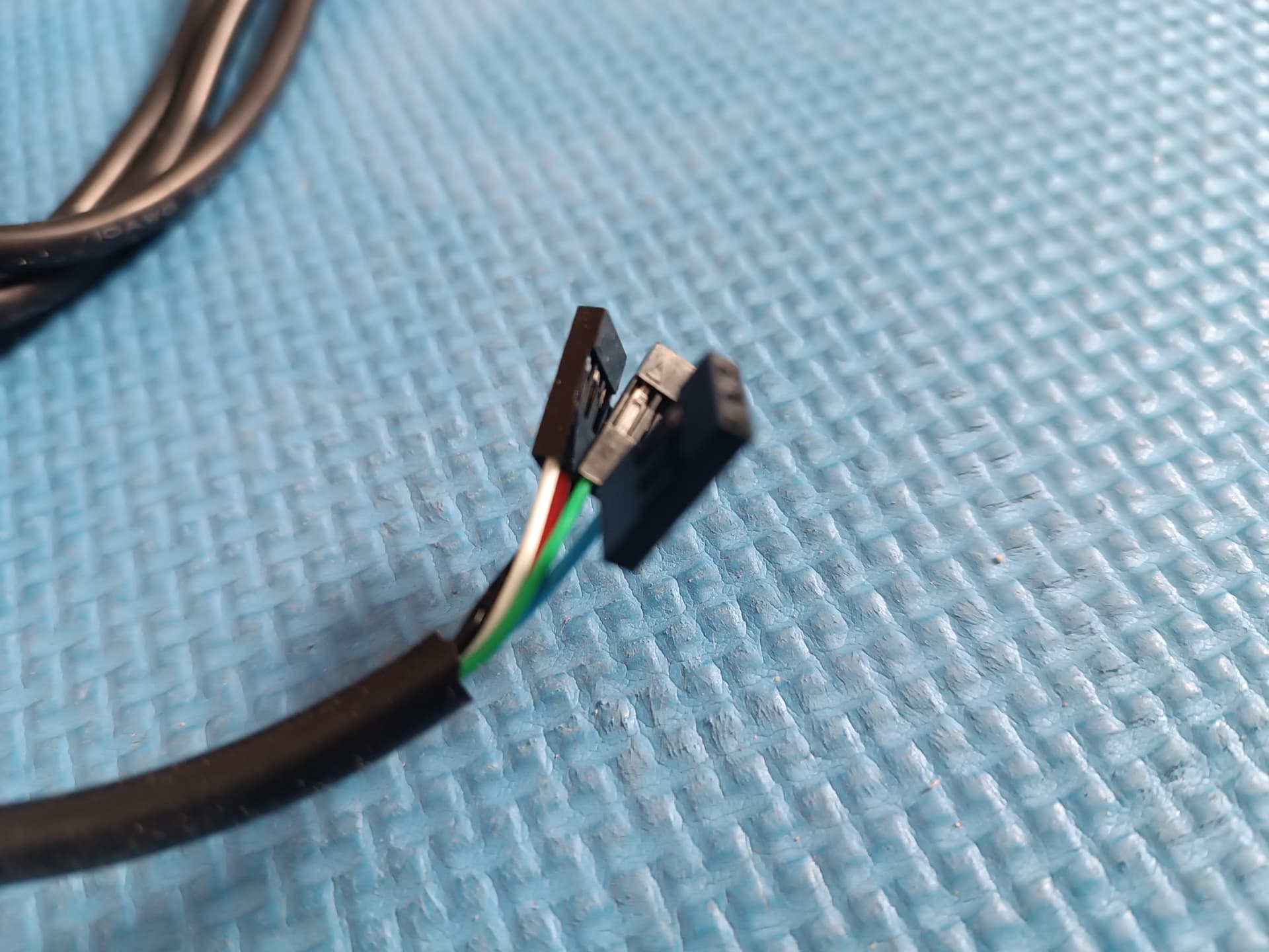

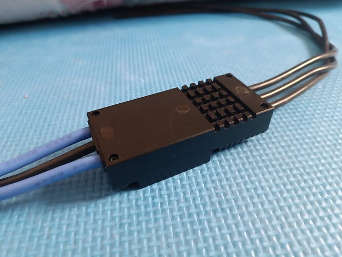

Updates on the development
Features BEC:
Suggested wire length options:
All the inside glued/potted as one.
It feels solid - like a brick.
