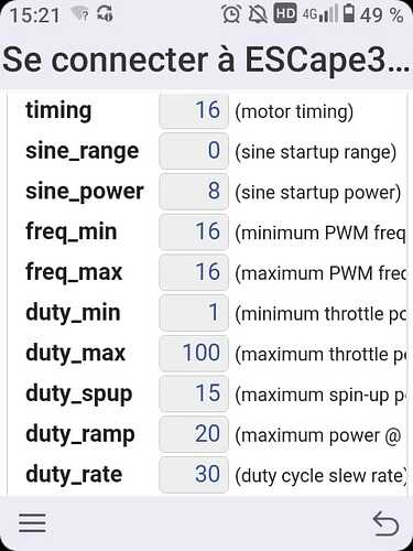

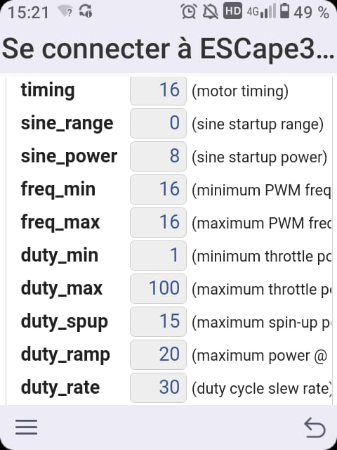

Carrying on Escape 32 fine tuning thanks to Claude AI because my 70165 is sensitive to cogging and ESC warm too quick.
It was previously possible to ride but without Damp mode active I had to compensate with a high timing to avoid cogging on take off. It clearly caused overheating.
The most important : Damp mode active keeps the temperature down and allows to lower timing
It allowed me to go from 20 to 16.
Duty Ramp from 0 to 20 limits the cogging also
Ride is enjoyable like this, no more esc limitation because of overheating. Remaining slight cogging at extra high load…
I increased timing to 18 only, ESC runs flawlessly without cogging or heating too much.
Update : I was reaching the first “slow down” temperature protection step when I was riiding full gas for a while. I changed the PWM max from 16 to 32. I can ride longer like that and the temp recovers quicker.
