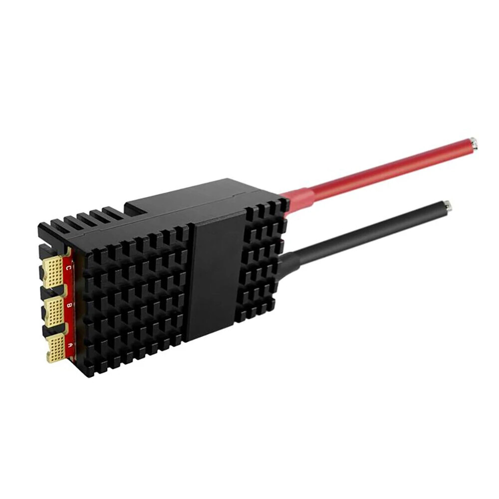

This is how 12200 looks on the outside:

Despite being very similar and having almost the same components, 12200 got a lot of improvements (ones that I noticed, I bet there are more improvements):
  • Mosfets: Xcross - NCEP016N85LL 1.6mOhm. 12200 - HYG015N10NS1TA 1.2mOhm
  • 12200 telemetry in the blheli32 version is way more accurate, it can be relied on.
  • 12200 pcb has thick power rails - it can be seen in the photo
  • First and foremost difference is the encompassing cooling solution, it really works, esc stays much cooler. Notice that the two aluminum halves are not glued in the middle and they have only a thin contact area.
  • In the water I got the feeling that 12200 is stronger.
