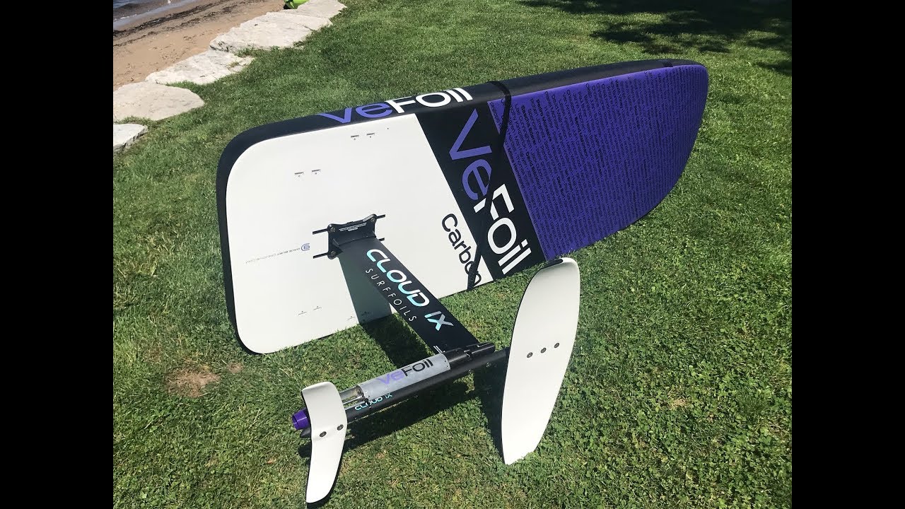

Completed prototype efoil board with built in compartment for electronics, so awesome to have a proper efoil board finally!
Super fun afternoon on the water today with direct drive jet foil
Im 255lbs (115kg)
20mph was top speed today but it can go faster.
