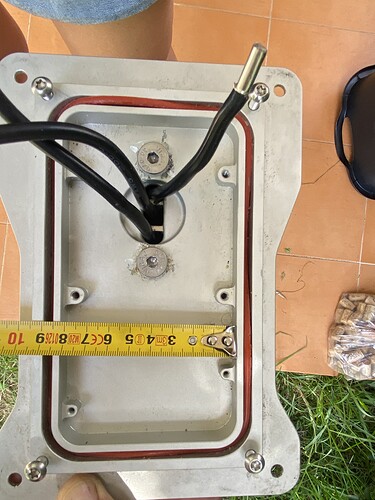

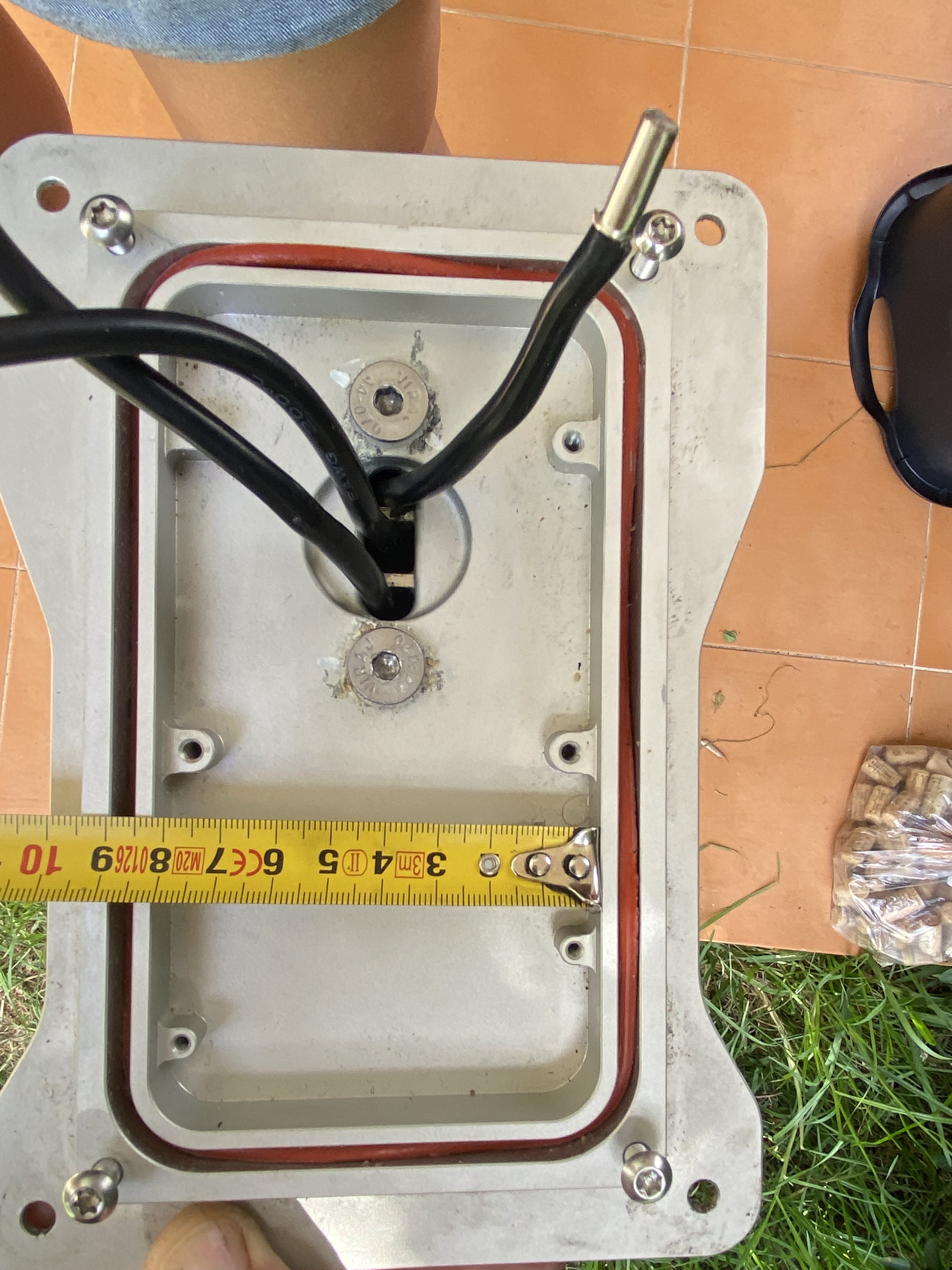

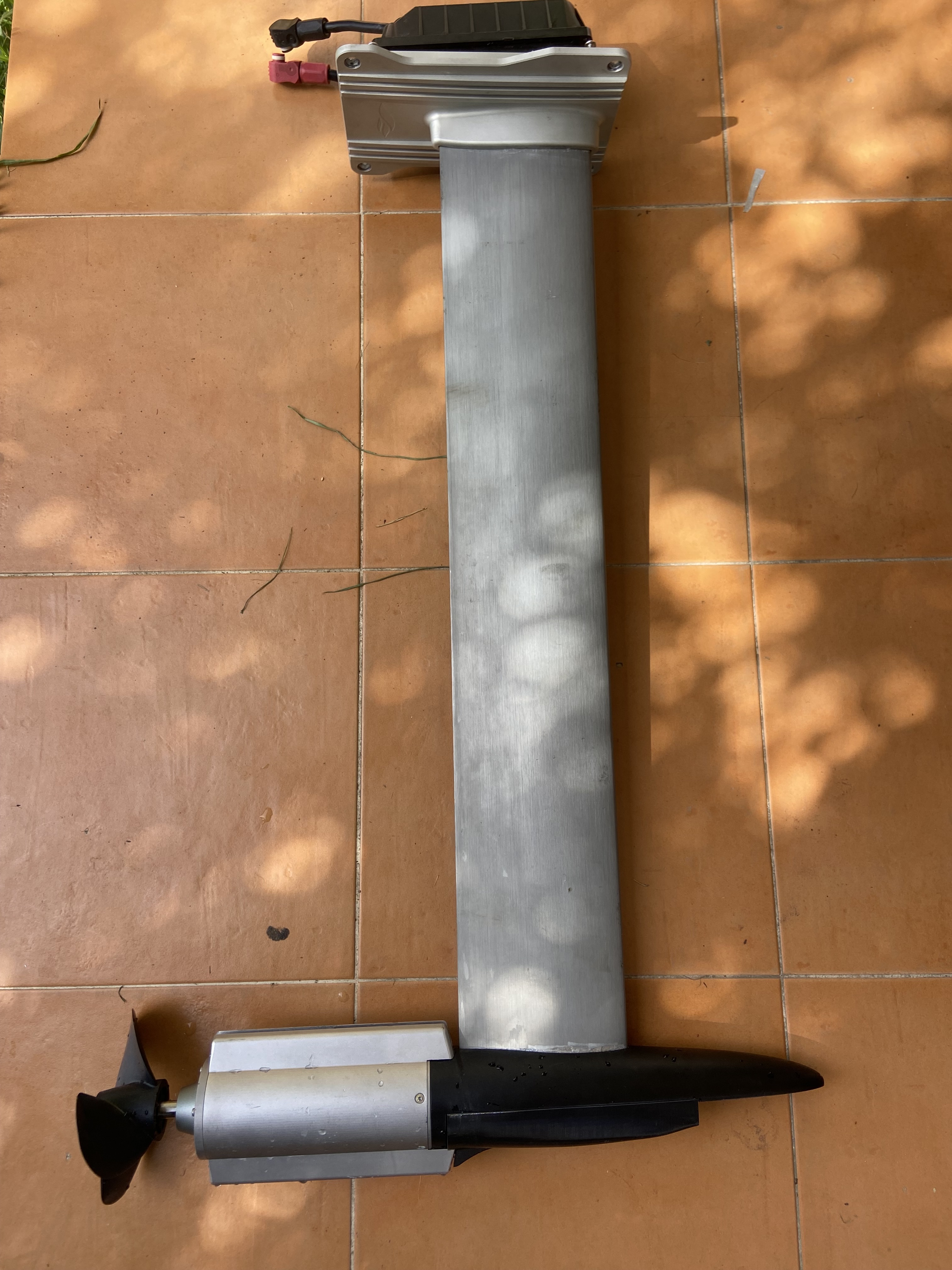

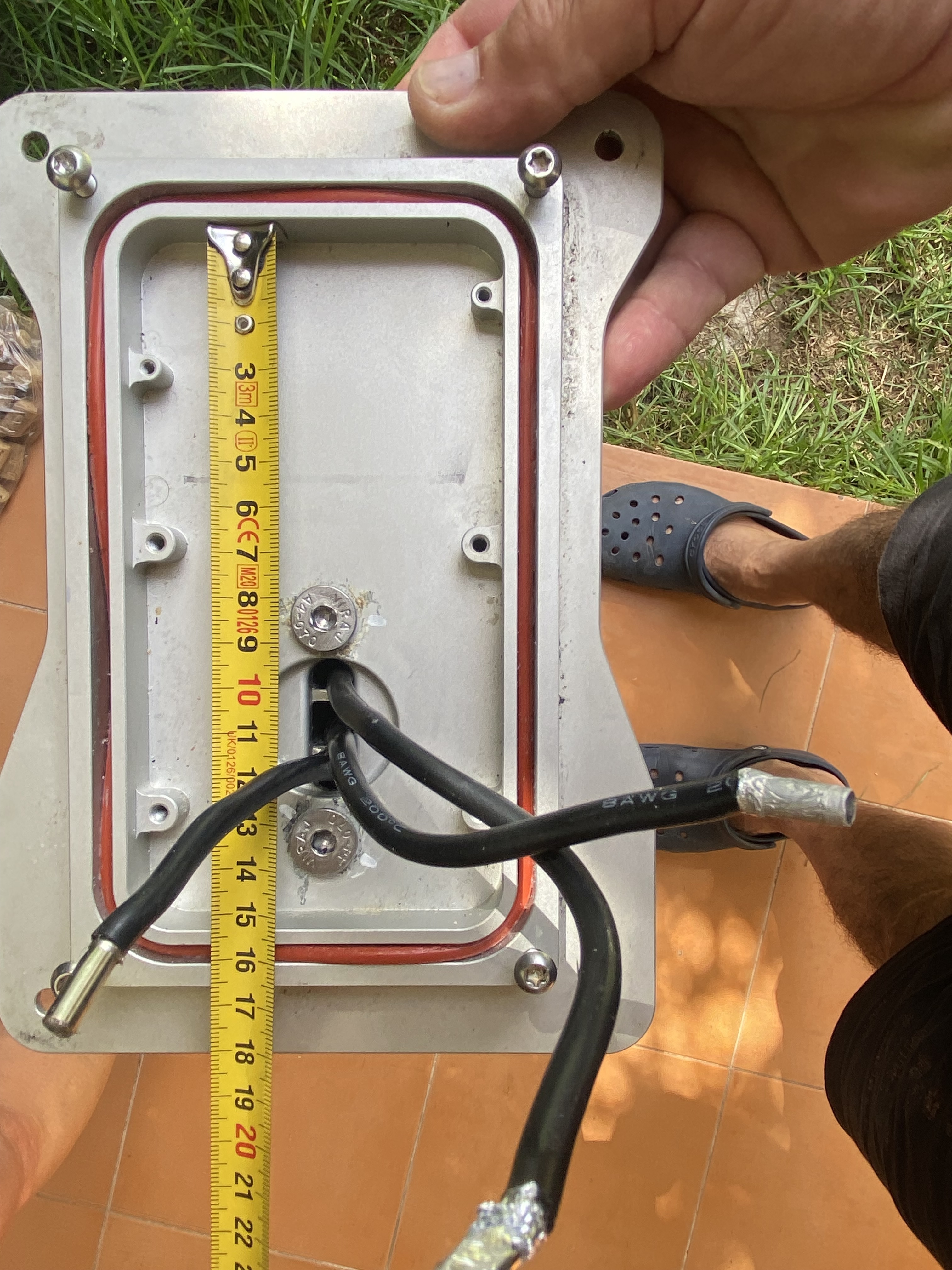

Hello, I receive from a friend a Sifly mast with the engine included, without elettonics.
Any advice for the vesc ?

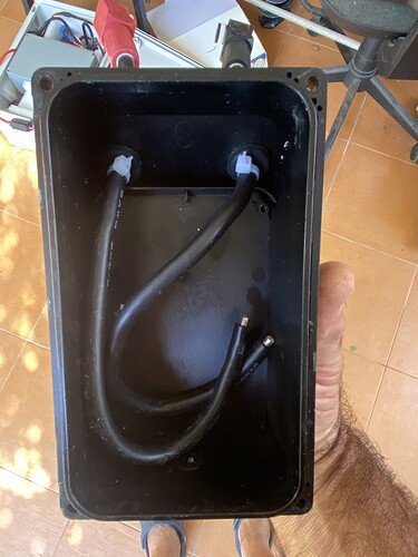

Im thinking on flipsky 75200 no watercooled , as I already have I have a 75300 watercooled in my first board, but I’m open to other brand, the idea is that should be one that cold be cooled by the mast, also I want to have the receiver inside the box.
Every ideais are welcome,thanks

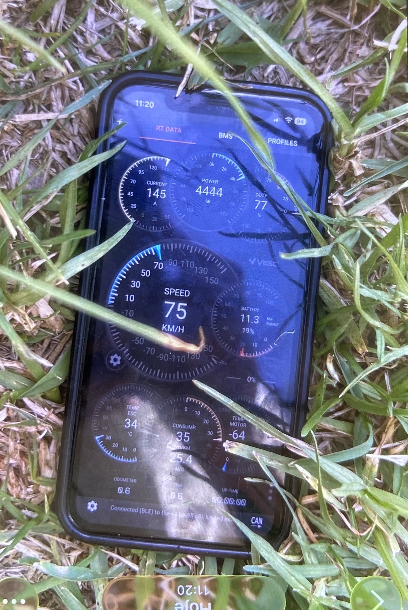

For the ones who have interest, the motor is very similar to flipsky 65161, the size, diameter and length, shaft is equal, and run with the settings of my 65161 with 75300 vesc.
I block the current to 145 A and we gave 4444 W, as you can see.
