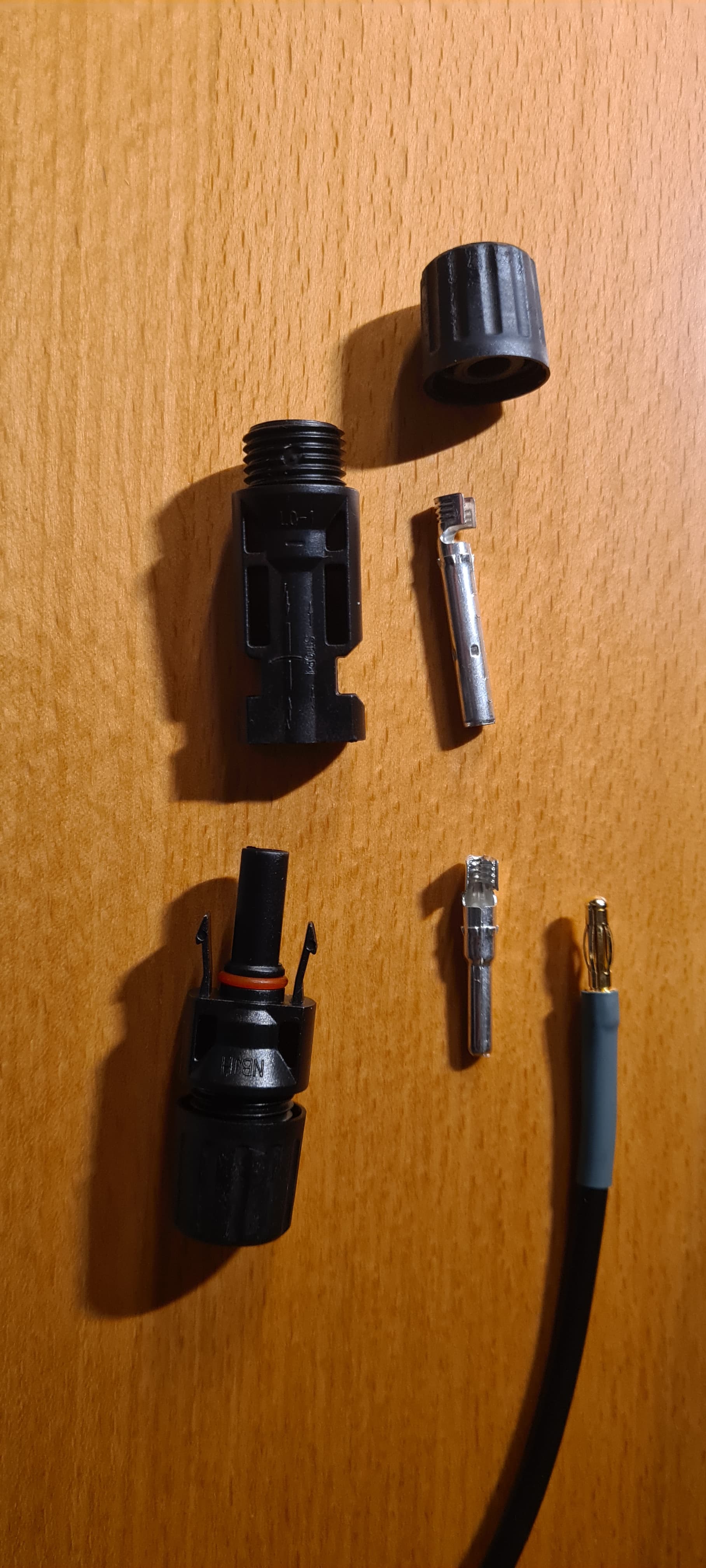

I absolutely do not agree. Significantly smaller then quite some alternatives. Image shows next to 4mm bullet.
The ones I bought are very pure copper and tinned, don’t see why they would corrode more then other non gold plated connectors. But then we are at way more expensive connectors if you want proper gold plating.
