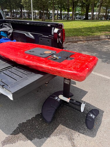

Hey all,
Been on the forum for a long time but I can now finally post my build since I am riding it several times a week now! Professionally I work in design and manufacturing of fiberglass wake boats. Outside of that, I got hooked on foiling a couple summers ago surfing the wake of our engineering fleet of boats. Several months ago I finally bought my second foil set with an Axis 1150 pumping setup. This freed up my old setup to become my efoil mk-2.0. The parts list is as follows:
-Flipsky 65161 120Kv Motor
-Flipsky 75200 VESC
-Flipsky FX3 Remote
-Liquidforce Flite 120 Setup
-2x 6S Lipo batteries in parallel (@12S)
-Homemade board (I think its about 50L but I actually have no idea).
Some notes about the components:
-The liquid force foil set was less of a choice and more of a convenience instead of buying a new setup. However, there were a lot of things about the setup that actually work great. The mast is hollow for the most part and fits the 8awg wires perfectly through it. The wing is small at only 1200 cm^2 and a short span, but it has really good lift at low speed and is stable all the way up to 18 Mph. (I haven’t gone any faster than that yet).
-The motor and speed controller are a perfect pair so far. Im hardly the first to use this combination, but its a reason its the gold standard on the forum.
-My diy board is great, I love it…BUT for its dimensions I made it wayyyy to heavy. Its a big board but I added a thick plastic stringer & the electronics box is heavy as well. Its not too heavy to lift off but its probably double the wieght it needs to be. This will be the part that I rework first. The lid that I used for the electronics box works really well. Its a bilge inspection cover for a boat but it does a great job at keeping water out.
Short video of me riding after work at the boat plant from yesterday. I’m still working on getting that telemetry tracking info that you all share, but I’m taking off at about 60 amps and flying at 20-28 amps

Which waterproof hatch did you use? After my initial ‘bolt on’ build worked great on my large wing foil board, i’ve begun planning a smaller board build, but see mixed results on hatches being waterproof.

Thank you, I love what I do! I work for Malibu Boats but MC is right up the river from us! I used a watertight inspection cover that we use for our boats. I can look up who the manufacturer is for that part when I am back at work if you want the exact same but its not any functionally different from this kind of item
https://www.amazon.com/Amarine-Made-Marine-Access-Hatch/dp/B00MUDJC18?source=ps-sl-shoppingads-lpcontext&ref_=fplfs&psc=1&smid=A1A4WAEGJNR9ED

We tried these hatches many times but never managed to get them watertight.
@Kian I agree and have seen many others with hatch problems.
@JohnBam My uncle has a 2000 23lsv that still runs and looks perfect! Malibu seems to spend the time building and sourcing parts that are top notch. Id be curious if you could pull a number off that hatch? Id love to try it out. I also imagine your deck is quite rigid. They seem to fail if they flex too much. (I bet that deck foam makes riding more comfortable :slight_smile: )
@agua4fun I will take a peek under the hood for some part information for you. Glad to hear you have good experiences with Malibu. I love taking out boats from our engineering fleet for after-work foil sessions.
@Kian I replaced the stock gasket that it comes with for one that is slightly thicker to get a better seal and it has worked. I have to smack the lid to get it to seat properly.
