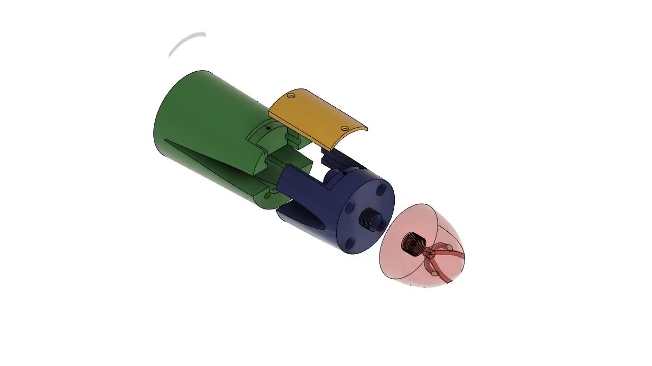

Mast clamp, prop and duct - Many thanks to Manu who inspired my water cooling mast clamp design
