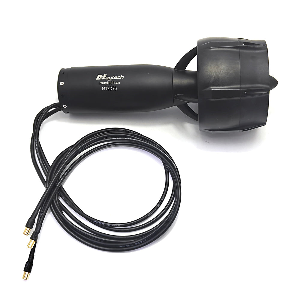

My old Flying Rodeo motor has finally siezed and I’m considering replacing it with the latest efoil motor maytech motor
Notice: If you worry about tariff, please email to agnes@maytech.cn, we will check other shipping methods for you. Specification: Model No. MTED70 KV 103 Current 137A at 48V Input Voltage 30-48V Max Output Voltage 6576W at 48V Max Thrust...
Price: USD 619.80
Has anyone mounted this to a slingshot mast and if so does anyone have the STL 3d print file
Or has anyone used any other method of mounting

Yeah sounds like its just time to get a new one. There are a few options depending on how you like to efoil…
65161/65162 120Kv motor (Normal efoil style)
6384 140Kv outrunner (cheaper, lighter but more assist style and slower than the 65161)
I have a few option I could sell too as I havent used then in a while. Just depends on what style of foiling you want to do…

I definitely want a prop guard, that’s why I was tempted by the Maytech motor that comes with a prop guard

The Maytech with propguard has a smaller prop. I don’t think anyone here has even used it yet. Flipsky also do a version. I’m not sure which is better or worse though.
