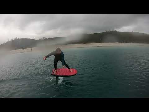

Did you cut up the pad like that, or did you buy it that way?
I like it! Im gonna steal that idea!!
I cut it up, I 3d printed a jig for the spacing. Was debating putting some black hex tiles in but I forgot

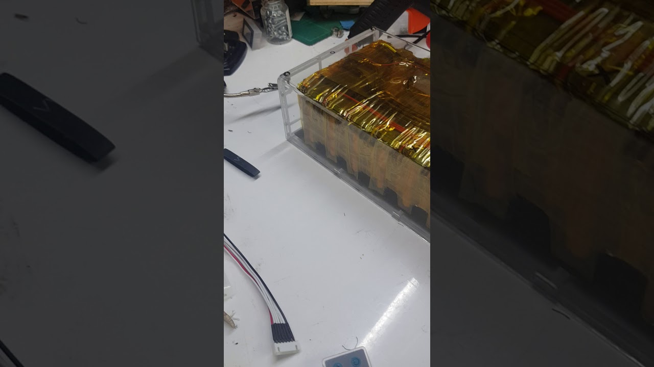

when switched off, is there still current draw from the bms?
Sorry I didnt see your comment earlier! The current draw on the bms is very minimal when it’s off. Something like 1ma.
Had the first water tests this weekend, havent processed the video yet also still waiting for my metr module to get logs. I think I need a better wing now
What an awesome build! Had to lough about that wipeout pic too…
I admire your perseverance in building your board!
Regarding wings, since i’m still learning i love the bigger ones >2000cm² or around 100cm wingspan
Next will be progressing to 1600cm² or 81cm wingspan on the RL Foilset.
I guess you’re using a 2018 Liquid Force Rocket Foil which is about 55cm wide.
That’s quite a sporty ride!
Thanks! Looks like we have the same wipe out style lol. Had a look through your build, very well put together! yep I’m trying to find a wing set that will fit the LF mast as the LF rocket foil is to hard for my friends to use. would also be nice to have cruising wing set!

4, deck padding is starting to peal off, the hexagon shapes look nice but with all the edges to catch slowly lift when lying and scooting up to the front of the board.
5, if you lay on the board and go full throttle when you hit the water you become a submarine ![]()
