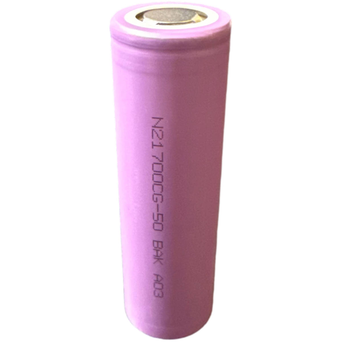

Cells: I was weighing between Bak 45D vs. Samsung 50S 21700 Cells but I did some basic math of overall weight and came to the conclusion my build will be a monolith no matter how I do and I can focus on weight savings if I want a different board, plan is now to run 20s6p with Samsung 50S cells, was thinking 20s4p and comparing the cells where the Bak 45D’s would been the better choice but for this particular build, however since we are going for “efficency” when on a foil and range I went for the bigger pack and weight is not optimal in this setup either way.

Any reason in particular you chose the samsung batteries over the bak?
Considering you can get 2 dollar vs the samsung. You can def pull more amps from the samsung
Because this was originally posted in 2024, tabless cells weren’t widely available at the time, now there is both higher capacity and higher discharge at the same time cells then 2 years ago.
Besides I dislike BAK cells they strike me as cheaper and less quality than Samsung and Molicell cells as there are more lemons than other brands in fresh batches.
