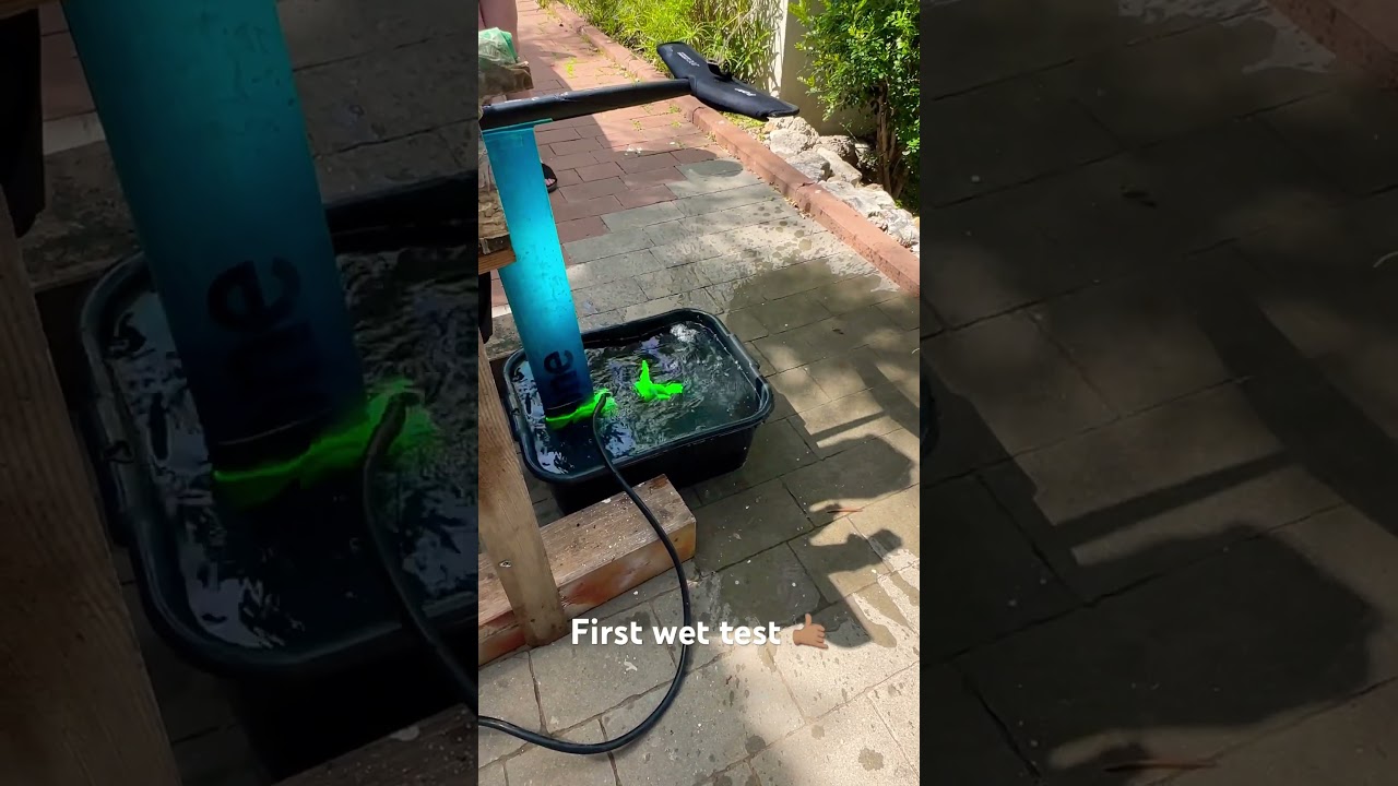

So… after connectivity test. Its time ti start getting things wet.
Connected the motor wires. Each wire got shrink tube with adhesive. Then all the 3 got shrink tube. I poured some silicone paste inside the tube, edges shrink was first. Then the middle such that silicone popped out from edges.
And doubled with another shrink.

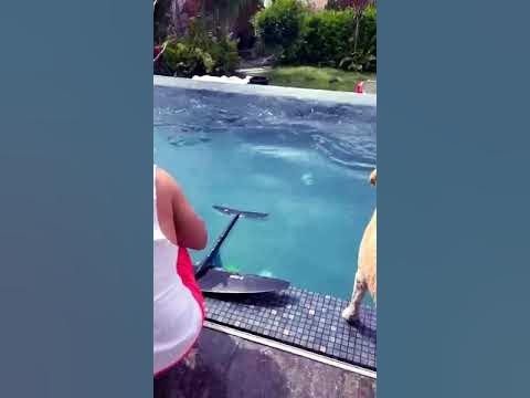

So test #1 in the ocean failed. I couldn’t go beyond 30% throtle.
That was surprising because previous test in a pool was a success from this point of view
What has changed?
The pool test proved that i couldn’t go by without adding external heatsink. So i followed other builders here. I cut a hole in the box and glued external heat sink. Moved the small board with input capacitors to a wires ( so i have room to attach the controller to the heatsink) - that seems to solve the issue!!!
The controller didnt have any contact with the heatsink thus i was getting immediate cutoffs. Outside the water it was running full throttle, which proves that load increased current, and created heat which didn’t have where to go.
So did some mechanical changes. Changed a 3d printed part to allow more room for pressing the controller against the heatsink and went on to next experiment.

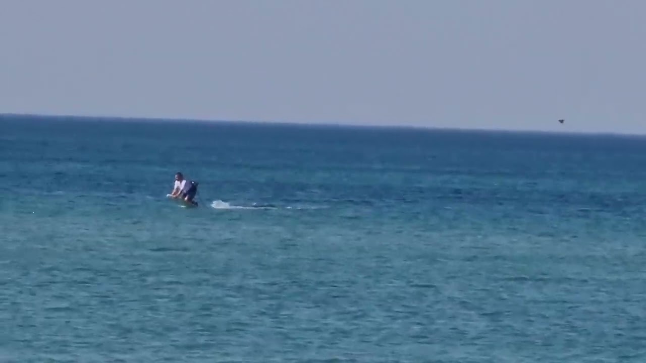

BTW: I had a good test in the ocean, everything worked, I just had the box not well tied to the board and it was rolling over on my legs, so had to give up.
will find a way to better tie it.

Adding some videos of a try out, in the ocean.
It ended up with a fire as one battery cell just expolded…
I am guessing that i had water leakage and that shorted that cell.
