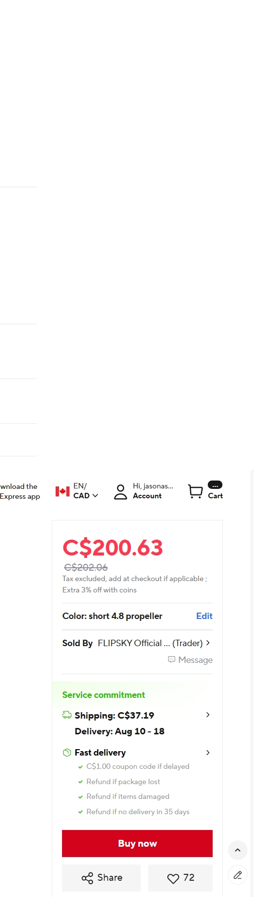

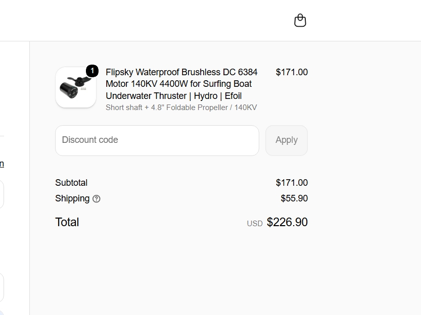

Well I went to buy the motor today and found it on aliexpress for $80cdn cheaper and it states that it is from flysky official company.
So the fly sky website says $226.90usd which is $318cdn
or aliexpress for $200.63 = $37.19 for shipping, $237.82cdn
Have any of you seen this before is it the same company and its just the summer sale on ali express…
I bought my XG50 cells and so waiting for the slow boat from china. In the mean time I’ve decided to make fiberglass pod mounts instead of 3d printed as I dont have a printer but I do have plenty of fiberglass supplies. I’m broke after buying batteries so looking to save as much as possible on the first proto type. so if anybody can confirm if theses are the same products that would be wonderful.here’s the links.
Cheers!
J.
Flipsky Waterproof Brushless DC 6384 Motor 140KV 4400W for Surfing Boa – FLIPSKY
Flash Deals Flipsky Waterproof Brushless DC 6384 Motor 140KV 4400W for Surfing Boat Underwater Thruster | Hydro | Efoil - AliExpress 18

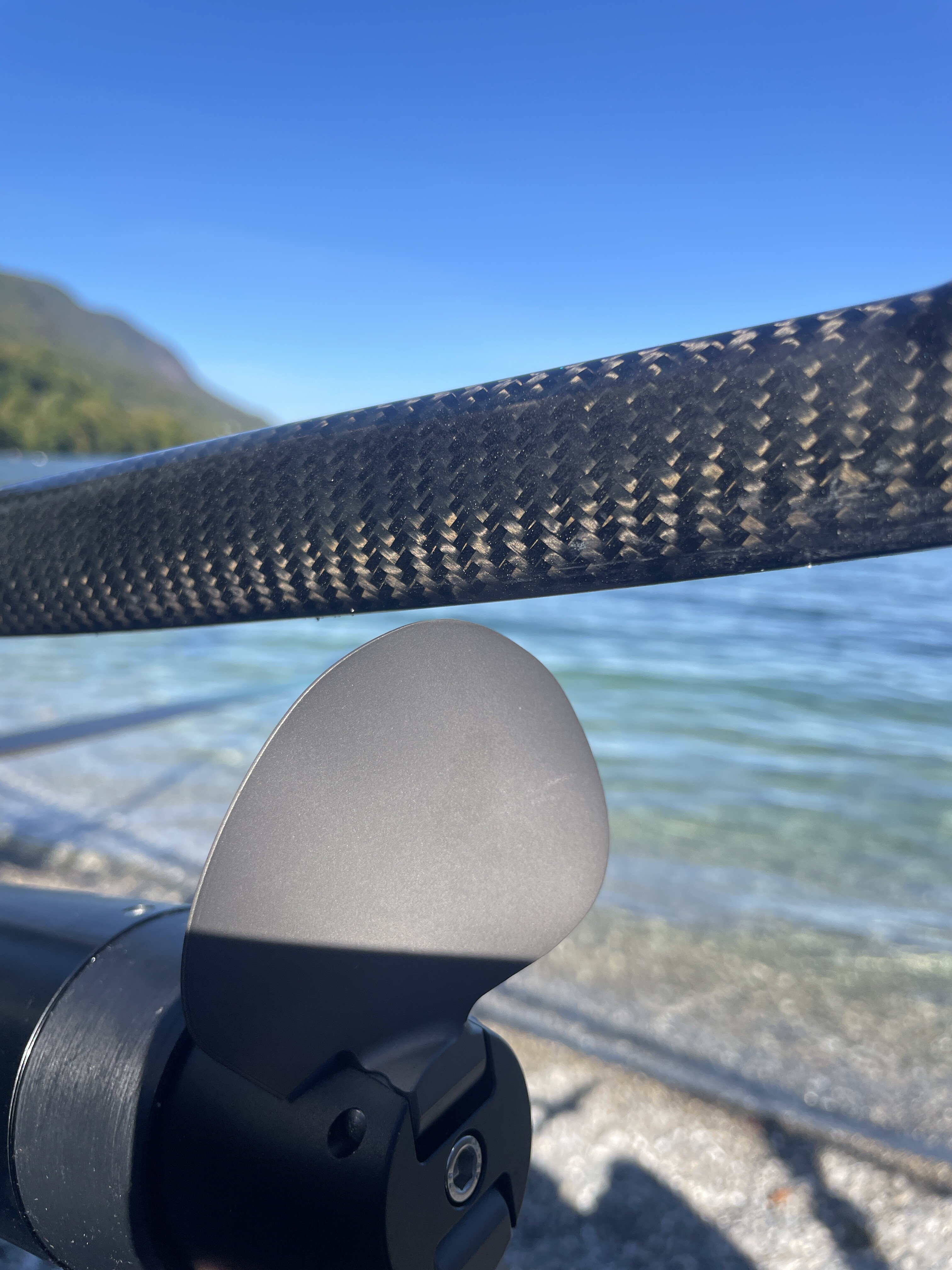

Well I’m going to start getting ready to mount my motor on my 70cm mast permanently in e-foil mode down near the fuselage. I wondering what are your spacing I’m looking at 10cm center to center above the fuselage for my current 2 prop setup. is there a minimum distance I should leave between the tip of the prop and the fuselage?
I’ll take some pics. also what off the shelf water proof connectors are you using to put the power cables through the box?
Cheers!
J
Minimum is if it does not touch with the biggest propeller you intend to use. Allow some mm between propeller edge in case of flex of the motor or fuselage.
With a 70cm mast you are already low, so don‘t waste too much hight.
I installed a bigger 2 blade folding prop with 1mm gap. It works but i‘d prefer a bigger gap, like 5-10mm.
Wow thanks for the quick reply. 1 mm WTF? WOW I would be afraid of it hitting or cavitation.
10mm seams close but I have no idea if I’ll be keeping this prop on this motor, as research is showing me I might be better off with the 3 bladed prop on the efoil vs e assist.
So I dont think the diameter of the props will vary much more than a cm or so so at the prop tip. So I was thinking of setting it up maybe with my wire holes at center of axel with a tip spacing of 25mm from fuselage. in which if I max out the space on the inside of my motor pod down towards the fuselage I could get to 2mm if I wanted too. Seems about right for max adjust down which is what I believe i need. with adjustment for other props in the future.
Thanks Sat_be I now have the confidence to start marking and drilling holes in my mast. maybe I’ll just mark it out today and drill it tomorrow. LOL
