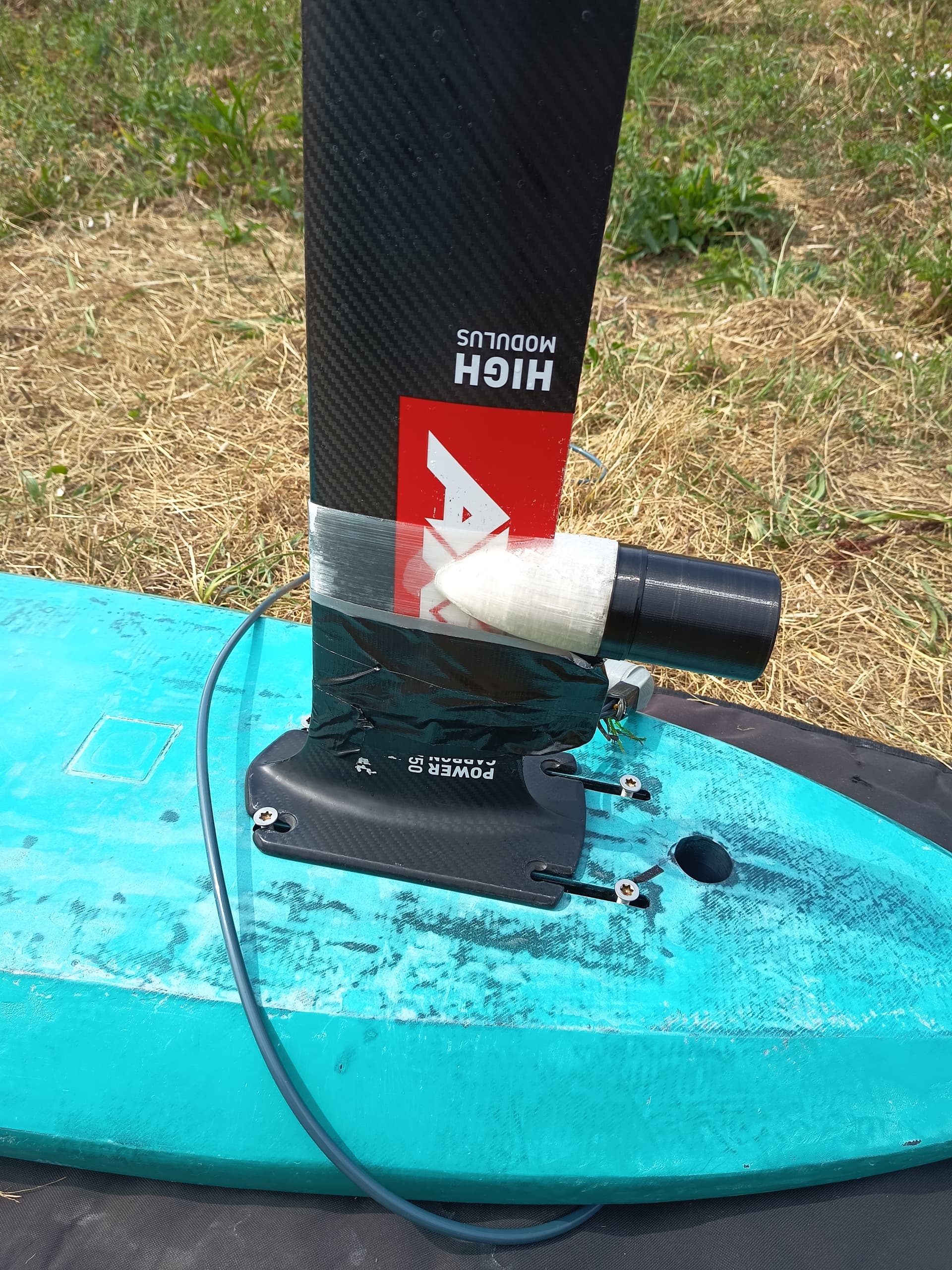

I keep destroying petg mounts. Of various designs (strap, zip tie, various connections). Love TPU for things that require similar loads. How are these holding up? Love the simplicity, but also love the idea of something nearly indestructible.
I made modifications to make it fit my Flipsky motor and Axis mast.
Works fine.
Do not think this will ever break and it is also the first mount that is not sliding for me.
Be prepared to go through some adjustments though, if you do not have the same mast/motor as the original.
Axis HM mast is a bit too thick in the back and the original was impossible (for me) to get the screws in due to the misaligned angle there.
Great design if it does fit your setup or you can make it fit.
Any hints to print clean overhangs in TPU?
Mine work, but look pretty ugly.
Got about 30 sessions on it now.
Just works great. No sliding at all.
Being TPU it’s going to be indestructible.
Initial mounting on the Axis mast was a bit of work.
But now no issues.
