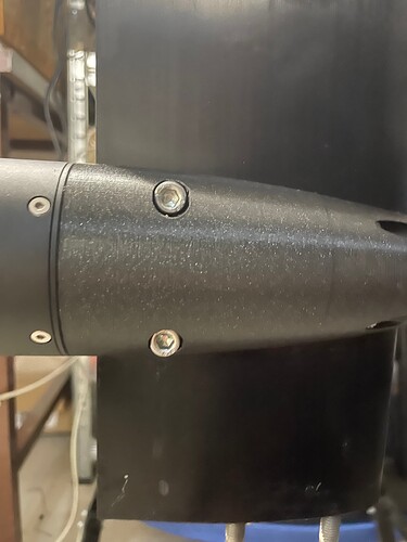

Motor slide down to fuselage.
The image shows a fixed state, However, the line where it was before is still visible. When the motor bracket loosened, the propeller hit the fuselage
But what is weird, When I hot fixed it. it didn’t have any significant impact.
