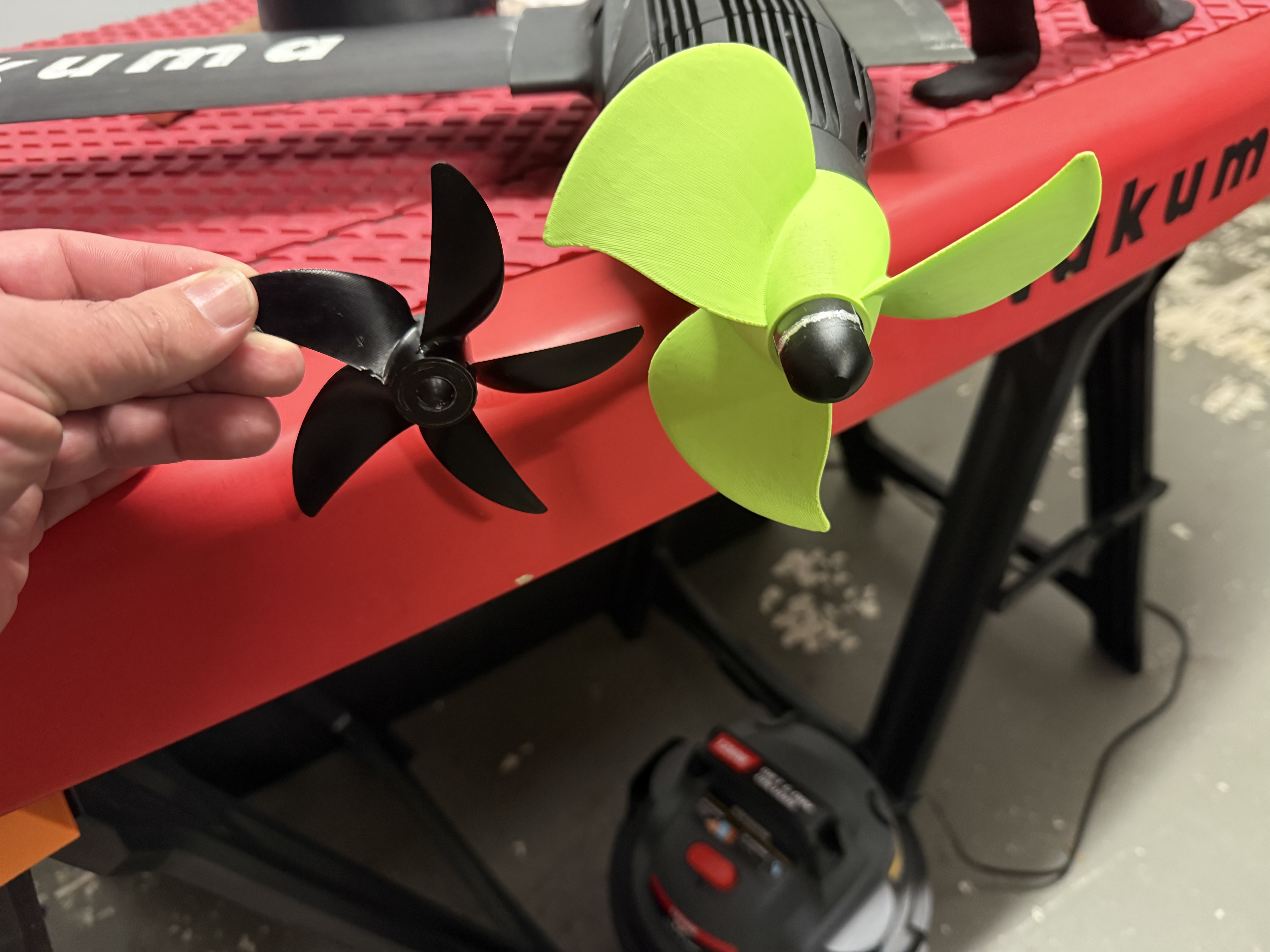

Still waiting on the flipsky fx3 to be delivered. I got bored waiting and reading the comments about poor thrust so I have been playing with some 3D printed props. These are just the PLA fitting tests, I will print in PET-CF for tests
