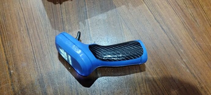

my name is Roberto from Italy. After more than one year of developing in electronic solution and software I have reached a good device of remote controller for my foil drive assist system.
Now I want to share my project to extend the work to others on the philosophy that the improvements never end. Collaborators and builders are welcome.
Features:
Ergonomic case in 4 parts by 3d printing diy
Display OLed 1.5 inch
Wireless communication at 2.4GHz and 433MHz (dual Band)
Firmware upgradable by server (WiFi)
Recording VESC data of last 10 ride in the internal memory of the receiver txt and json files
WiFi hot spot of the receiver to analize data and setting
Vibration alarm for battery low
Plastic bearings on trigger for precision control
Integrated battery 18650 2200mAh (10 hours)
Wireless charging system
Trigger’s spring interchangeable
Most important problem of a radio remote is to work in the water. I tryed to send the trigger data in parallel on two different frequency channels with different modules. The result is that the 433MHz helps but there are two different antennas to place.
The assembly of moduls is not very hard, at moment is not available a main PCB.
What is really important in the building is the coating and filling with epoxy resin of the entire body of the controller and the display in the top pannel to be waterproof
Regarding the receiver board I coating by resin it with the VESC in the box
link: www.foilassistproject.com GitHub - assiro/foil-assist-controller: Radi controller for foil assist system Remote Controller Foil Assist - Google Sheets
on the screen of the display you can read:
during the ride:
percentage of battery
Power consuption in watt
percentage of throttle
with small caracters in rotation:
average of power
total time of ride
motoring time in the ride
power index (index of rider performance)
After riding (no throttle pressed for 2 min.)
total time of ride
motoring time
battery voltage
power index
average of power
