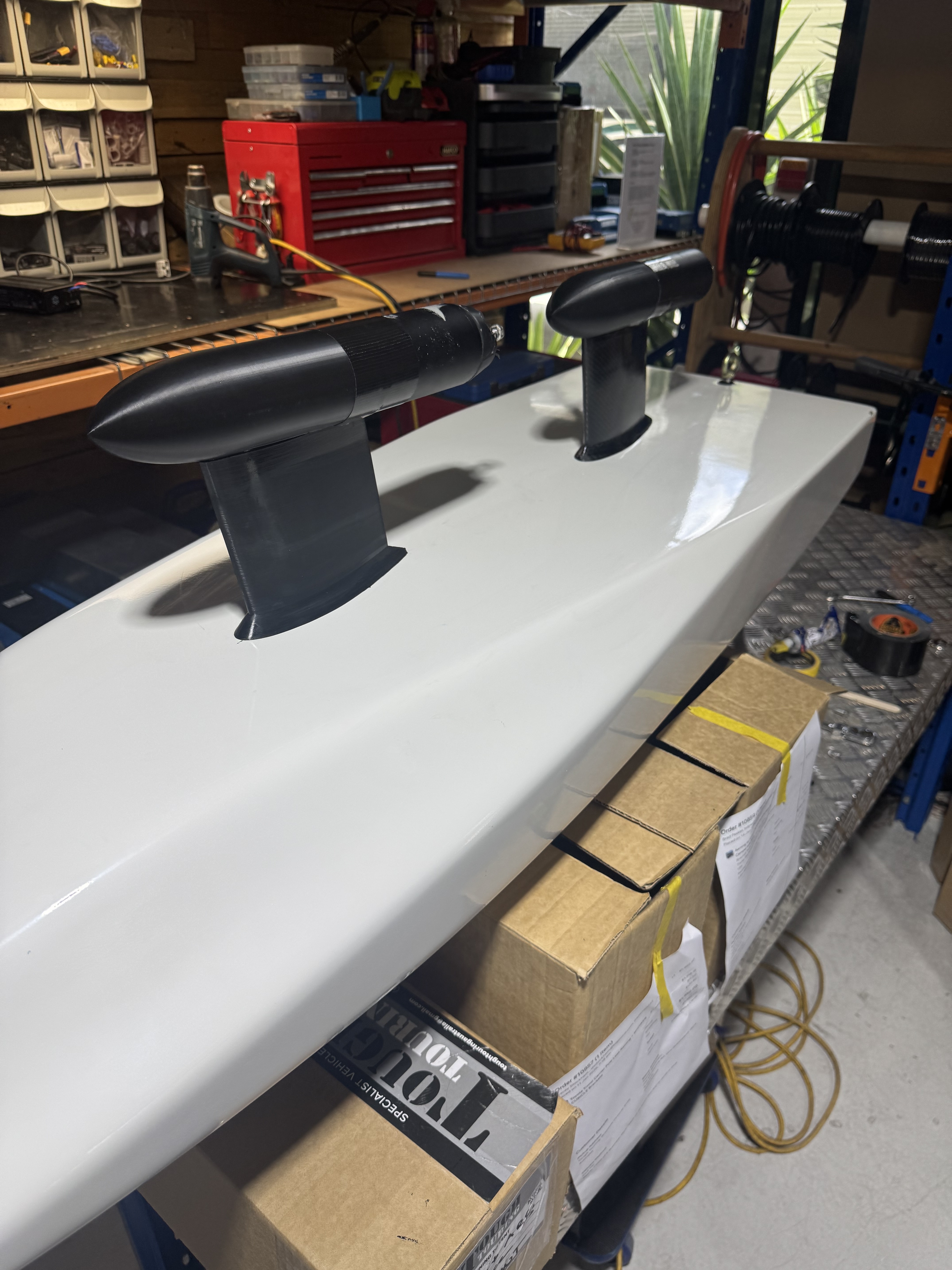

Motor Mounts completed and Twin 65150 Flipski Motors INstalled…

So far, Motor mounts for Single motor mounts are a consistent position at Exactly half way up the hull - all power trains tested from 3kw right up to 7Kw working great on this hull shape - Im liking the reliability / simplicity and low price point of the 65161 65162 (6kw Max 3kw Constant) for lighter riders and or foils over 1200 Sqcm, but IMO they are lacking juice for big riders or small foils…

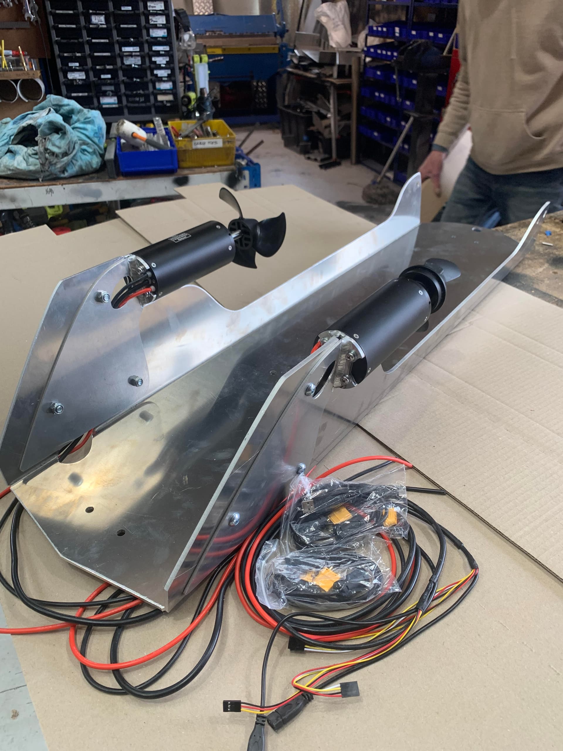

How much does this frame weigh without motors?

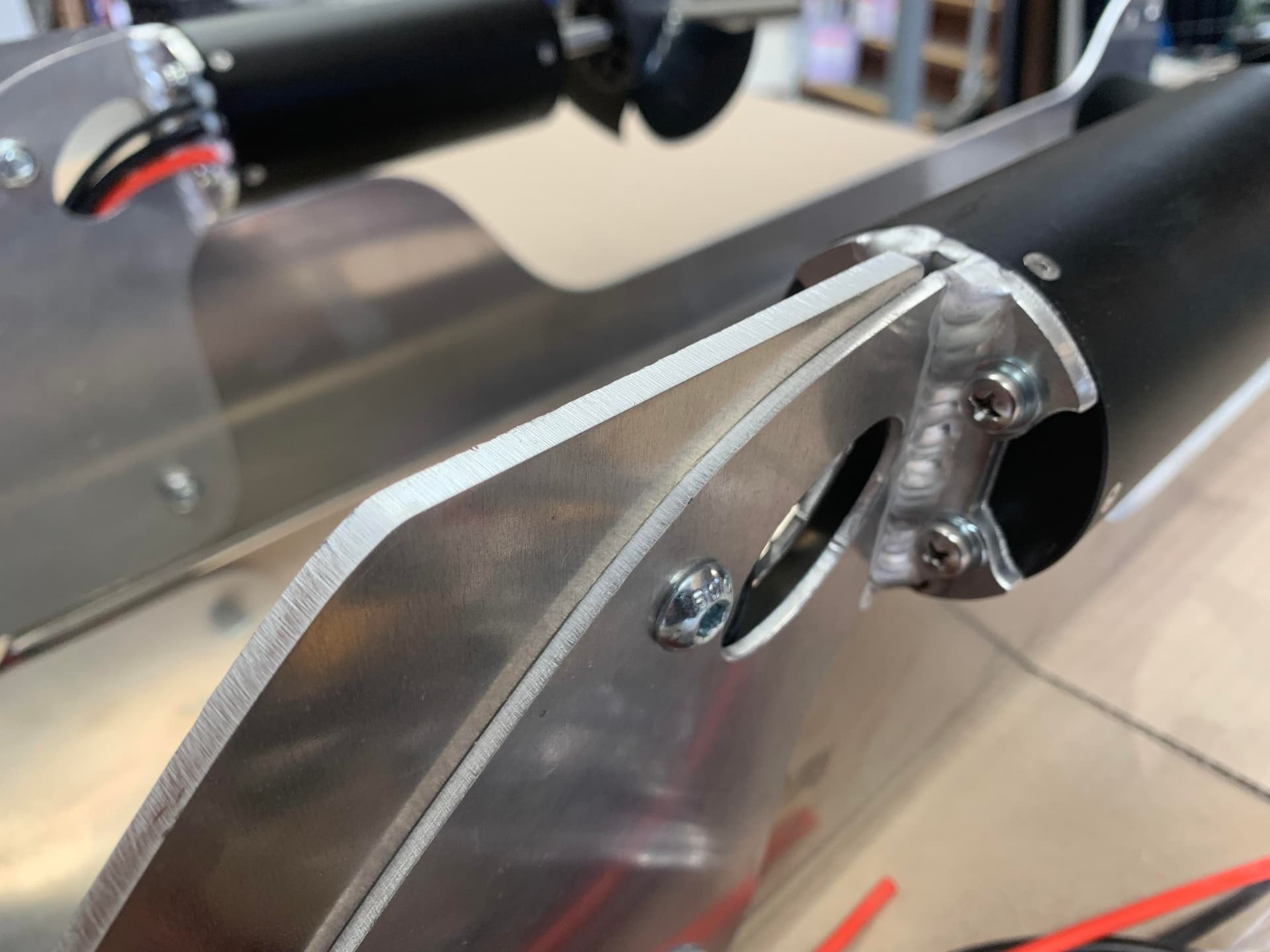

Hi Rttn, This Ally base was only built for a test rig, no longer using it as it was difficult to make curved ‘foils’ around the edges for anti-cavitation…
The updated one is about half as much ally and has straight up and down foil sections, with 3d Printed inserts making a nice foil shape…
The one in the picture was about 5kgs, the new frame about half that …

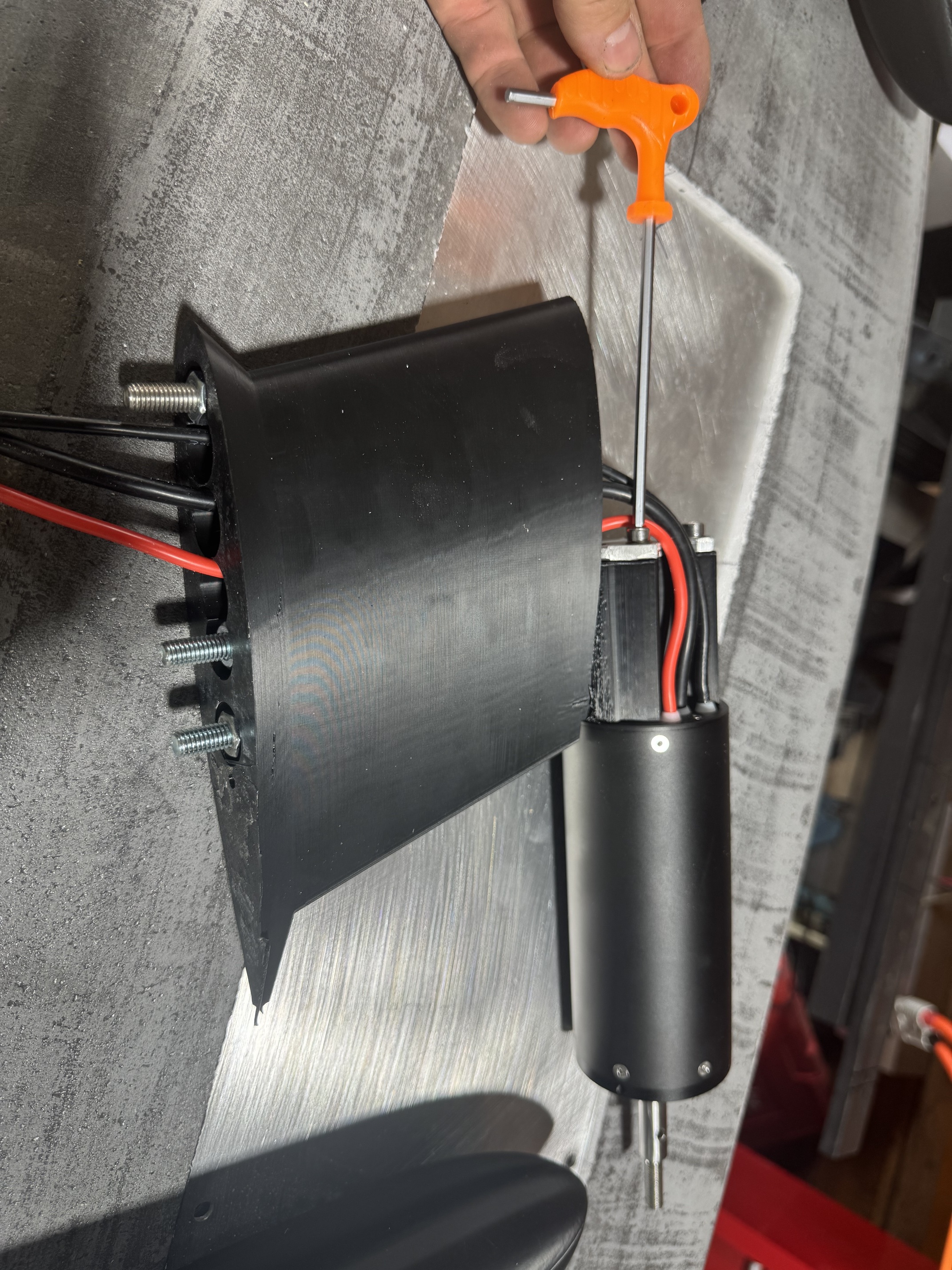

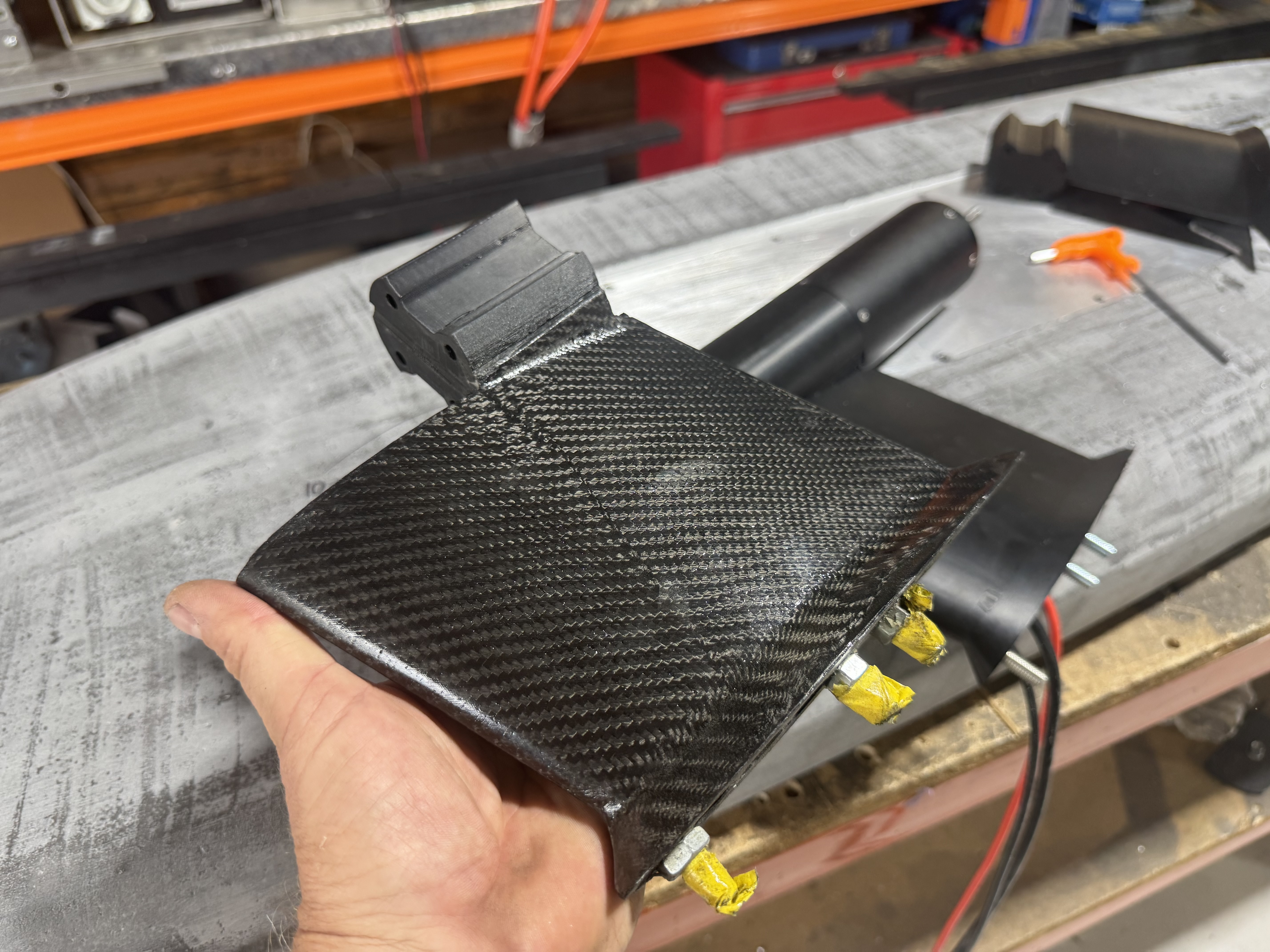

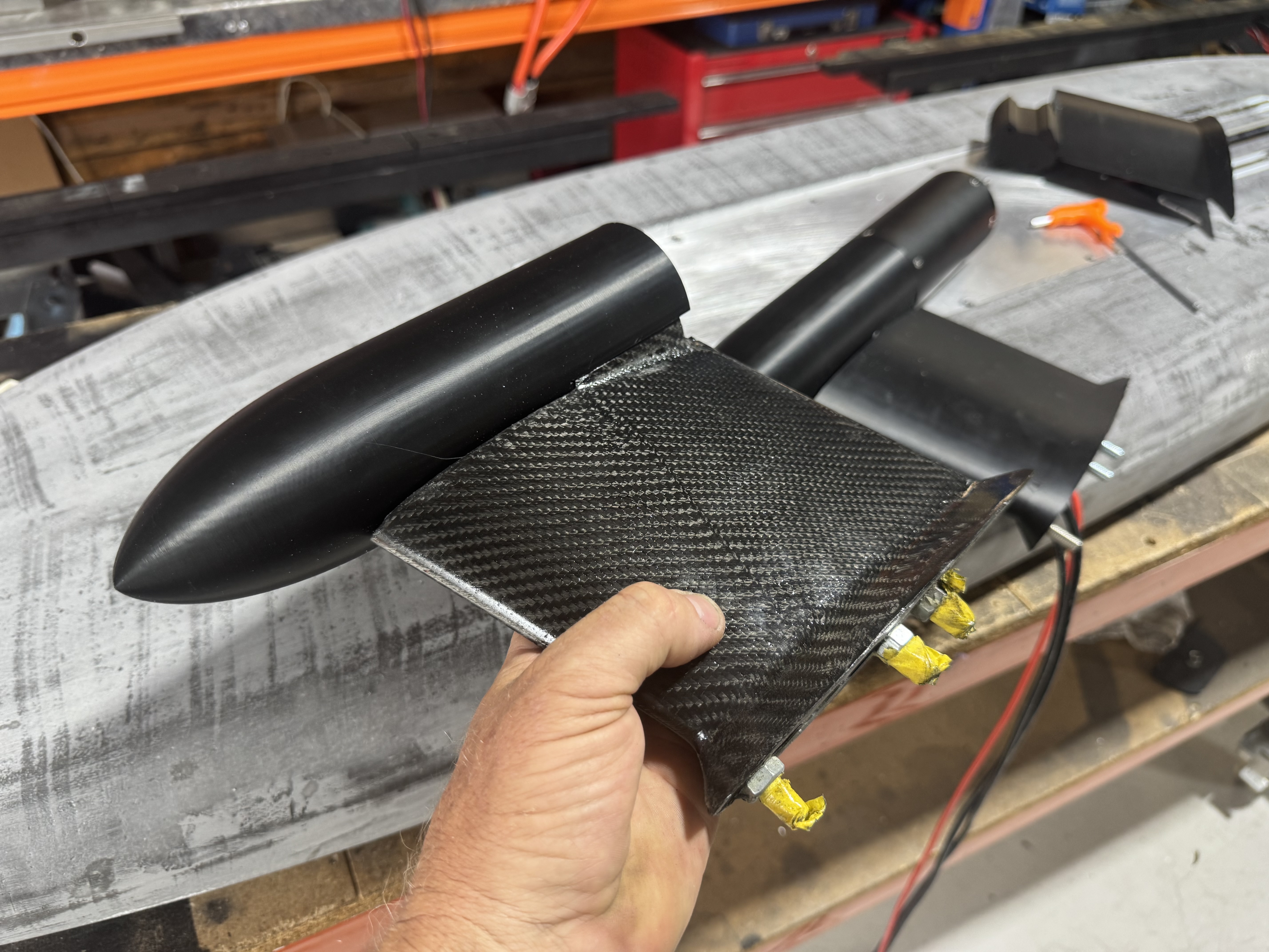

ive 3d printed my motor mounts and angled them slanted slightly forward to bleed off any bubbles / cavitation - works well with zero bubbles at the stern under full power. the little Aluminium tab at the front of the mount 'clamps ’ the motor to the 3 d print and ive got 3x m8 stainless steel bolts running through the structure (potted) to add strenght and a bolt through structural fixing… 4 weeks now of 2-3 hours sessions on the weekends without any signa of fatigue . im going to say these mounts are perfect…
ive had a few major impacts with thr boat ramp and cracked the nose cone twice - made a new one in T P U and it seems stronger with the flex…
