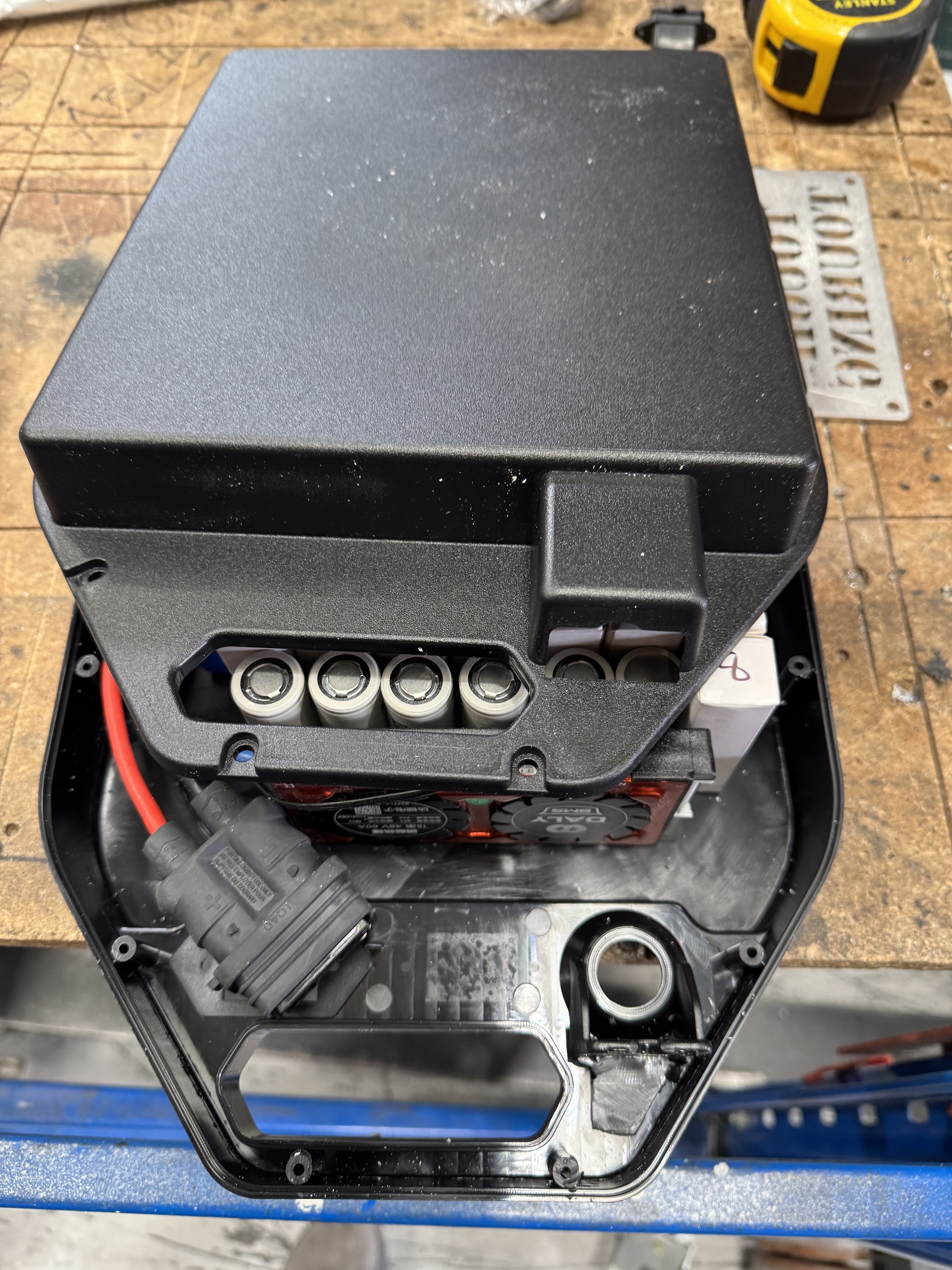

Weve gone and spent a lot of tine of batteries designed for etow - they have to be able to handle big outputs for a long time - one for up to 6000w motors (1 -1/2hour full noise) - So were using the expensive samsung s50 cells - and the case is a china import made to fit 14s6p… be doubled (2 batteries) to run up to 12,000 w (twin 6000w ) for wake tow or surfboards… or just to double the foiling range to 3 hours plus…
Ive got the first shipment due here in a month…
pricing to be finalised but around $1k gst inc per battery is what were aiming at…
the case and ports are ip67 with sb 50 anderson connection used for charging as well as output… it has insulating waterresistant rubber boot as per our shitty post production pics attached below…

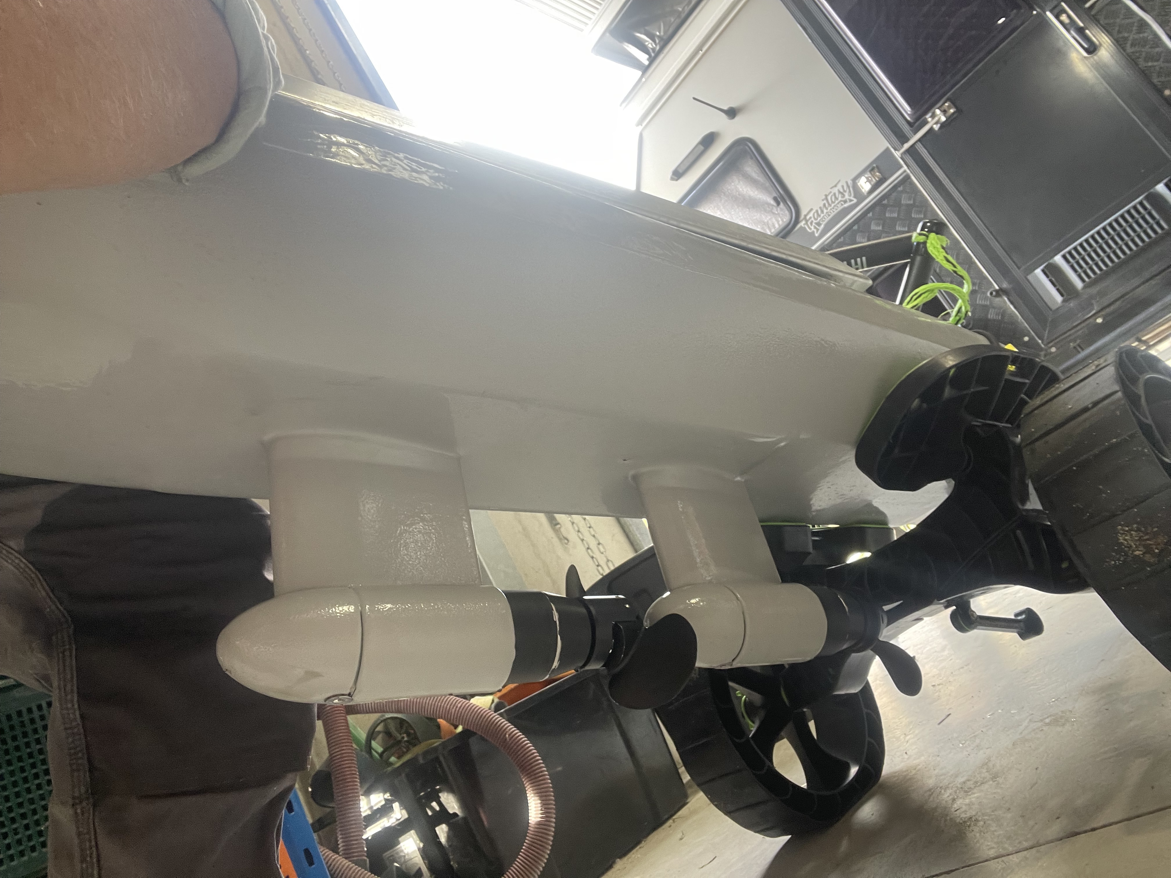

I assume you are aiming for steering via a rudder, as that photo looks like it has two fixed inline motor pods?
yeah ive got two variations built and operational - one is single 6000w motor and about to have rudder steering…
The other is the ‘aligned’ twin motor version - shown in the picture…
the ‘inline motor version’ there is amazing though headwind chop - and has great take off torque - it runs twin 3000w motors - and opposing props…
i could add servo rudder steering to it - I did test rudders at full 45degree left and right to see how it went
The issue of course with twin ‘aligned’ props was that rudder steering starts to get pretty ineffective - its got like a 25- 50m turning circle!!!-
very happy with that model for a good year or so its been u real - I see it now as the stepping stone that really nailed the hull shape design that handles 20kmp+ into heavy chop…
the twin props really ‘pull’ the hull through chop with one prop semmingly always in the water as chop is crested you dont get the power surging issues or the jumping around ive experienced with other etow ive tried…
I love it on foil - its lack of steering has never really been something i needed personally - Until i started surfing Sanur in bali and saw that without the steering id have had like 2km paddles back…
The differential motor ateering on side by side prop set ups look to be capable of really sharp turning if required - u real for picking up students while coaching and facing them in the right direction at low speed…so thats my next build …
imnsure it will have its issues too - but Ive got through most of the big hurdles on the first 5 operational etow… im up to like version 48 now :slight_smile:

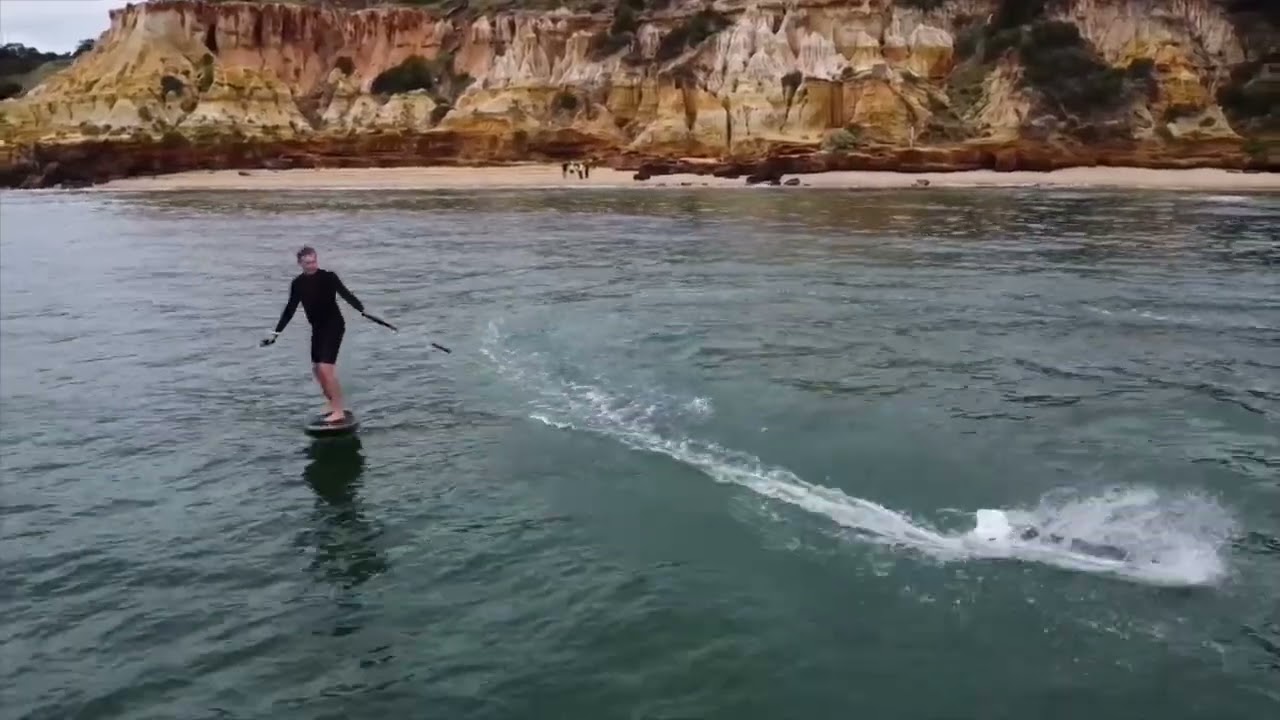

There is some more video of the ‘Tow Bogan’ in chop here on youtube here
https://youtu.be/nzSPHpzYOo0
  • This was filmed into about a 12- 15knot headwind in port phillip bay, Melbourne, Guys were kiting (just enough wind), Video makes everything look small, but the Chop was about 30cm high at times, (15cm above level and 15cm below)… Quite short and sharp/Steep too which is typical of our bay conditions . Im really happy with the chop performance of this hull design - its basically the same as an ocean race boat :slight_smile: If only I’d looked at that shape first it would have saved a lot of tests…

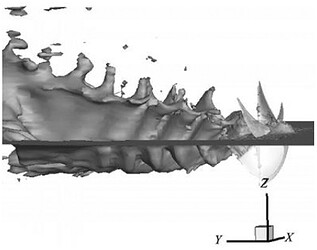

Because you are down the offshore boat rabbit hole, I wondered if you considered surface piercing props? lots of interesting benefits, and drawbacks. Most of all I would hope it would handle re-engaging the props better after ramping a wave
Surface Piercing props ! Now they would be perfect. Where do you get such a thing and are they available in Mirrored rotation?

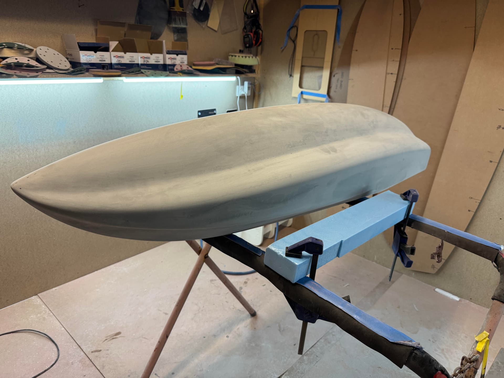

Ok - Couple more pictures of the Tow Bogan build… Lot of work on ‘Self righting’ after a bunch of great surf sessions on the v1, its time to build a mould and get it to roll back over after clean up sets. These Pics are the 'Plug - Im going for a full solid hollow Fibreglass hull with pre inserted 316 stainless bolt up mounts, Draining or ballast bung - Sealed independent battery cavity - the lot. Something you can adapt to the various motors and motor mounts out there.

For a surface piercing, I think there is probably a lot of experimentation to get it anywhere, possibly running oversized props for more bite, as I think they main issue with them will be lack of low end

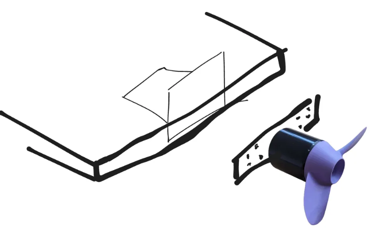

Here is my sketch for boogie that I plan to try.

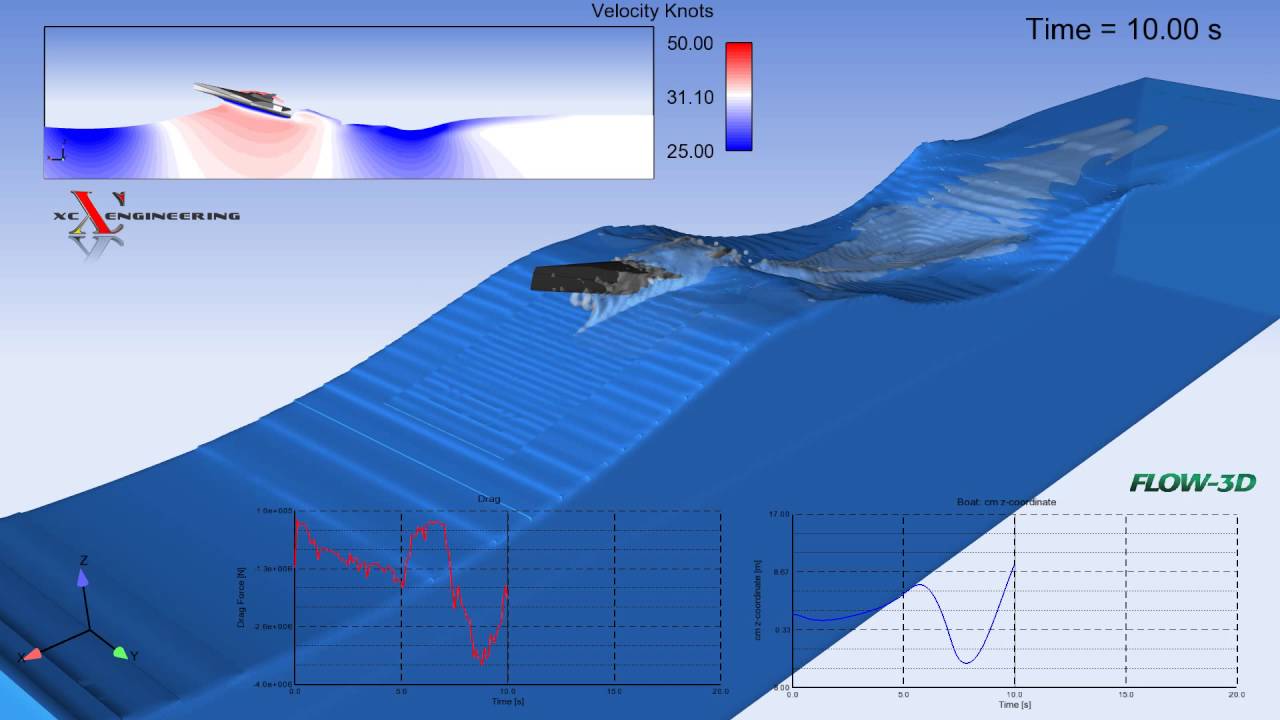

Wave piercing: I think this is possibly a good direction. If it goes through waves, you have less cavitation to worry about!
Self righting: I wonder if you might try a flood chamber, will cause it to self-right more quickly, and you can simplify the design / make it sleeker to punch through waves
Surface piercing props are notoriously bad for tow boats as they lose the extra bite from the prop. They excellent for racing boats though.
The issue with this is the resistance will force you to stall the foil. The size of the tow setup means its far to light to pierce through a wave or chop while towing.
I think both of those issues are likely overcome initially by rider skill initially and tinkering eventually.
I use only 60% of throttle on single 6384 12S on a prone board to get going, and with dual motors I could imagine doing away with the bite, key is minimal drag when you first hit the throttle. If you treat it like a tug boat off the mark then yes the surface props will certainly not work.

The mould development is still ongoing, getting the plug perfect over the last few days - Battery integration, service access etc is all on the go… but yes - the plan is to release our hull and motor mounts as D.I.Y parts for etow builders around the world…

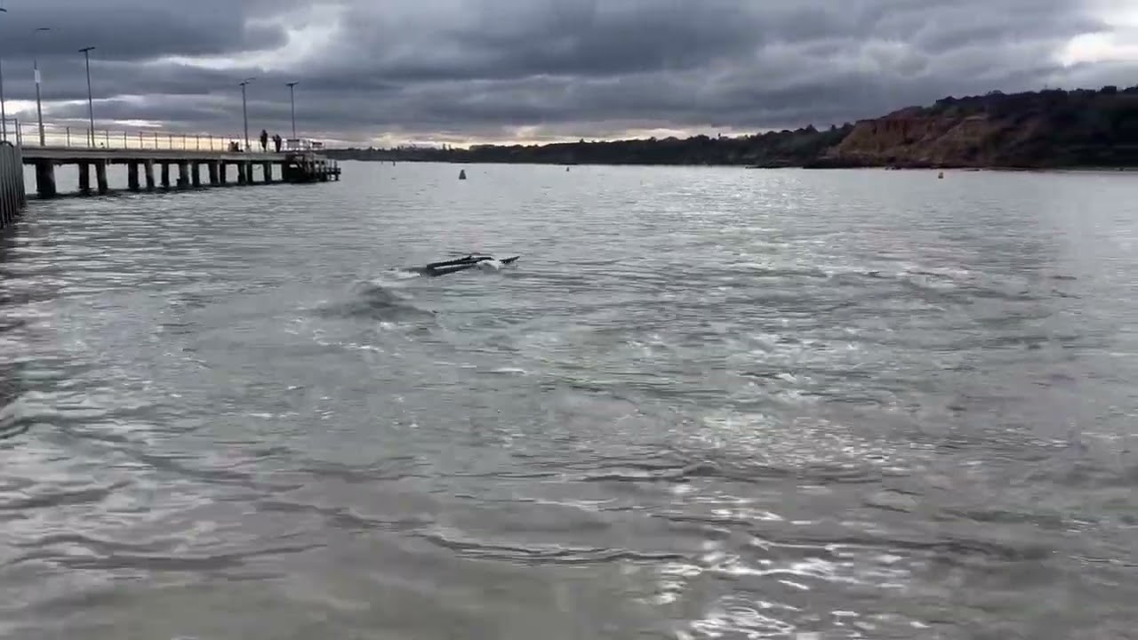

Little Video filmed by a fisherman while I was testing it today. It was only 10 Degrees in the water so I rode my parawing board so I didn’t get wet :slight_smile: The twin motors had so much torque they would have pulled me up on a toothpick …
SO POWERED and SOOOO stable. The Whip torque was insane.

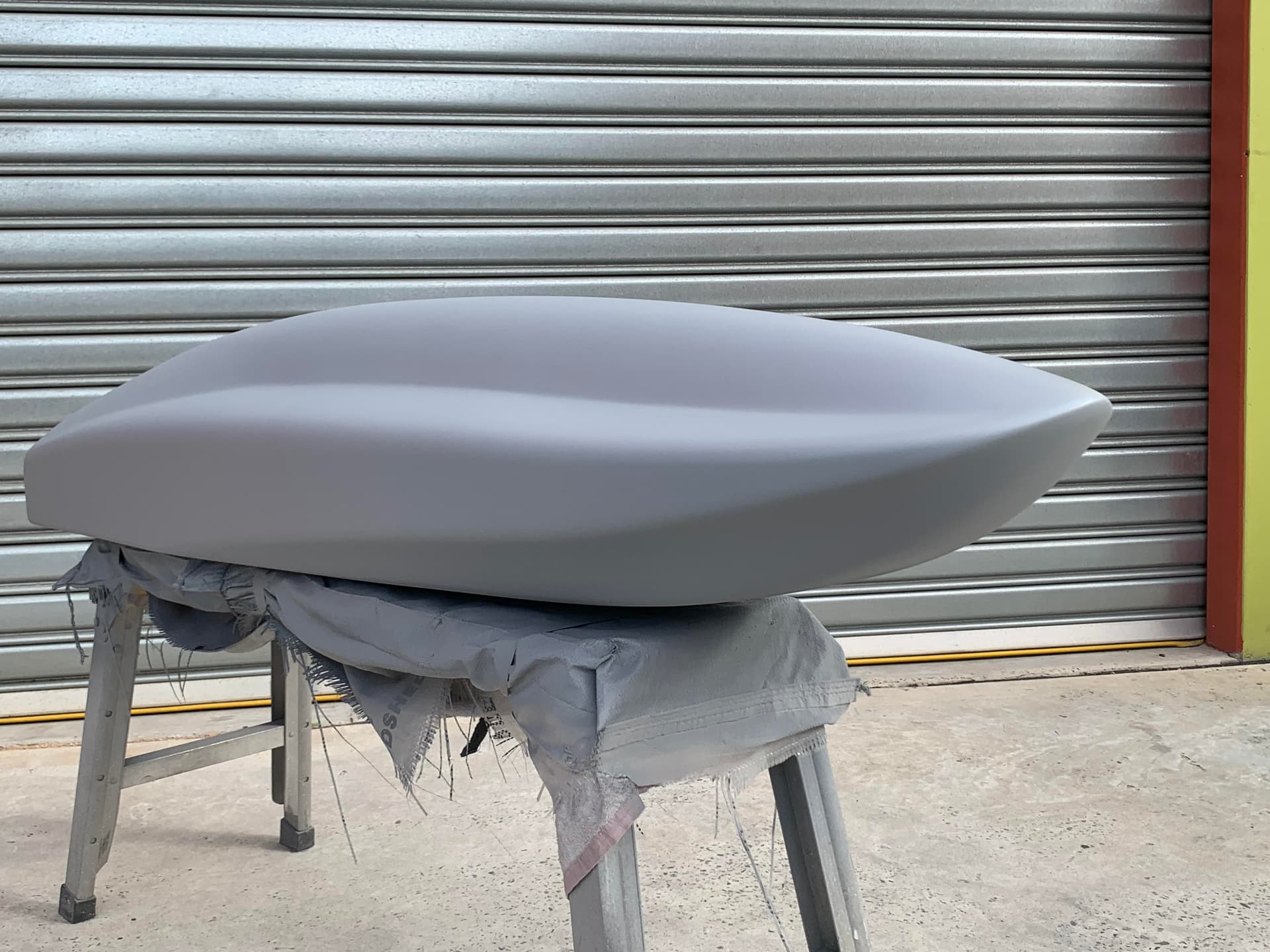

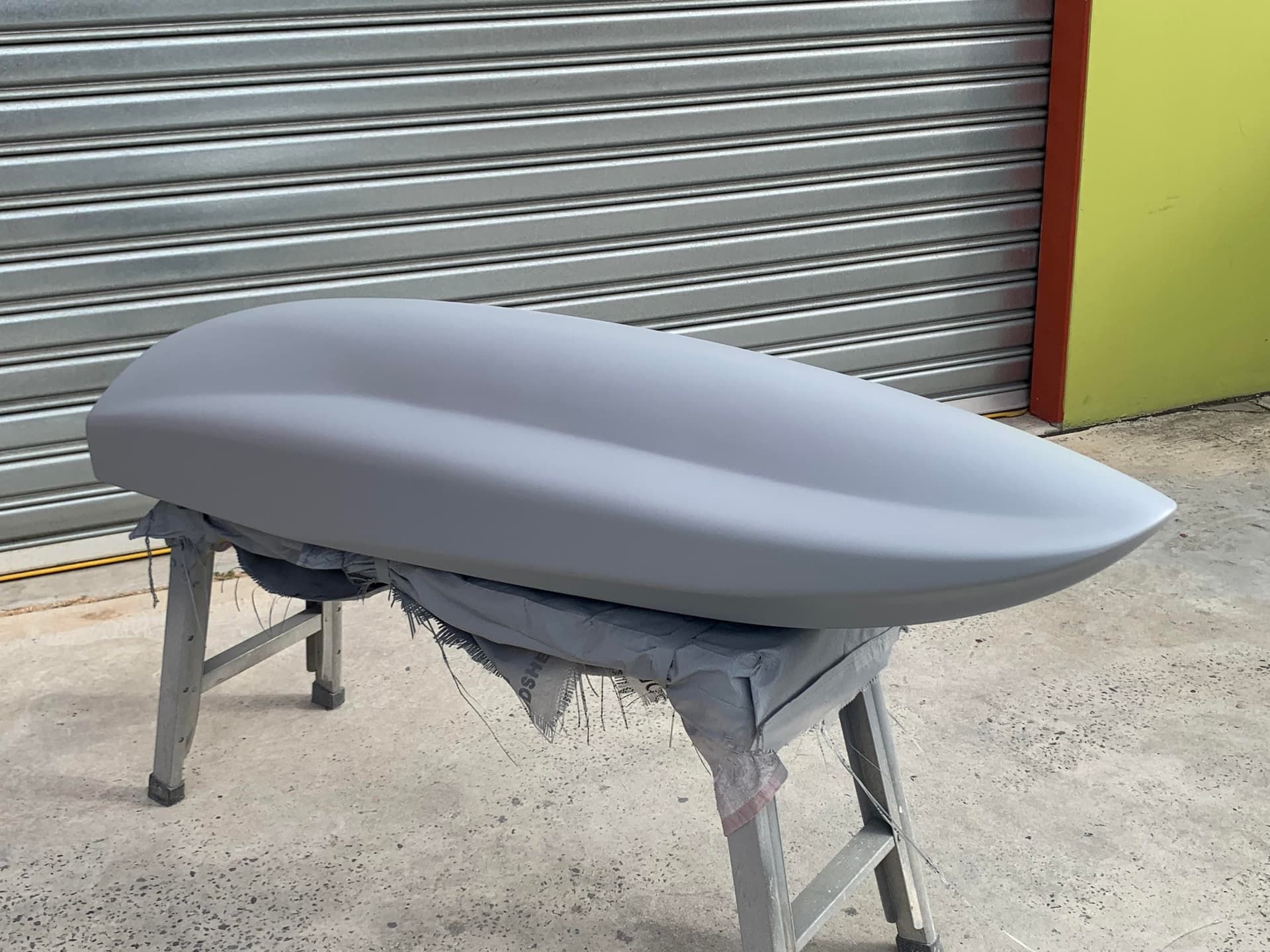

The Mould Plug Is finally finished, ready for actuall mould build… Its taken many many layers of Bog, Filler and sanding to get perfect… The hard work how makes a perfect female mould… So Its been painstaking slow progress with out winter making drying times quite lengthy.
