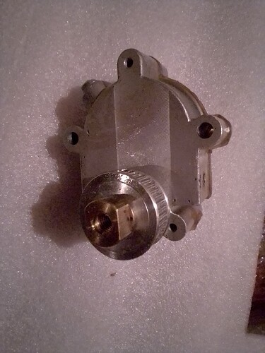

I saw that Pacificmeister was experimenting with belt drive. So, my gearbox can have unnecessary parts removed from the body, and then its dimensions will differ little from a belt drive. ou just need to think about the connection to the motor. Plus it only costs about $20. Here’s the gearbox I mentioned earlier that worked on my e-surfboard along with the belt drive. This is the same gearbox, but part of the housing has been removed, and look: it is much smaller.
I used a SSS 56104 motor for my efoil, like many here. and how can Robert’s development serve me? I doubt that at such speeds as the 500 kV motor produces, the plastic gears will last a long time. Its bearings cost much more than my gearbox :wink:. I don’t encourage everyone to use it, but it helped me a lot to build the first prototype.
