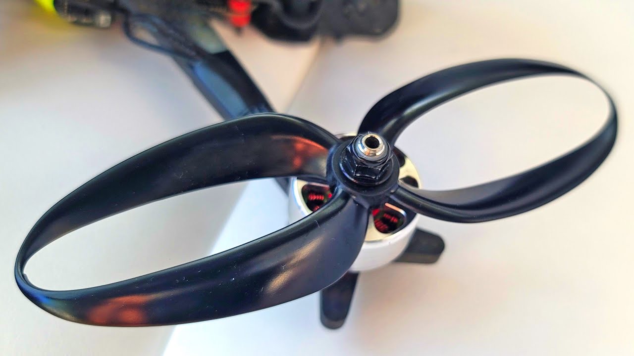

Here are the April 2023 advances made by the drone community: the donut shape - strong, cheap but a bit small.
Cutting both extremities of the donut is promising as it reduces the round tips whose net gain isn’t finally proven. It transforms a dual loop propeller into a four bladed one…
