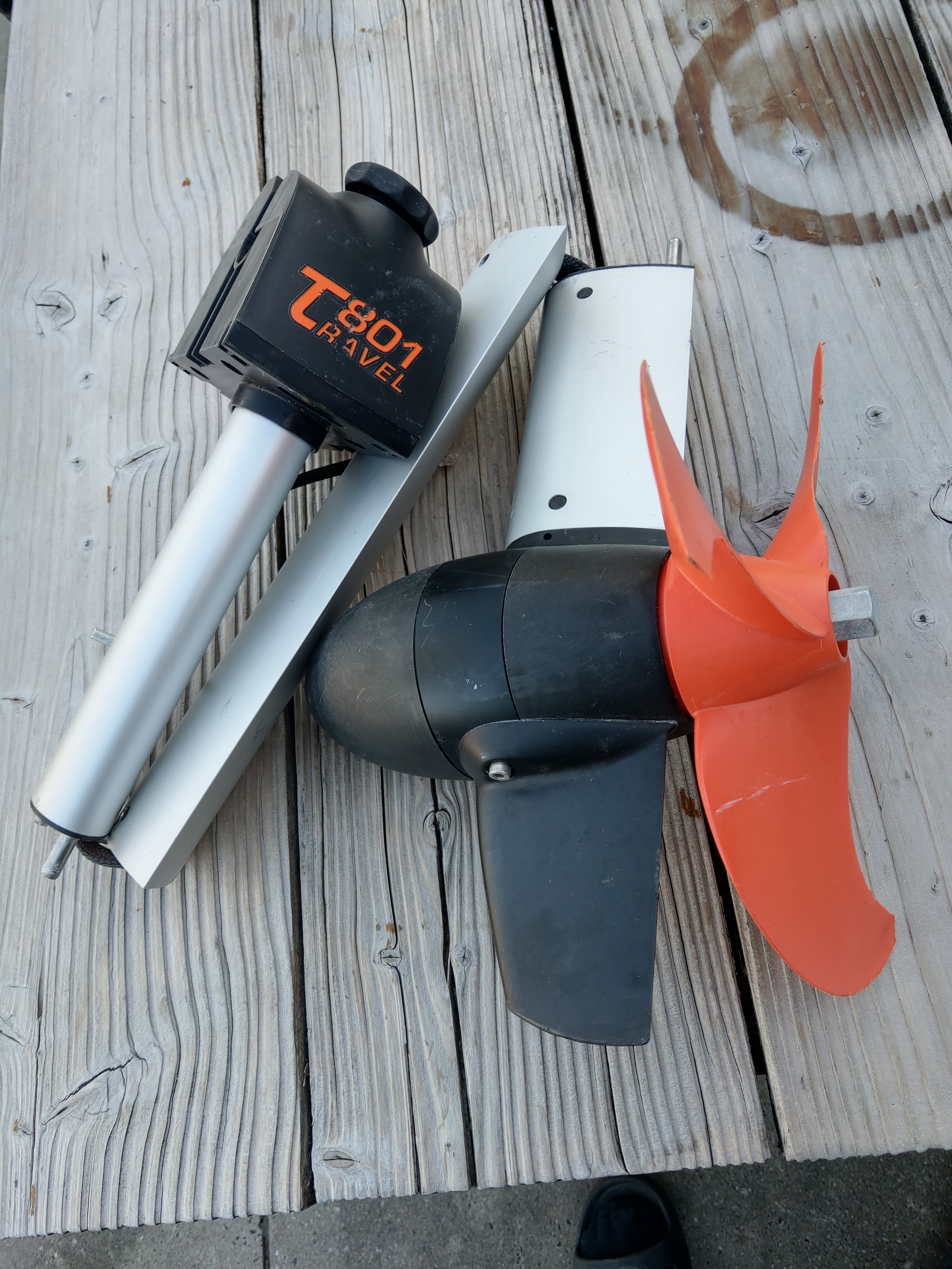

Guys. My dad remembered that he still had an old Torqeedo 801 travel.
He gave it to me to play with :slight_smile:

Do you guys think that the motor (and maybe even the shaft) are usable for a foiling board?
Not my video, but this is it in action.
At the end the end you see the person using it on a small boat.
Worth the shot with a gong xl wing and change the propeller to the 2 blades one
It will be slow , but I think you can fly , if it works , you will want more speed so another build ( money and time ) so have this in mind

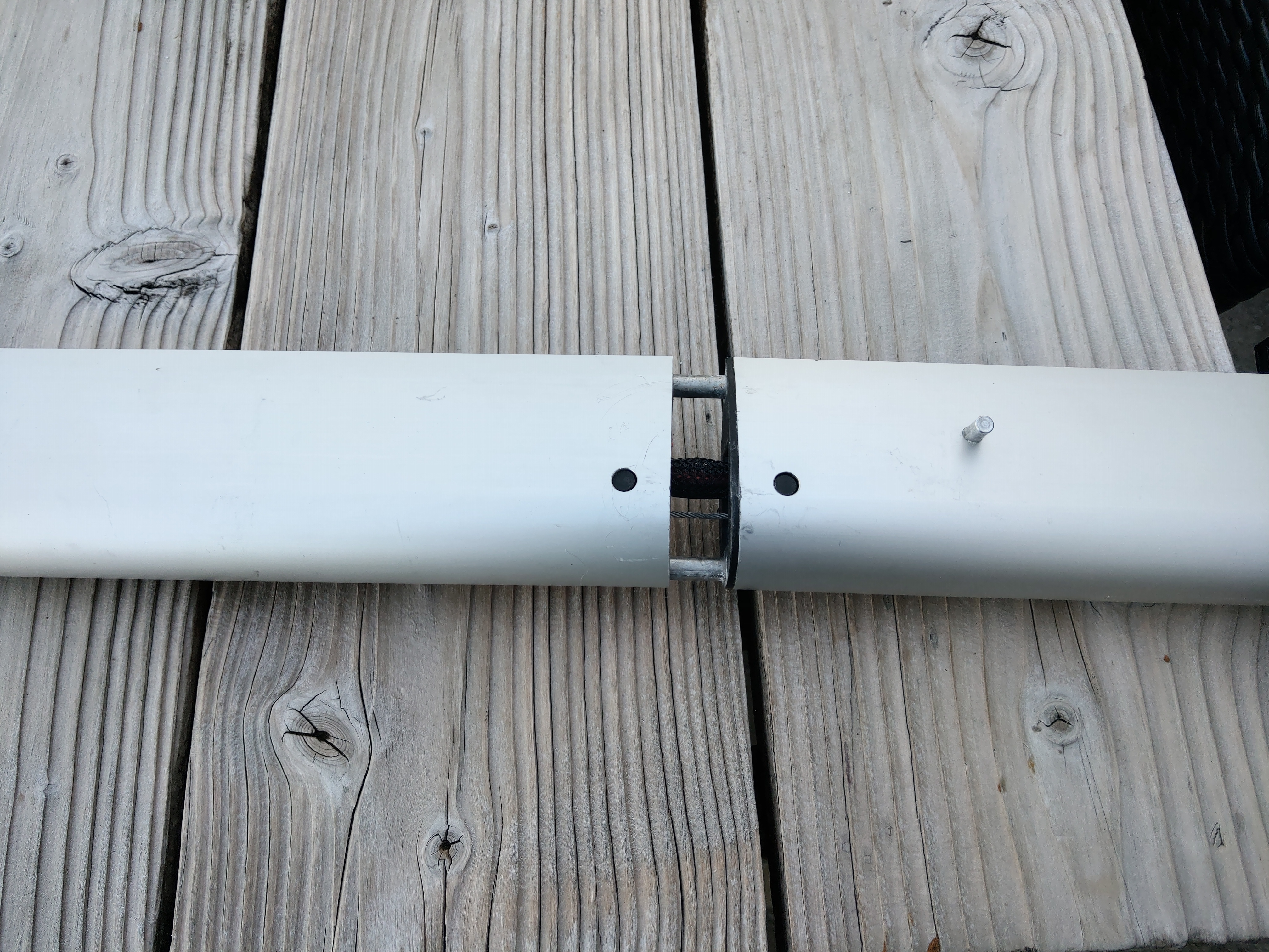

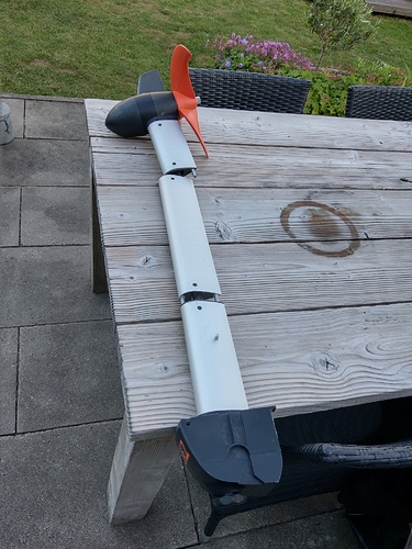

I am going to take things apart tomorrow, and have a look what is inside, and usable.

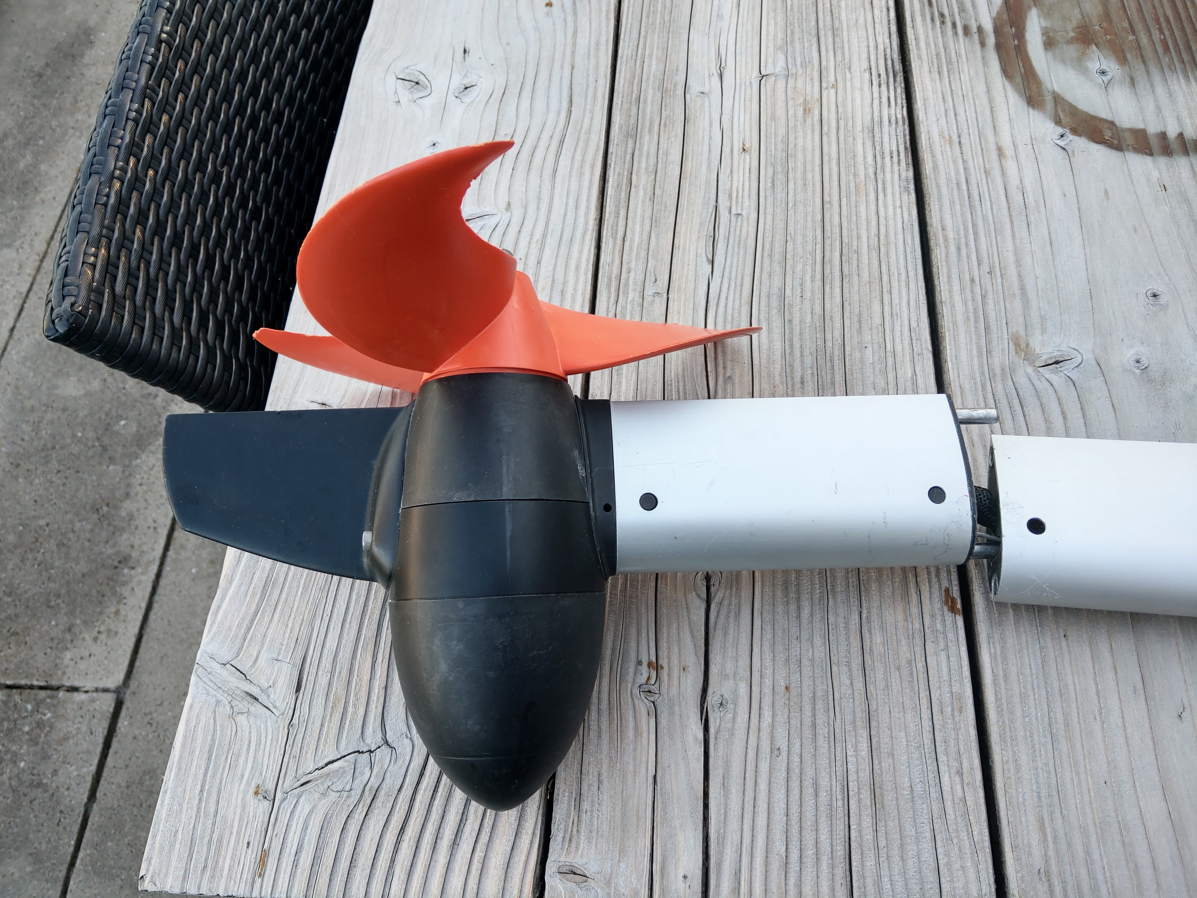

Currently, I’m trying to open the motor enclosure and I’m stuck at the nose cone.
Any ideas on how to open it?
No. We gave up on this idea as the motor is not powerful enough to get up on foil.
