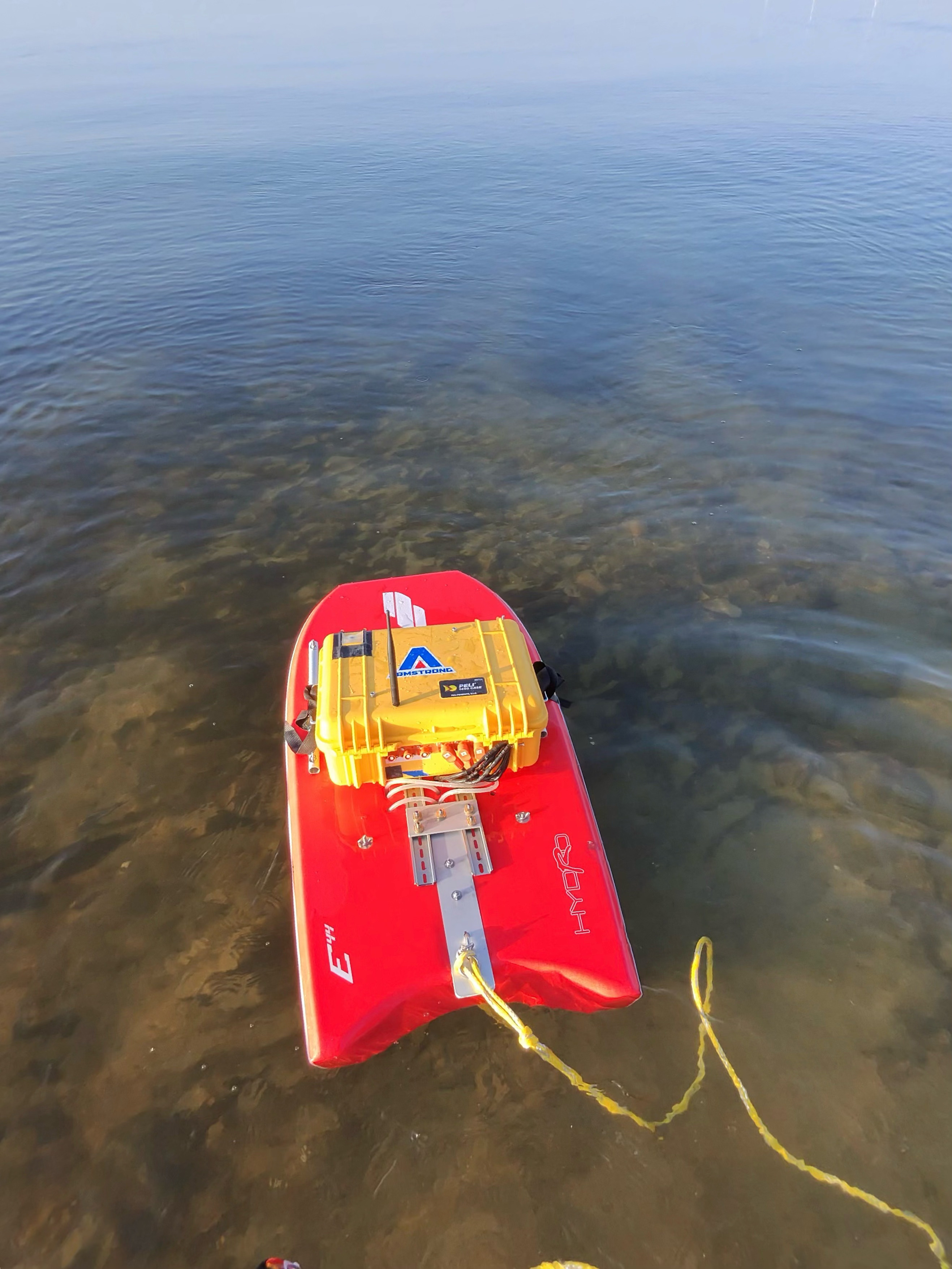

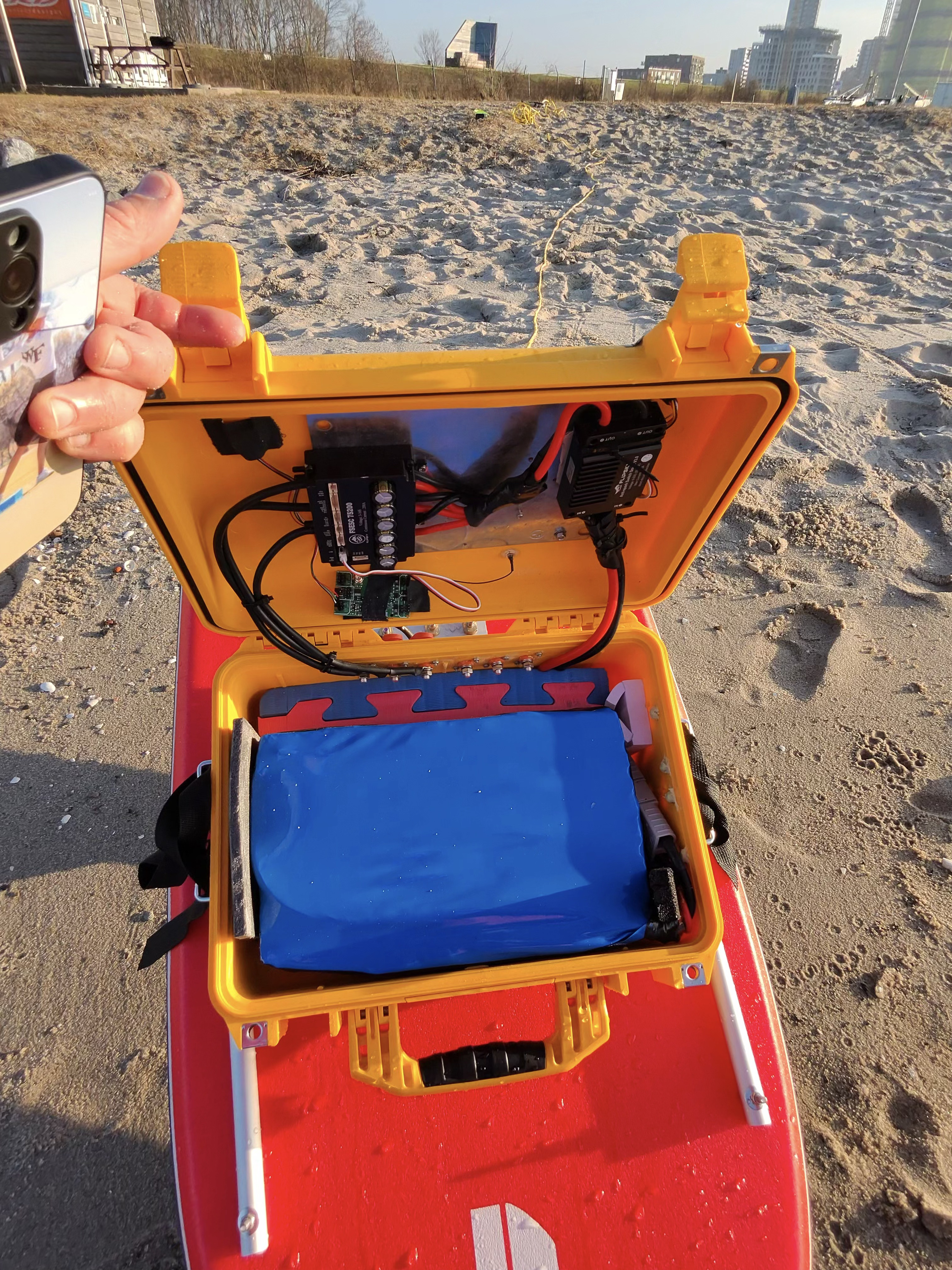

After more than two months building the tow-boogie with bremote v2 is finished.
Lots of power, enough to get onto foil. The only thing that I need to fix is a bit of torq-steer. It leans to the left once more throttle is applied. What can I do to fix this?

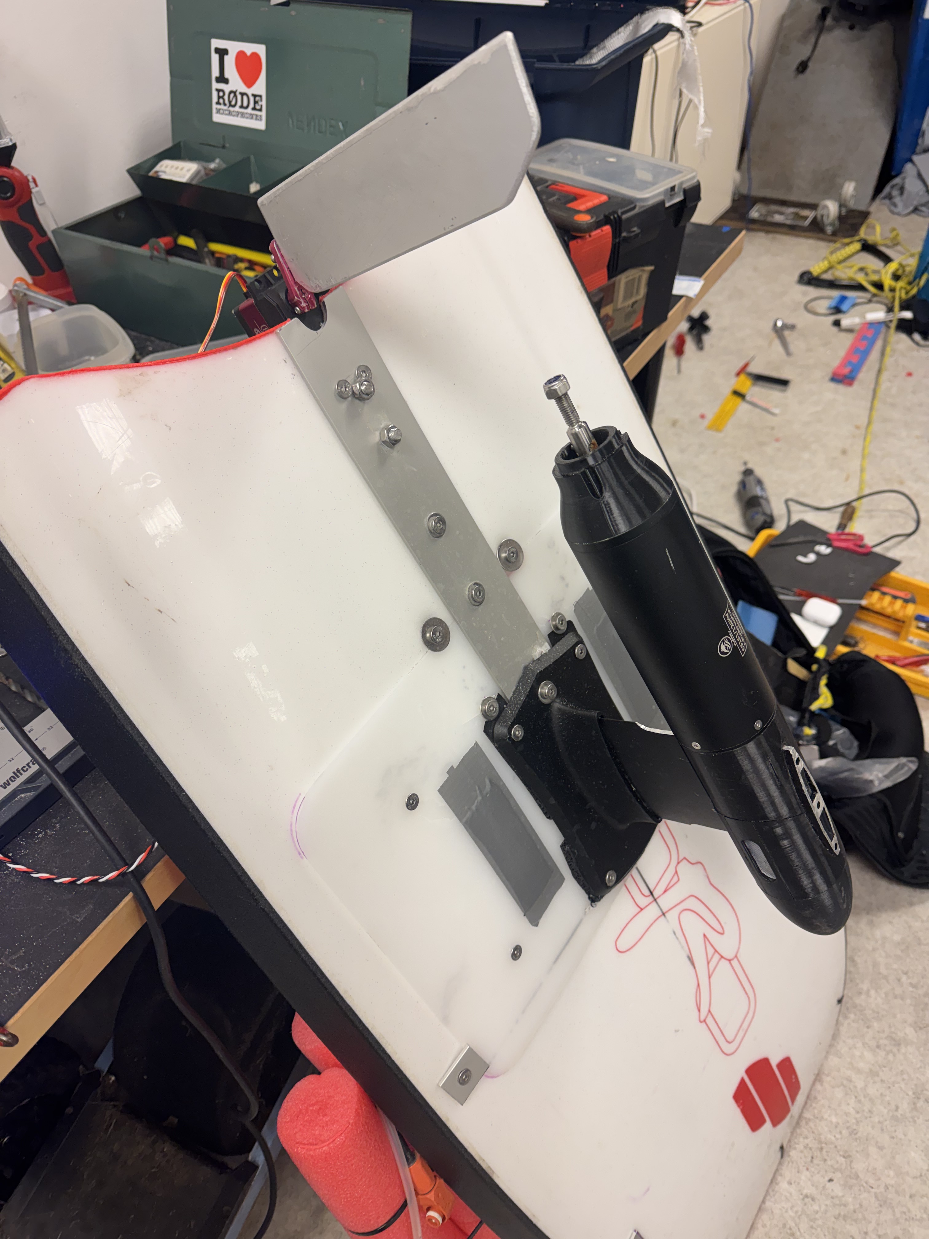

Well then I would just slightly rotate the motor or stick some fin into the water
I have some fins. Vertically or at an angle. What do you think
For me that would be trying the ones you have until it works :smiley:

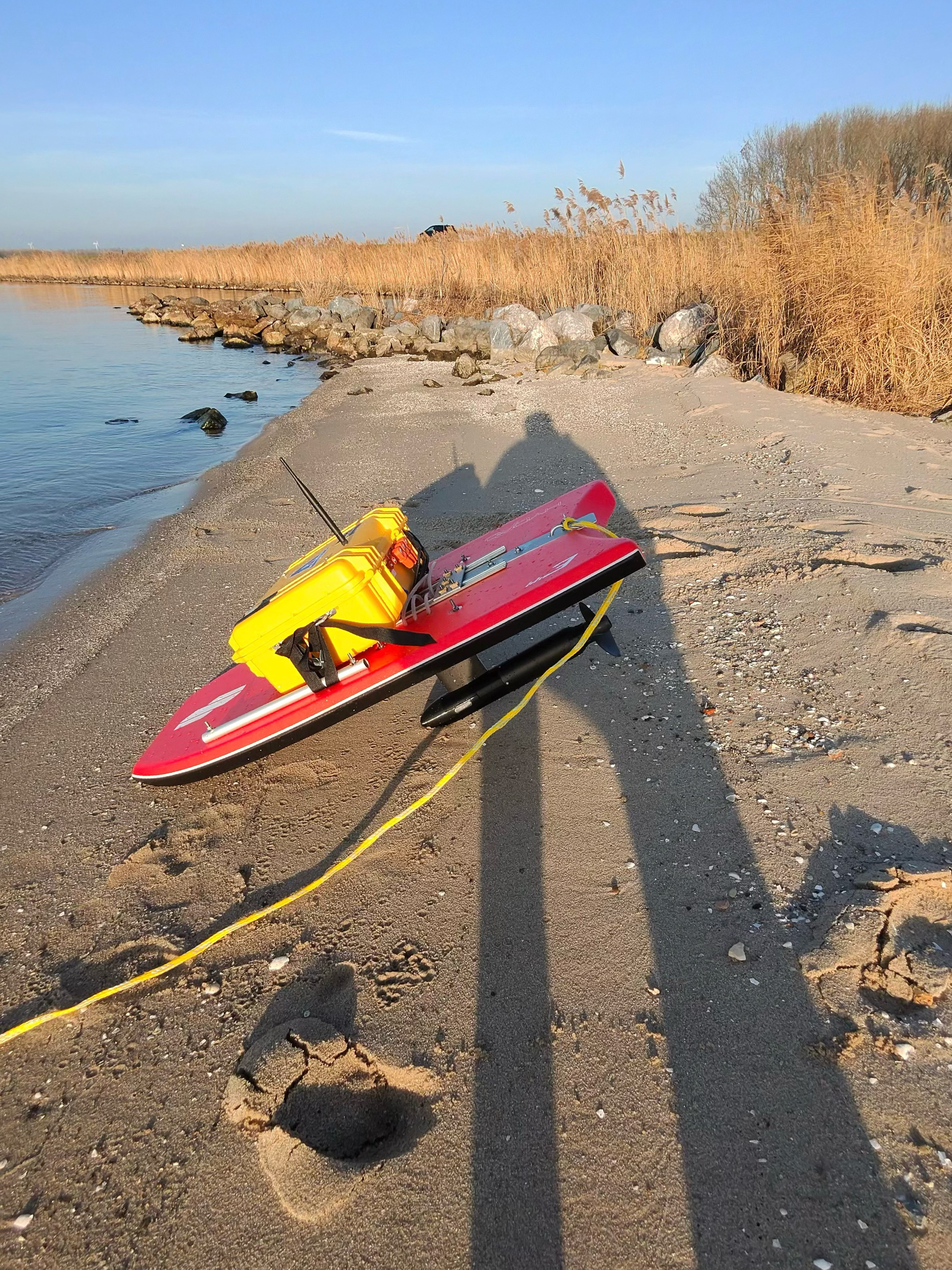

I have a 2x 6384 setup. Only problem is nose up, i need an extralong rope atachment stick

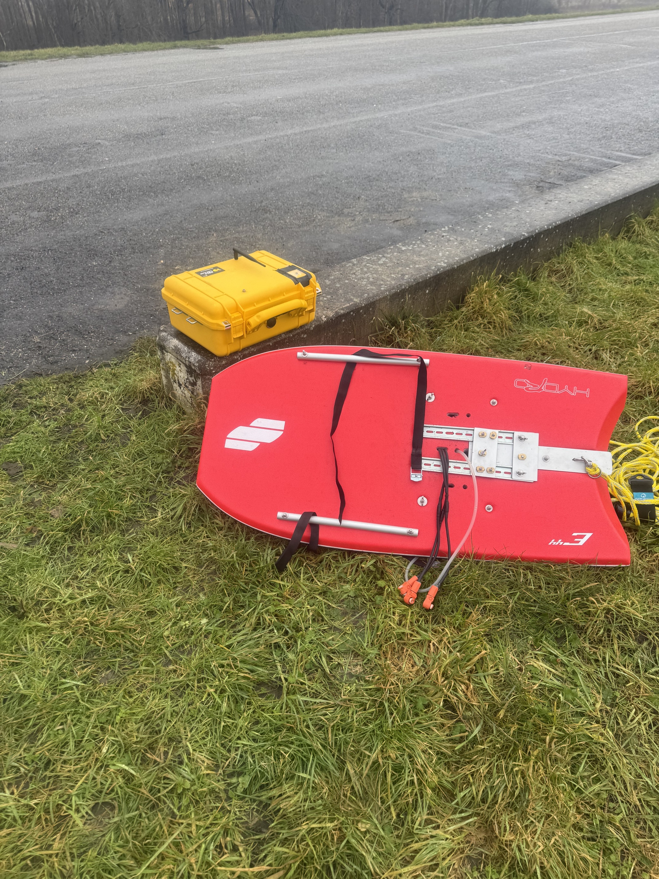

I moved the Pelican case to the right side and put the motorpod a bit higher. The result is less torq-steer and more control even in small waves. Enough power to get on foil with a midlength and 1350 APF foil.
I want to use a rudder to steer the tow boogie. Was thinking of a waterproof servo with a direct attached rudder. Anyone examples? Need some advice.
@ludwig_bre Hello Ludwig, I have added a rudder to my tow boogie. A digital servo will steer it. To test if this will work with the remote, I made a setup with a micro servo connected to the receiver board. I uploader the latest firmware to the Tx and Rx and configured it all for a VESC with servo. When I test it connected to the USB port the servo will not move at all. The serial terminal software shows that the transmitter is sending a throttle and steering signal. Because it is a micro servo it think that it should work without BEC or external battery. Or am I thinking wrong?

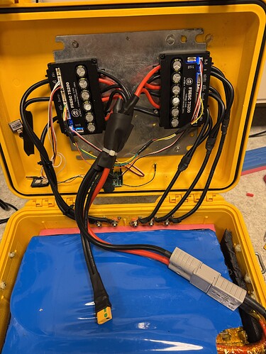

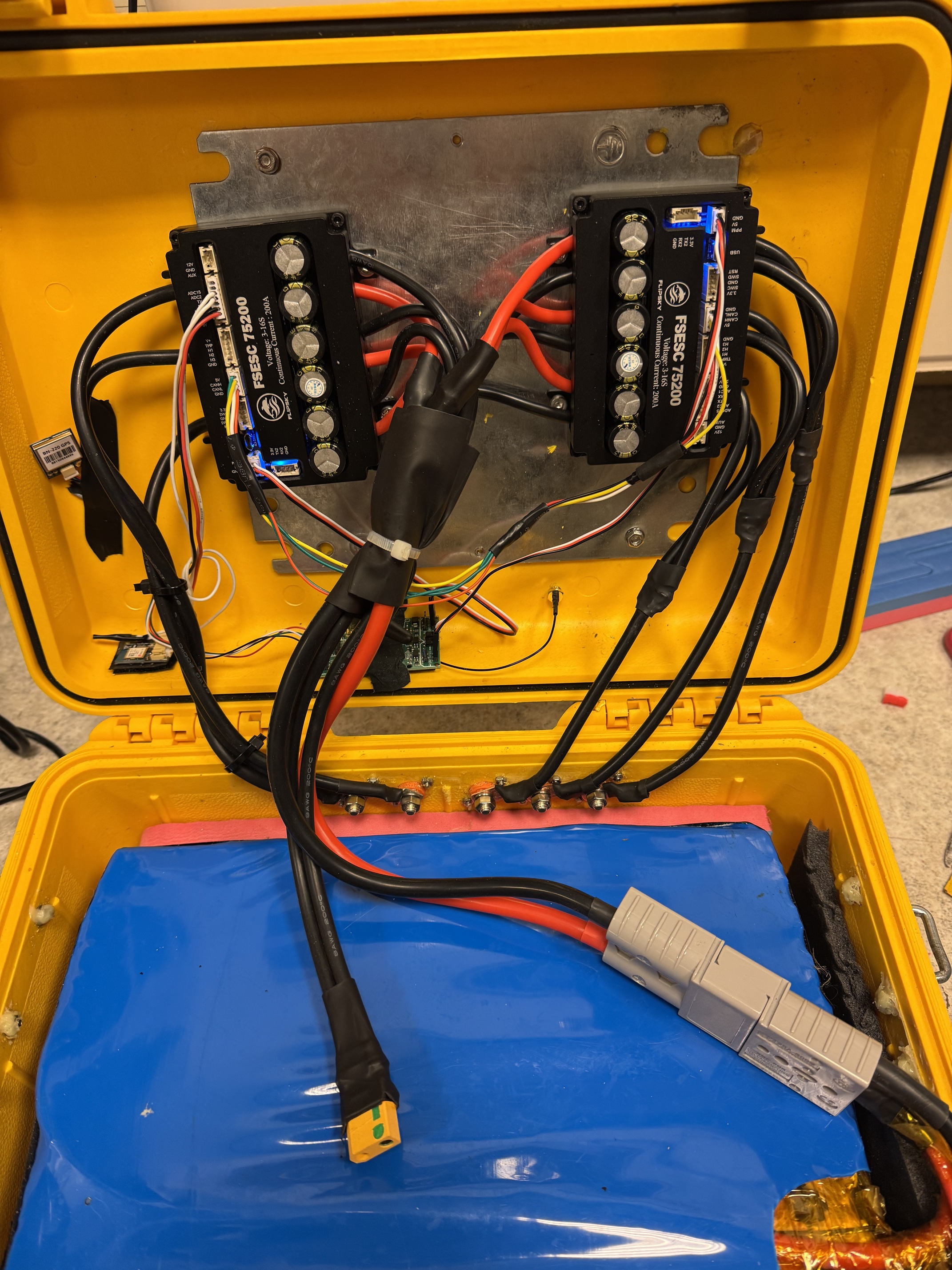

After testing the single motor setup for a while, I decided to finally go for the dual motor. Finished the electronics yesterday.
Thanks, can you tell me what model it is?
I used the Flipsky 65161 with 15 cm props. Enough power to get up and going.
