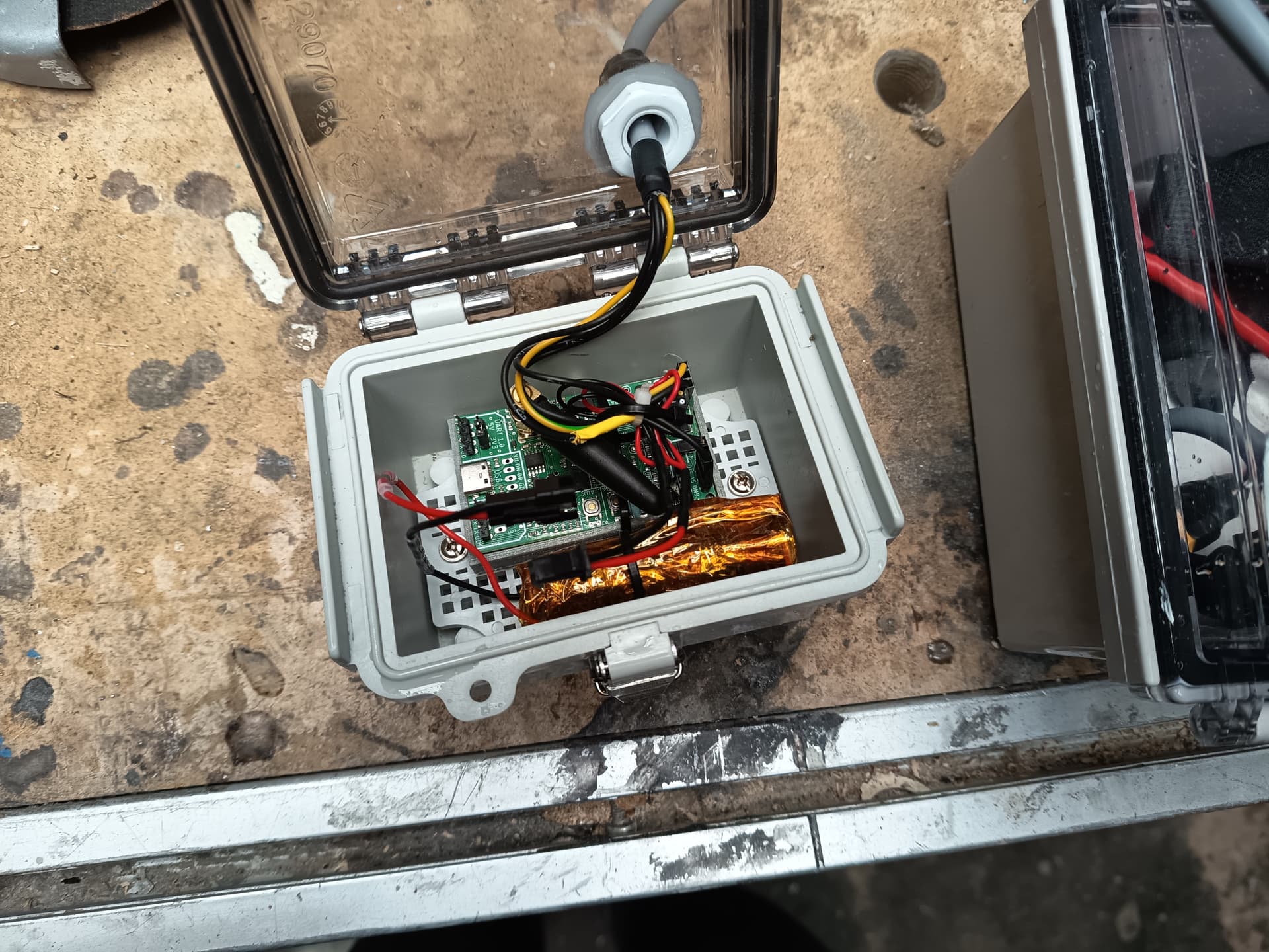

One 18650 at the RX.
I also tried with a stepup module to 5V, but it does not make any difference.

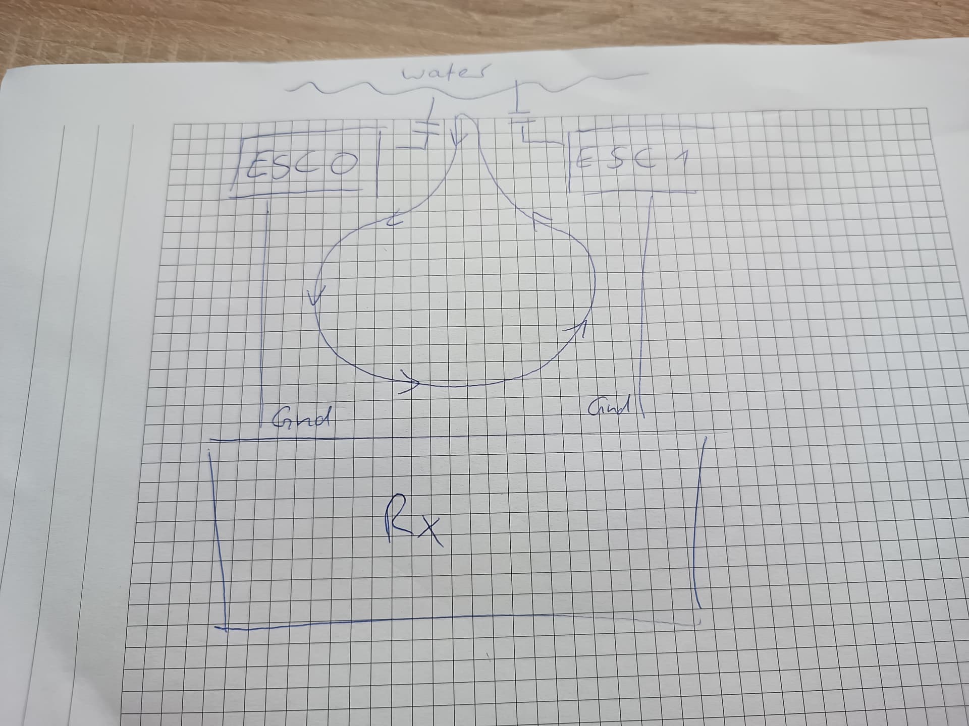

This is a quick sketch of the problem
The ESCs couple capacitively to the water through motor and wires. This current will disturb the very low voltage on the signal wire by inducing a voltage on the thin GND wires between Rx and ESCs. Thats why only one motor at a time works well.
The Rx is specifically designed to have separate GNDs because of this problem. You can imagine how the “current loop” will be broken if the two GNDs at the bottom are not connected anymore.
