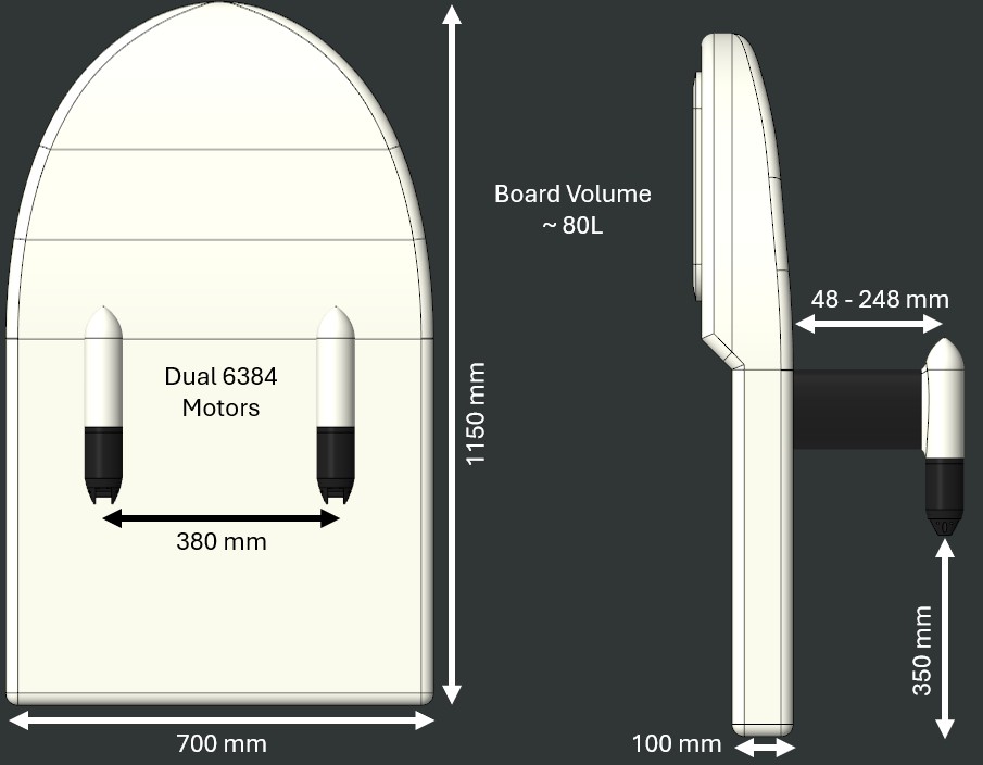

I am working currently on my second tow boogie since my first on with a single 65161 + Rudder drives like an crazy horse. I am more fighting with it to go in a straight line than enjoying the ride. Here is what i came up with for now. I am limited in size by what i can fit into my car. I am planning to make the masts height adjustable for ease of transportation and fine tuning. Battery will be a 12S6P 21700 in the front. What do you guys think could this work?

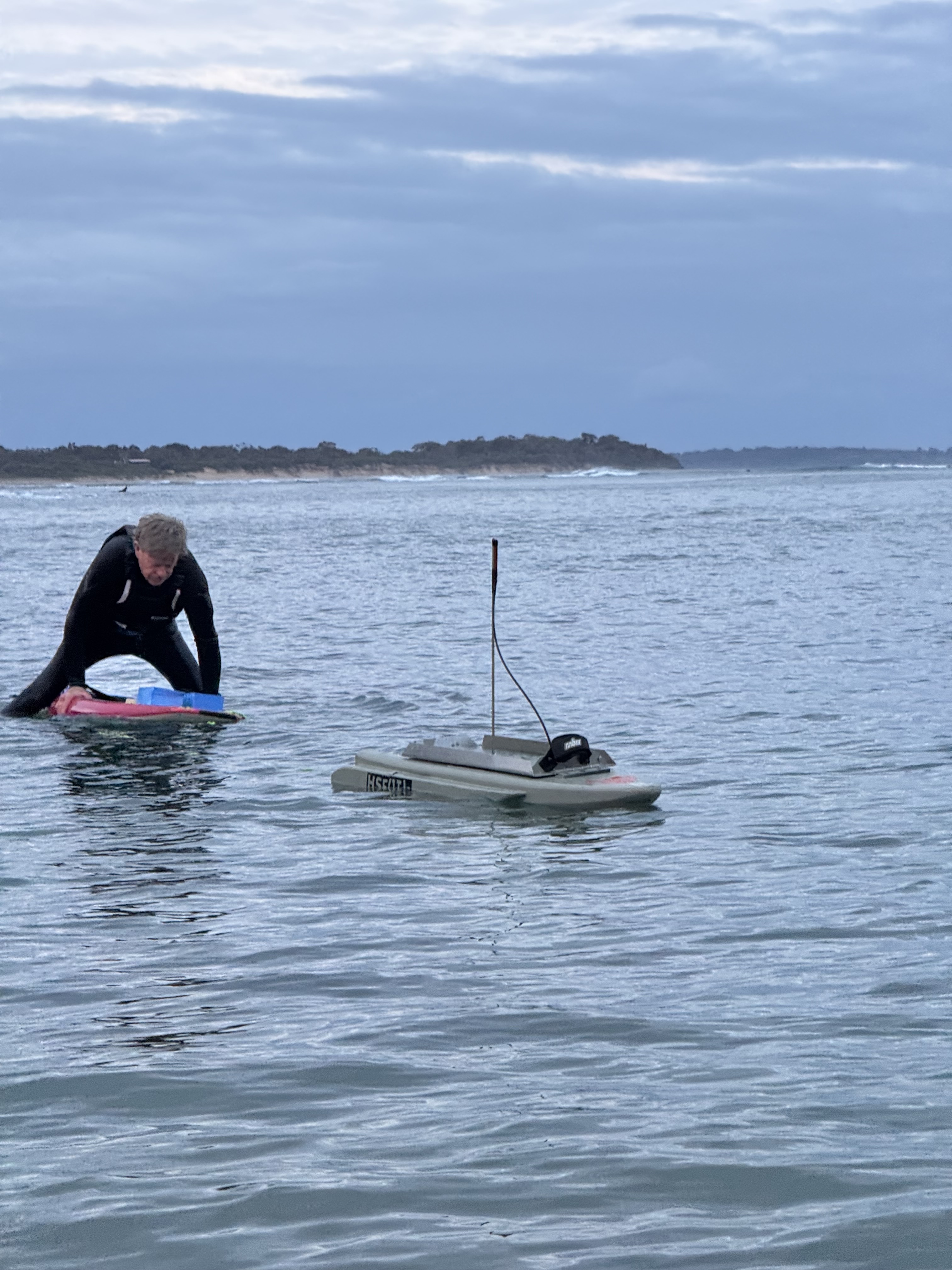

Ive had real problems with the etow getting cavitation on one prop at about 18-20kmph - then rolling onto the opposing side…
sorry i meant to reply to another post! hahaha whata dumbass…
yeah so ive been trying all kinds of differnt configurations on the same hull… single motor, twin differential motors and i line twin… I must say i like the performance of the inline twin the most - it pulls hard and rides true in our choppy bay conditions…
The side by side twin differential steering model has almost beaten me - i keep getting cavitation on one or the other motors at 18 odd kmph - at the point where the motor that cavitates starts to ‘wheel spin’ the other motor ‘wins’ and twists the etow onto its side… my hull is self righting so its only momentary but driving me crazy!!!
Im using bremote v2 differential steering and have found that keeping the motors closer together really helps with a controllable turn arc… there has been no dofferwnce to the torque / cavitation twist issues by moving motors wider…
I read somewhere about air working sucking down access holes for wiring. … thats my next beast to address i guess

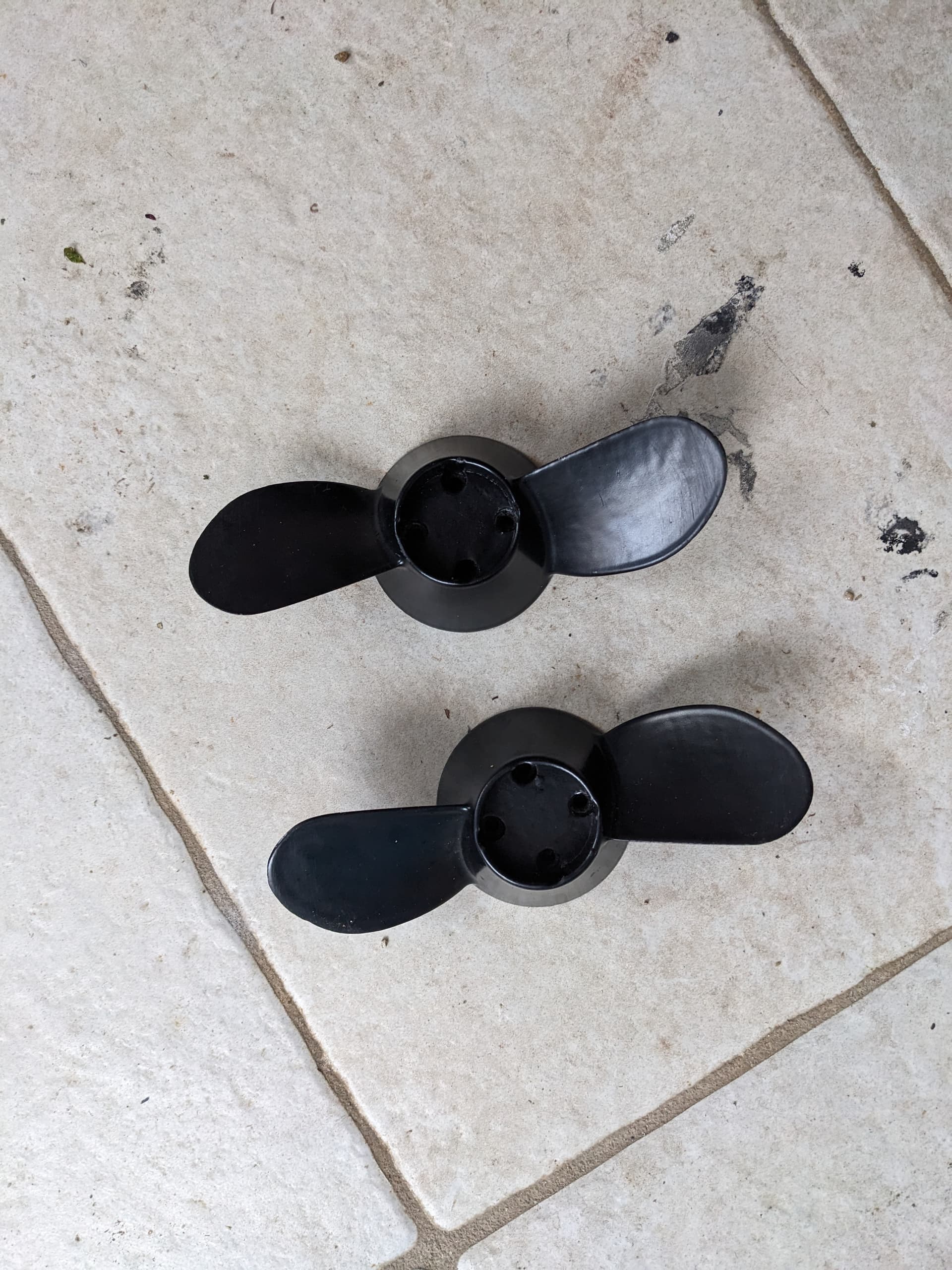

Are you using counter rotating props?
Yeah counter rotating props, Ive tried both ways - ‘outward spin’ and inward spin, similar behavious.

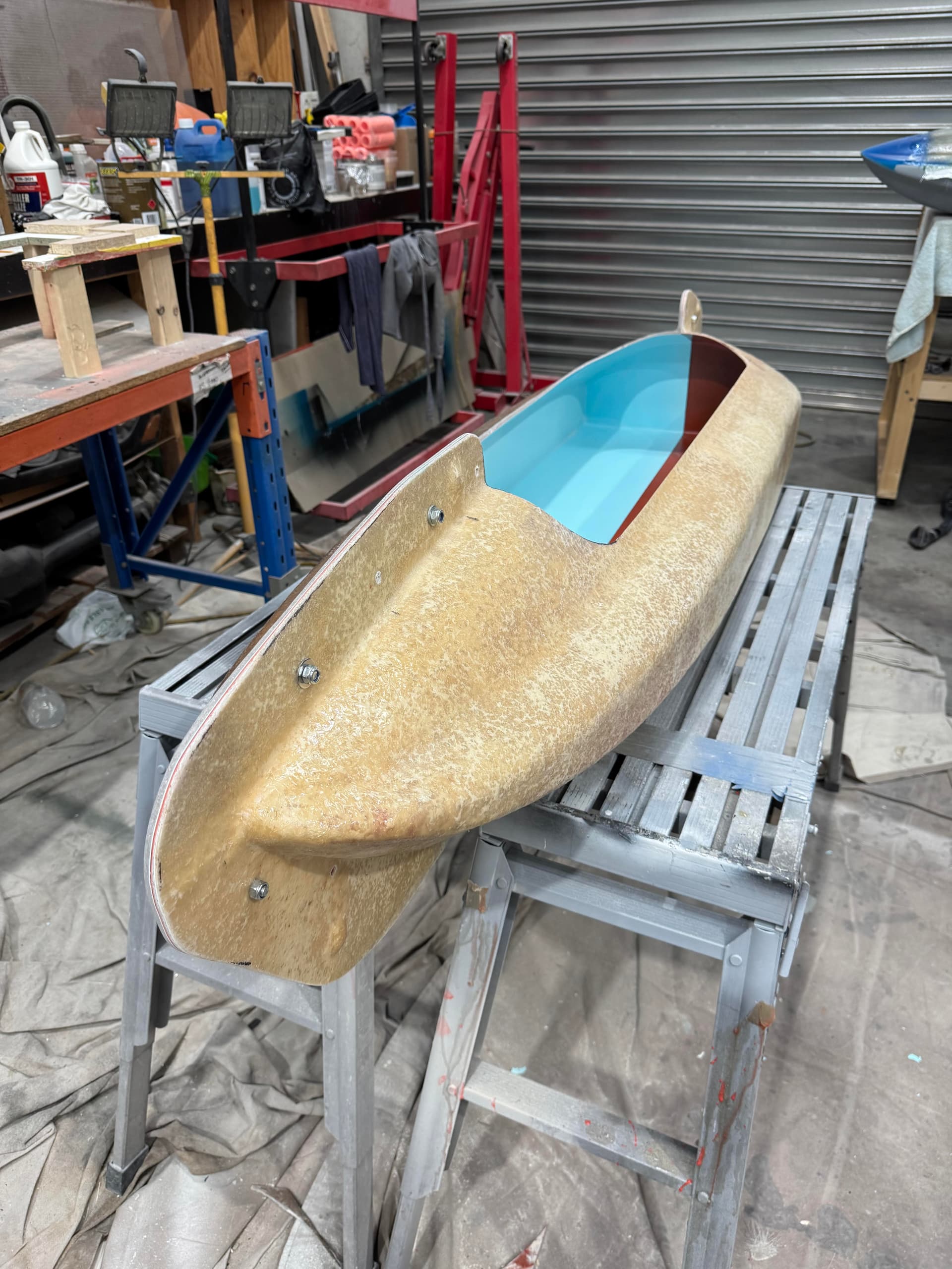

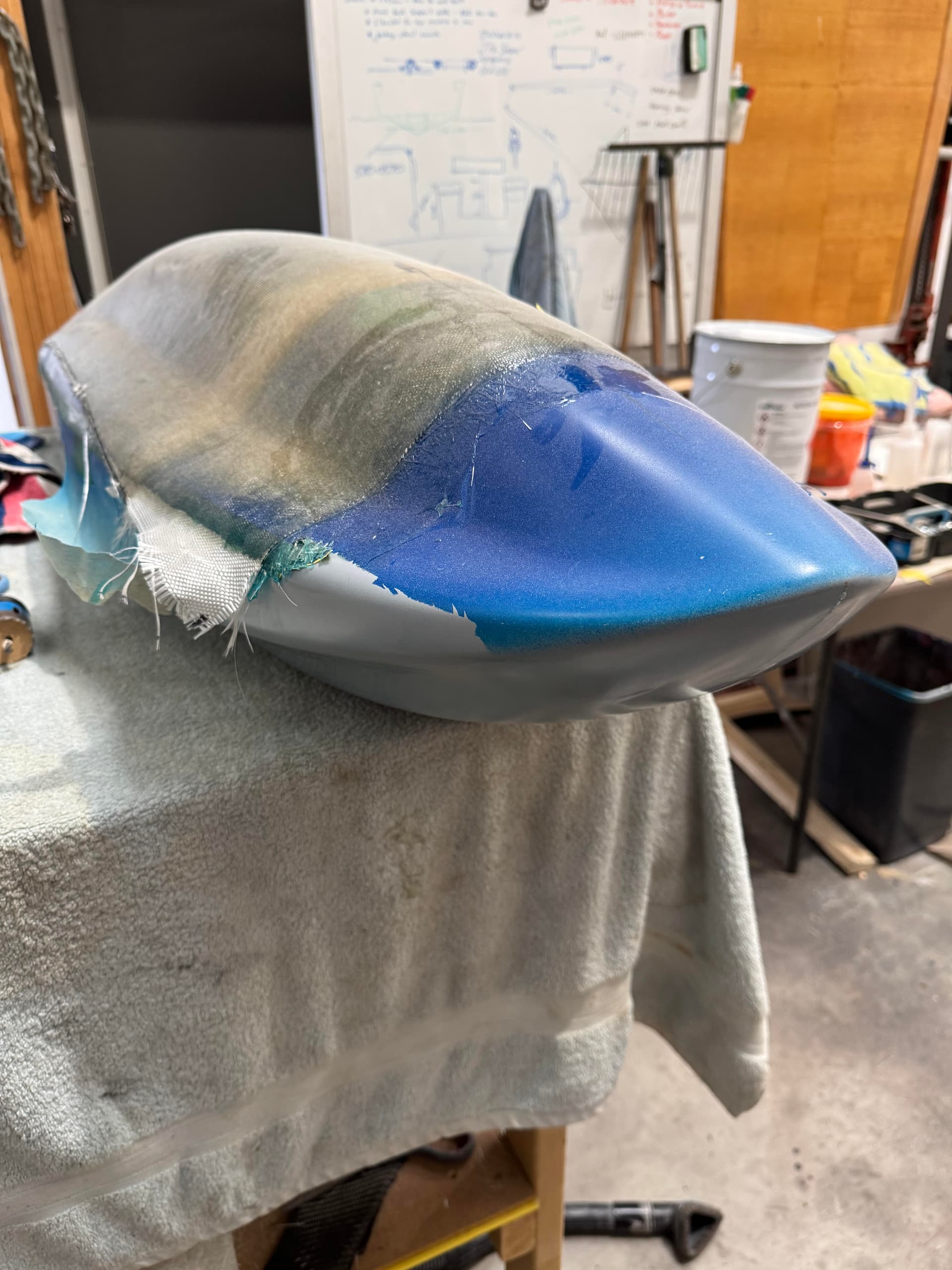

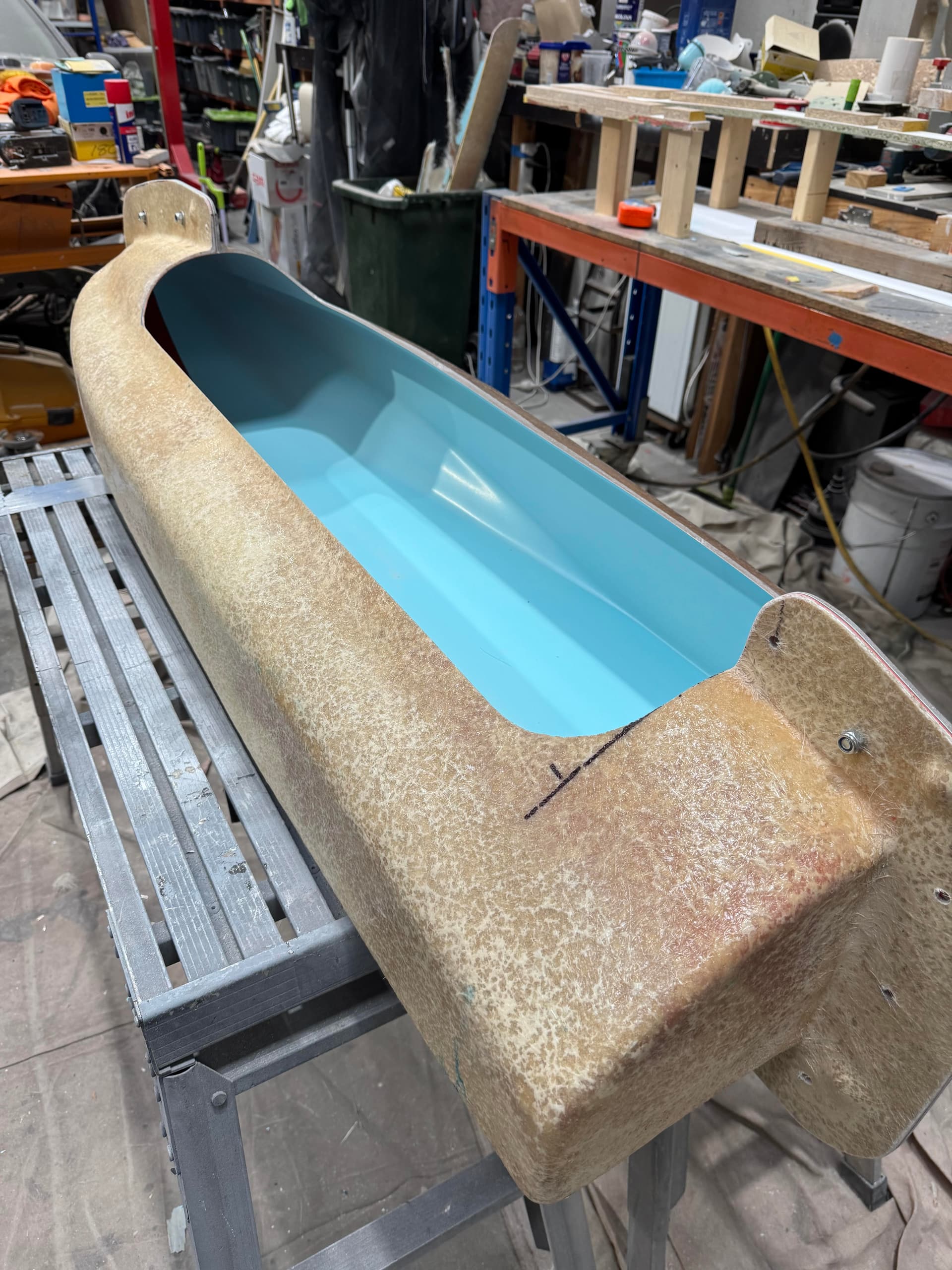

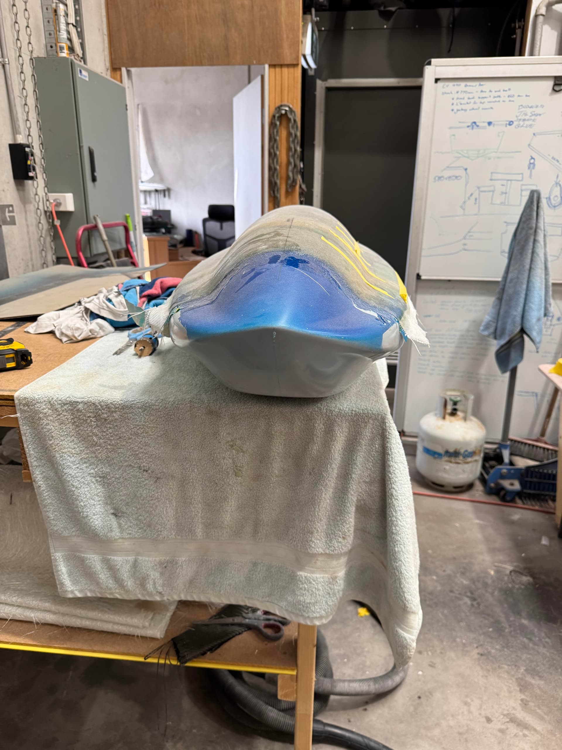

My Hull moulds are finally finished after around 2 months of really painstaikingly slow progress, polishing, sanding and perfecting the hull plug…
With the Molds complete for the hull, the team have descided a Carbon Fibre lid was the go for maximum stiffness for the top seal. The space to add battery cases / tech is immense - You can fit anything you like inside with 450 x 1500 x 200mm of internal space (rolled on the dec from 140mm up) -

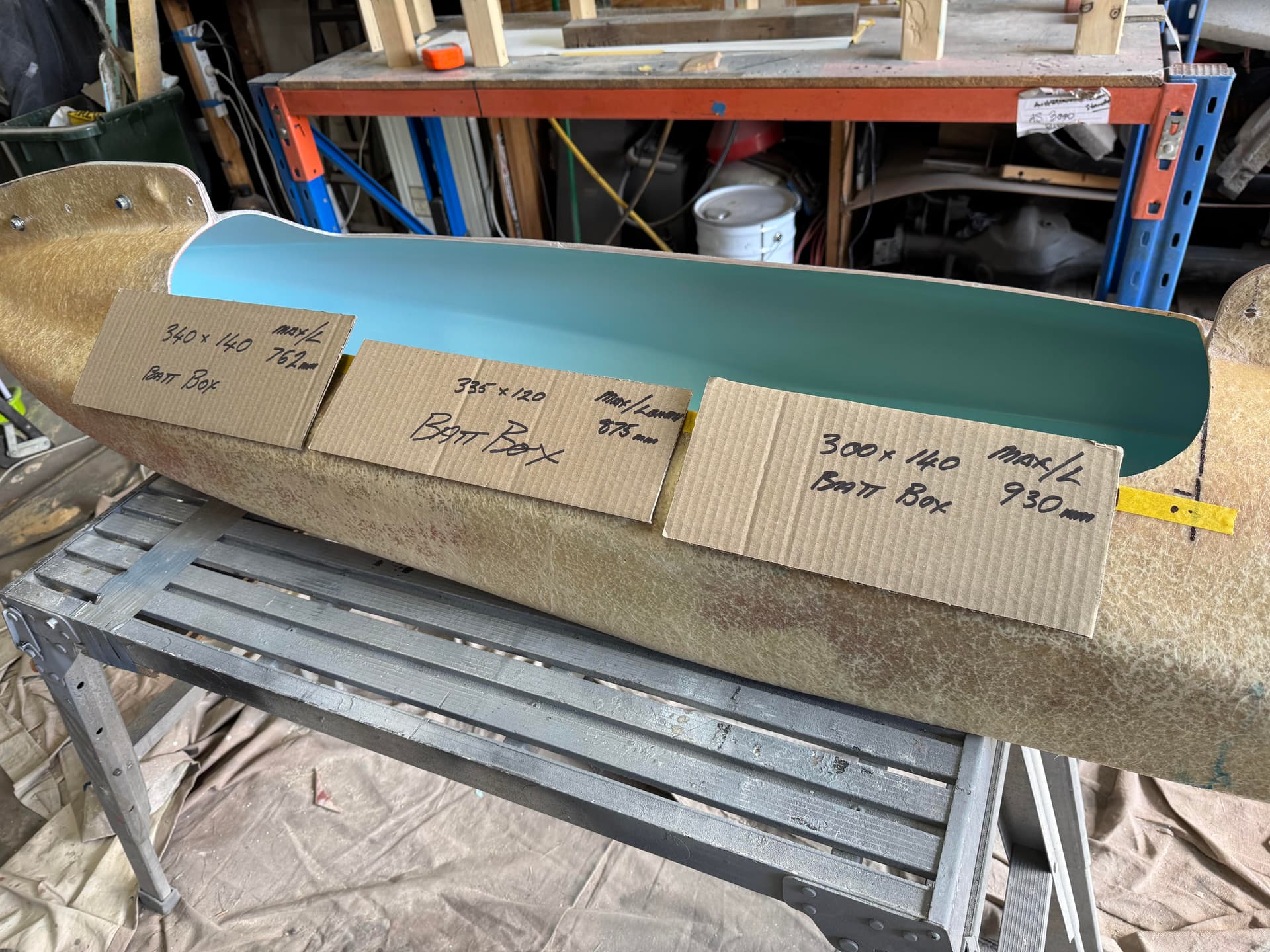

We tried a Big plastic box that was 300mm x 140mm x 930mm and it drops in nicely…
Some other random sizes tested listed on the carboard pics below for easy drop in.
