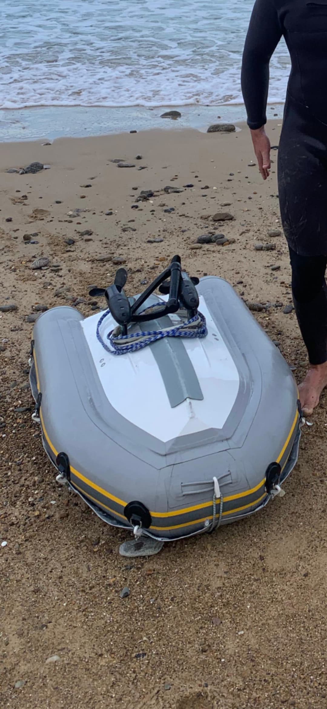

Finally got to test TOW Boogie and it went well.
My mate had a go and was up on foil with a few goes.
But eventually one motor started stuttering I think the ceramic bearings might of clapped out not quite sure yet but shouldn’t be too hard to figure out.
Has anyone had this issue before loose wire joint or bearings?

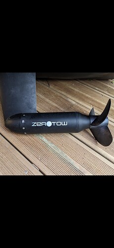

About this air bubbles, I would say it is the last main issue I experience. Comparing dinghy tow to my best friend Zerotow, it is night and day. He is able to take off with headwind and when Zerotow bounces in the chop, the Manta propeller never ventilates.
Whereas when the dinghy tow starts to do little jumps in the chop or when I try to start with headwind, I see a lot of air bubbles coming from the back and I often loose line tension . It’s annoying to be honnest !!!
It’s very hard to determinate the cause of this air bubbles. Too short masts ? Air coming from forward because of the hull shape ? Bad propeller design ? Too short distance between mast and blades ?
Something obvious between our respective propellers, design is very different. Manta propeller is lower aspect ratio and has more surface than mine.
It may handle more load on the blades than mine which may saturate at high load.
Any ideas or same experience ?

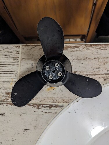

For what it is worth, my first attempt at the tow boogie had a fixed 3 blade propeller. It looks like the same as yours. I had lots of ventilation. I then changed them to a 3 blade folding prop printed in aluminium via craftcloud that are close the the genuine foil drive ones and I got far less ventilation. Run time was also greatly improved.
Dinghy tow looks fairly short no? Compared to zerotow that’s about 130cm long. That and shorter mast and the hull shape I can imagine when dinghy jumps on chop makes it worse

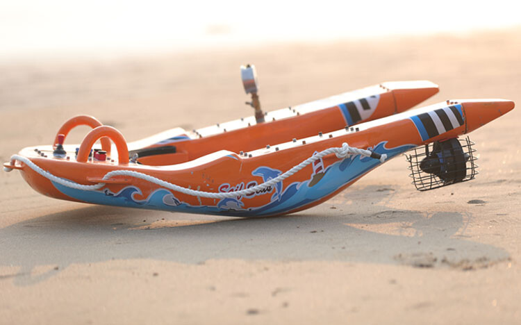

Saif Seas: A remote rescue craft, with some iterations on their website. Underpowered, but relevant.
RTM (roto moulded), more on the price than anything (€500) , but it looks like it could be adapted.

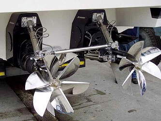

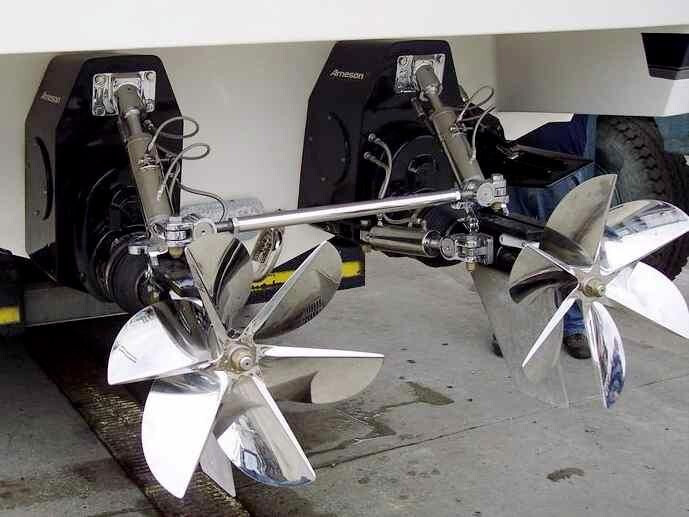

Something to look at is surfacing piercing propellers, where the propeller is always ventilated. I don’t necessarily believe it is the correct answer, but it is quite interesting.
It is relevant in two places:
  1. Offshore powerboat racing
  2. Solar circumnavigation
What is peculiar to me is that these are the two extreme opposite ends of the spectrum, with different power curves, different energy sources, and different speed ranges, and yet both ended up with this related design.

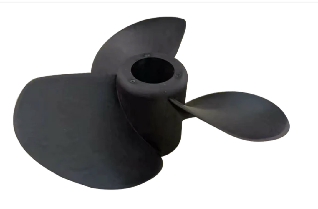

Is there anywhere I can buy these Ali blades from? But they may not suit these 6579motors

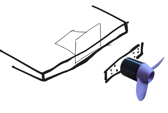

Setup rubber flaps like Zerotow V2, great improvement in term of sailing behaviour in the chop, jumps and take off
Is it on both sides? What is the rubber flaps helping with, push nose down at takeoff?
Yes on both sides, it helps pushing the nose down on take off, at speed, when the boogie jumps it stays more horizontal.
Ah very interesting. makes alot of sense. In a way its like interceptors they use on speedboats.

Lately I swapped my fixed 3 blades alu propeller from Volker to FD clones.
Big improvement felt in term of ventilation, flat trim sailing. I can take off with headwind now without any ventilation. No more issue when the tow lands on water after a jump because they have a very good and quick grip.
It’s just less fast and empties the battery a bit quicker.
Even moving from 2 blade to 3 blade PETG hub made a big difference for me. Did you move from 2 blade or 3 blade Volker prop? I have a set of 6 of these blades but having trouble with the hubs cracking when printed with PETG (no surprise really). Are your hubs surviving? What material and method did you use for the hubs?
