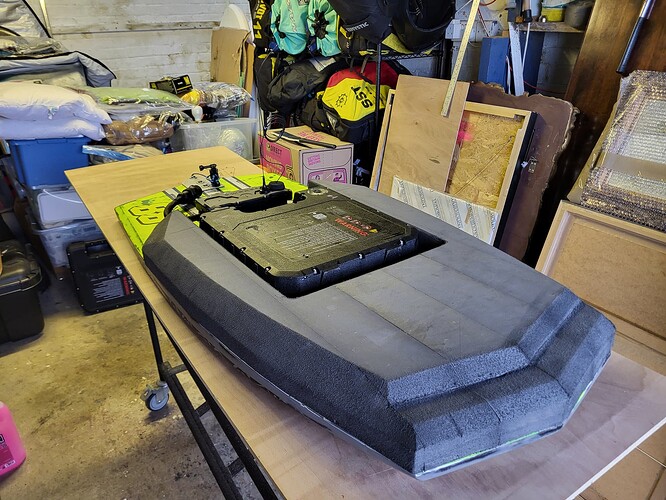

I had an idea to try use an exoskeleton of pool noodles to make my Boogie self-righting, and the first try it almost worked, just needed a little push to finish off the rotation, I’ll give it a tweak next year to try getting it working, guess I just stack more noodles on until it works :ramen: :sweat_smile:

EVA…easy to work with and uaes hand tools… the way forward IMHO
