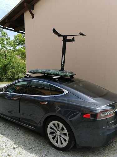

I do too from time to time. Last summer I traveled like this from Sofia to the island of Thassos. No problem.
And I haven’t removed the propeller. At one point I realized it was spinning, but I haven’t had a problem.

I guess it might create a sliding layer for the board though, but I always run a strap from the rear roof bar and around the mast to the other side of the rear bar to take the forces created during braking or crash.
Is this loop is closer to board or is it from rear bar left side “up” the mast closer to the motor and around the fuselage then back down to right side rear bar?
