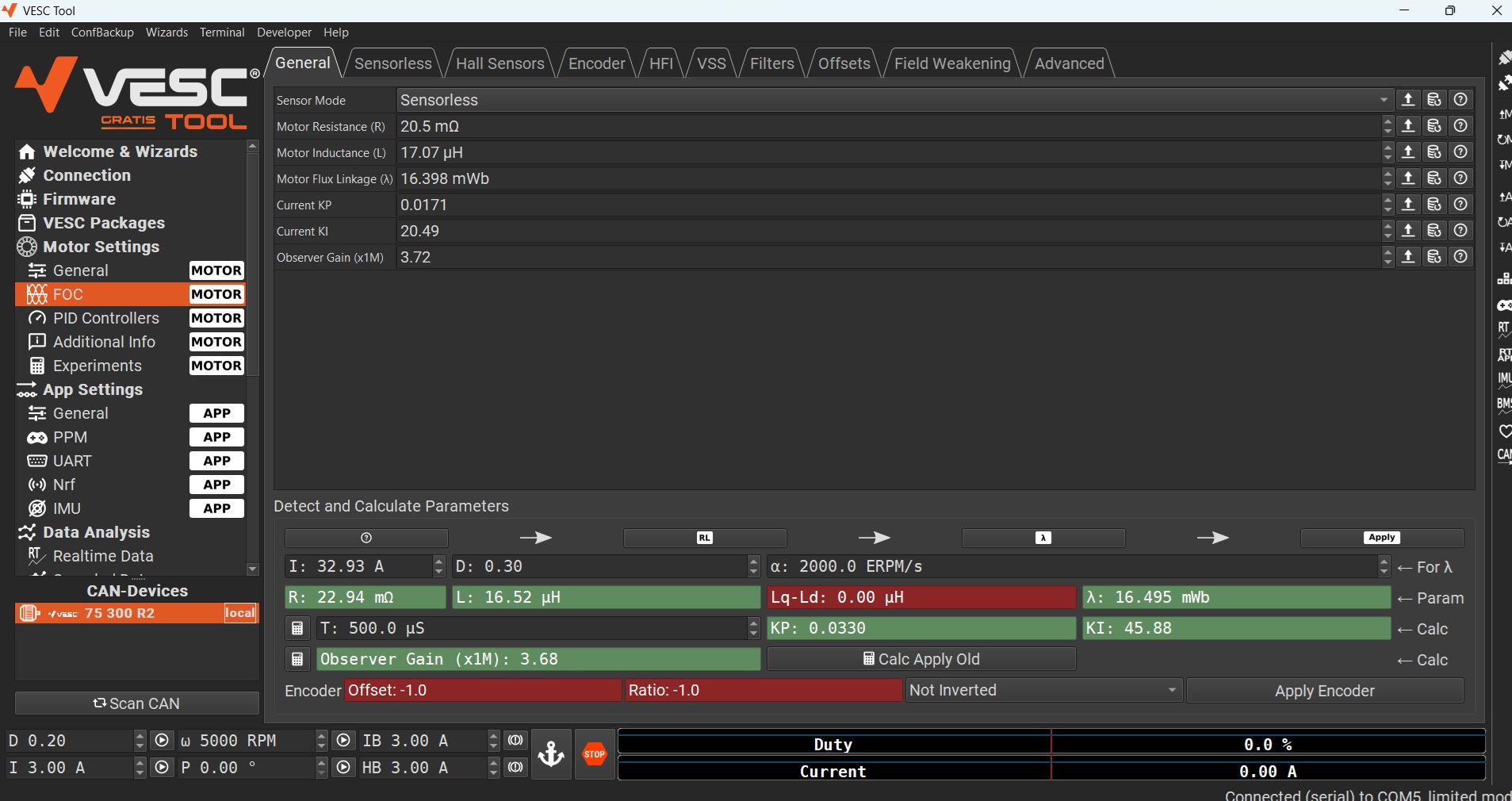

Got to the motor FOC setting and when going through the RL and A setting I get a red error on Lq-Ld and Encoder offset and ratio on the bottom.
I tried a couple of different I settings but still got the same error. I tried to save but motor wont start when I pull the trigger.
I tried the motor wizard and got some slightly different figures but the same red errors.

I would try to do the firmware update like shown in the video
Then follow all the steps again

Thanks for the help I think sorted it out. I updated the firmware and it got rid of the Lq-Ld error. “Encoder” and “Ratio” Were still red. These are options not showing on the video. Set the rest up as per the video except using my battery info.
