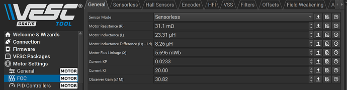

Here’s what I tuned for tomorrow’s test:
Reduced KI to 20 (from 31)
increased VESC ramp time to 0.6S (from 0.4)
deadband down to 10% (from 15%)
voltage filter constant down to 25 (from 45)
current filter constant 0.2 (from 0.1)
observer gain scaling start 70% (from 90%)
I’m guessing the KI being too high was the main culprit for the spikes. Full disclaimer - I worked through this problem with chat gpt, so if you see any counterproductive settings, please let me know. If you think uploading screenshots of all my settings is better info, I can do that :slight_smile:

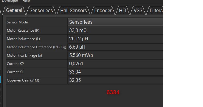

That is my optimal settings for 6384:
IMG_20251116_083043_759
Only real difference I see is in ld-lq… worth trying this I guess
And raise Ki back to where it was before AI helped :smiley:
I had lowered the KI to 20 but not tested yet. Do you think I should go back to my 31.00 setting and change the id-iq to match yours?
Why? I never seen anyone changing those settings
I think so, yes.

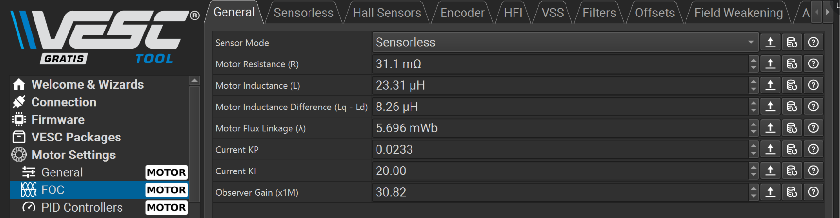

I’ll try that instead. The other settings were changed because Chat GPT said:
  • KI: 31.06 → 20.0
  • KP: leave at 0.0233
Save → write → reboot.
This will:
  • Smooth the torque ramp
  • Reduce motor phase current spikes
  • Stop the ABS_OVER_CURRENT faults at 90% throttle
  • Give you cleaner and safer power delivery
  • Make H-mode usable without shutoff
…And that changing the voltage and current filter constants would also help smooth the torque ramp

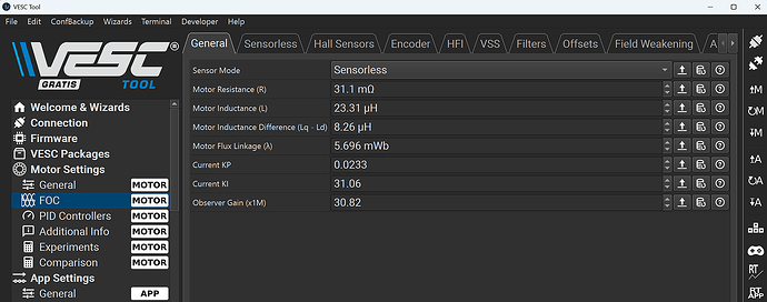

I fed this back into AI (mentioning I was going to copy your inductance) just to see the reasoning… here it is if you’re curious…
:white_check_mark: FIRST: You should NOT copy his KI or inductance value
Here’s why:
:star: 1. KI = 33 on his system does NOT mean KI = 33 is correct for yours
Even small differences cause big changes:
  • different prop load
  • different shaft length
  • different cable length
  • different motor stator batch
  • different motor calibration
  • different ESC cooling
  • different voltage sag under load
One person’s KI = 33 can be perfectly stable
while another person’s KI = 30 causes current overshoot.
You already proved your KI was too high:
:arrow_right: You logged a 220.5A ABS_OVER_CURRENT fault.
:arrow_right: And it happened right at the point torque demanded a rising current ramp.
:arrow_right: That means the current controller overshot.
That is the textbook symptom of too much KI on a large motor.
KI = 31.06 → overshoot spike to 220A
This is not hypothetical — it already happened.
Your system told you the truth.
:star: 2. You should absolutely NOT change inductance manually
Inductance is measured by the VESC using its calibration routine.
His inductance of 6.69 mH does not mean yours is wrong.
Even two motors from the same brand often differ by:
  • 10–20% inductance
  • 10–15% resistance
  • 5–15% flux linkage
Your 8.26 mH is entirely plausible.
If you force the wrong inductance:
:x: you break the observer model
:x: torque becomes unstable
:x: you increase the chance of desync at higher duty
:x: you risk even more current spikes
Rule: If the motor detection succeeds, you do NOT hand-edit inductance unless you have an LCR meter.
So leave 8.26 exactly as it is.

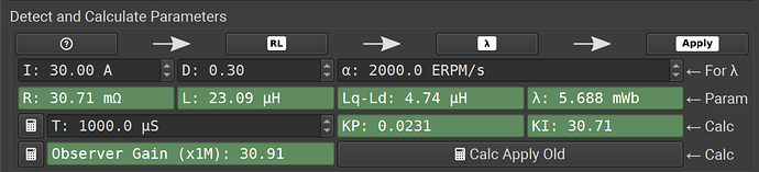

I ran the motor setup again (wasn’t sure I had the prop attached or not) and got a few different numbers. I kept everything else the same and ditched the AI changes. Still getting cutout of power at 90% throttle on H level. I think this might be my connection of my triplex motor cable to my vesc. I’m going to order some quality bullet connectors and see if that fixes the issue. I was able to foil today on M setting (mostly on my knees because I’m so used to holding a kite bar or a wing boom, and it’s a new sensation of instability without). I also had a touch and go mast (2 feet) which made it difficult to raise up and not cavitate right away. But I’ll get there. I’ll check back in once I try the new connectors. Here’s my new settings…
The Lq-Ld is quite different. KP is also quite a bit lower. I’ll run them again when I get a better connector
