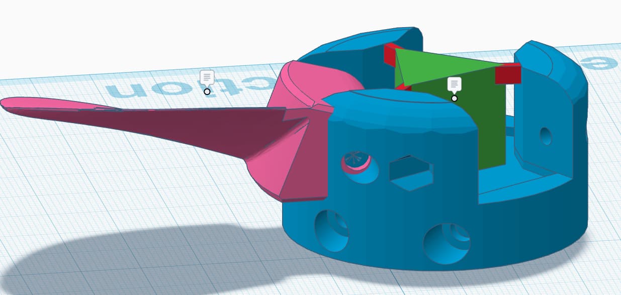

Hi, thanks for sharing, I managed to send the 5085 hub to fusion, but I don’t get your design with the green triangular part in the middle with those red bridges. Did you slightly misalign the angle to get space for the screw heads? That red bridge seems quite thin. What material did you print it from?
The center suboptimal design (triangle and bridges) is there to stop the props from folding further and touching each other… They have a complex asymmetrical shape at the base and the space left in the center of the hub is very limited, so I came up with this shape but it is definitely possible to improve this, or adapt depending on a different blade base shape. I print in petg-cf 30 walls 80% infill.
Thanks, that makes sense. I‘ll try and see. I think I‘ll print it in cc3d pbt pro. Maybe it could be split the way the FD hub is designed. Heat insert from the motor side and then screw the triangle with the bridges after installation (over the heads of the screws.

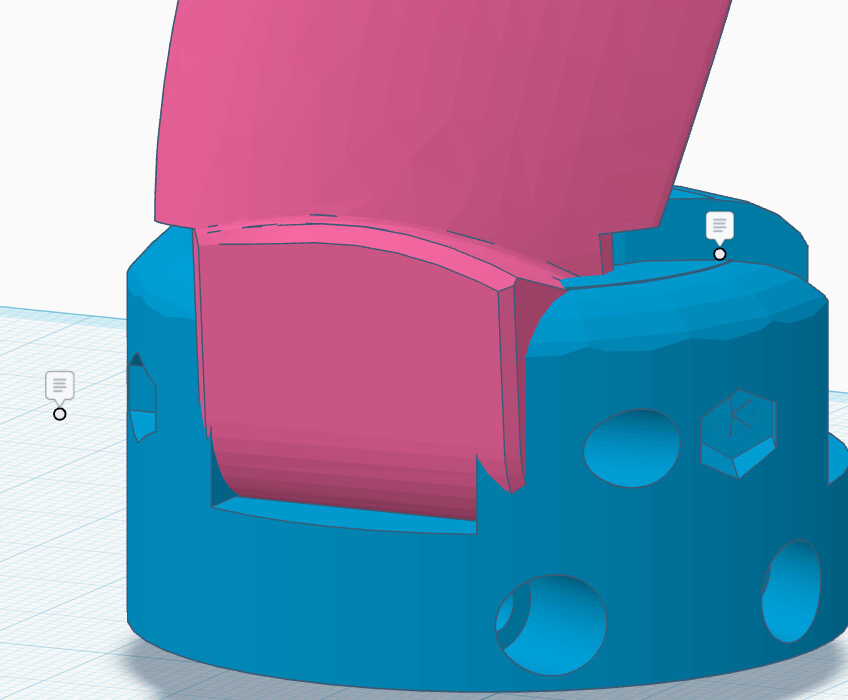

I just received my 5085 flispky, after a happy tester of 7070 and 6384 and 6374, thanks for your tinkercad files, I downloaded a lot of blades , but can t seem to fit your hub, (did you redude the foildrive scanned blades ? )
or maybe it s normal that the blades are like this when deployed ?

Looks like the blade model you have there is not the foildrive one (?) It should fit perfectly in the model
