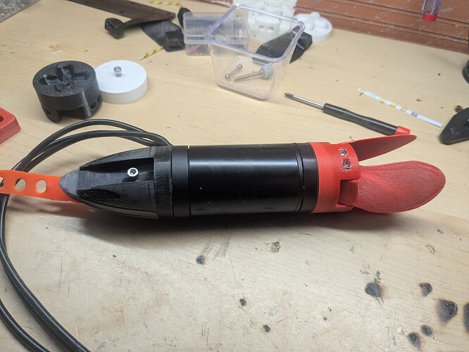

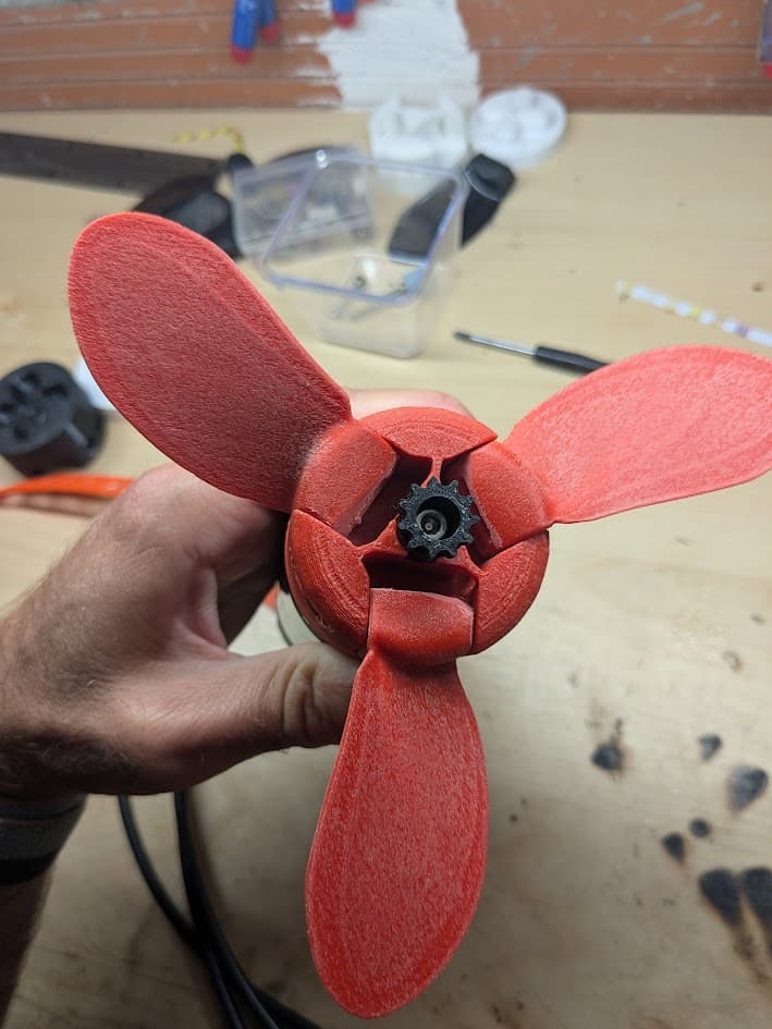

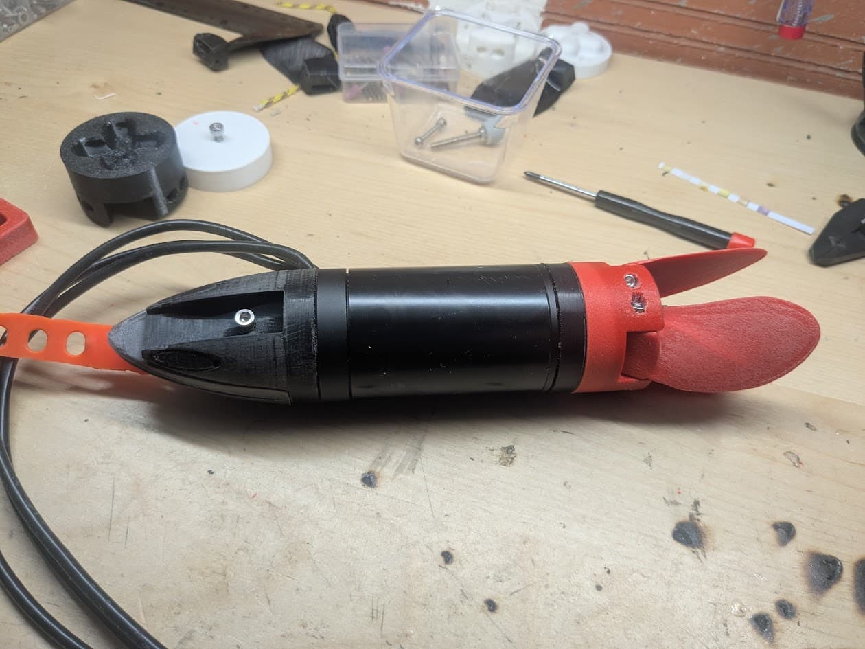

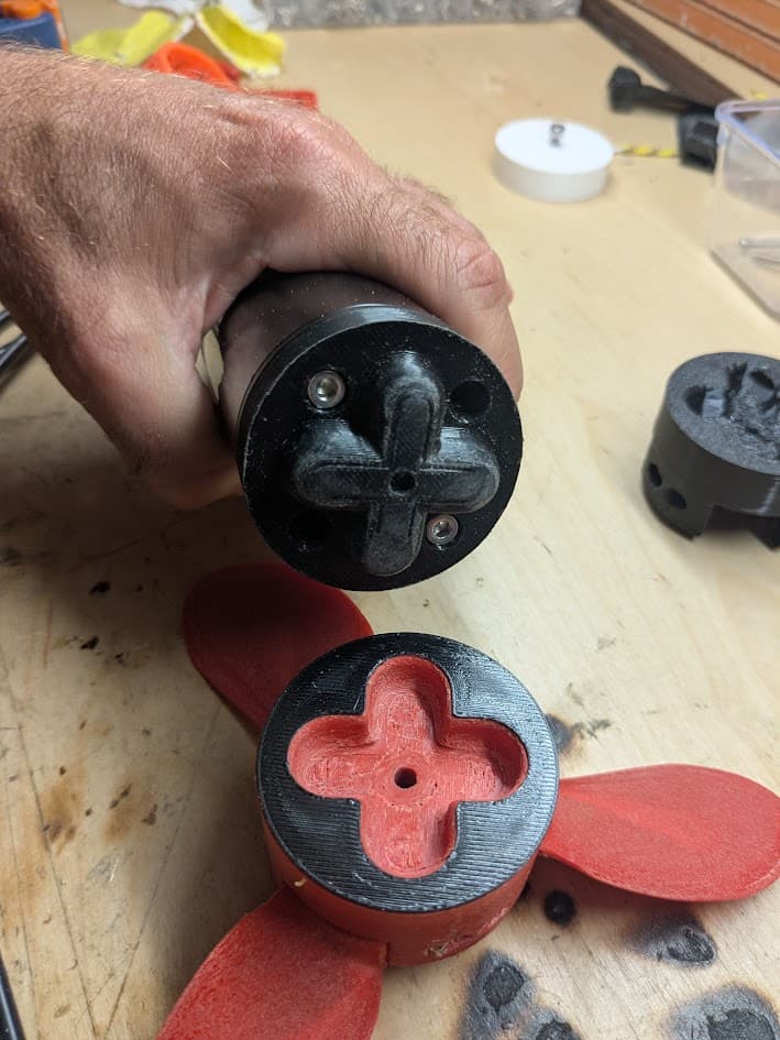

I used your Tinkercad files to create a remix with a three-blade propeller that can be disassembled without tools, printed in PET GF—I love how it turned out.
I also made a new tool-free pod that can be adapted to different masts, with a TPU section for vibration damping and mast adaptation.
Now I just need to test if I can take off as well as I do with my 6384 Flipsky.
Nice, I did this a while back to make swapping out props nice and fast.

the tpu insert is for my 14mm carbon uhm gong mast, but very easy to adapt to another mast (with tpu you don t the CAO files of the mast, just the overall length and thickness)
I will share the files for the mount and the toolless hub in a few weeks, after some more tests. (cannot share blades as they are not my model)
First test today, 5085, 12S3P 12,6A (molicell P42), FT85 ESC, 5.1 surfoil board 47L, 70KG, gong fluid XL 1160 cm², ratio 8,4, can flat water start, easier with a little push, propeller very comfortable, far less cavitation than my alu flipsky folding propeller for 6884 (next test will be my 3 blades PET GF 3 blades propeller with 6364, my toolless hub will be great to test on other motor also)

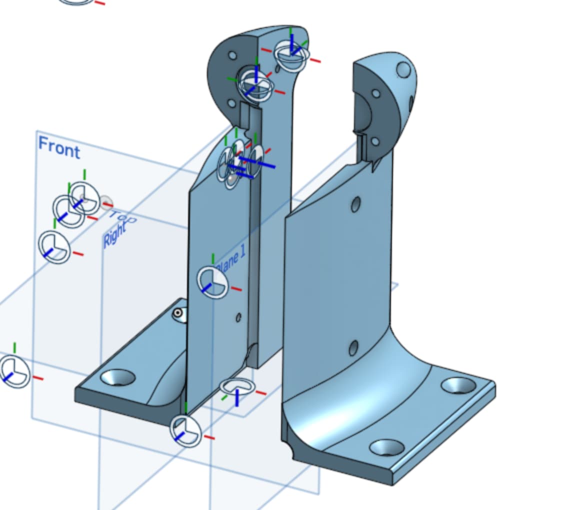

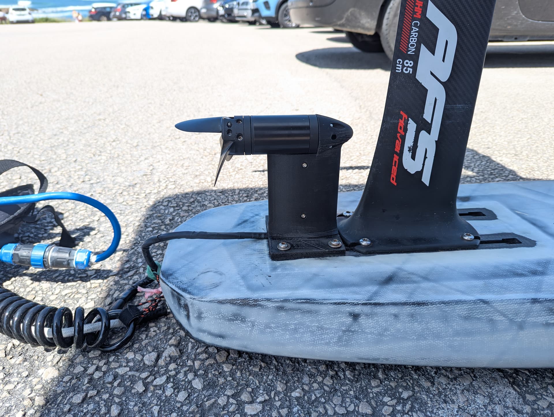

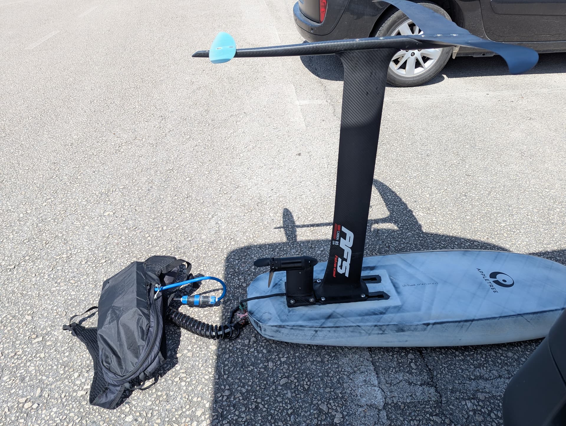

In order to avoid having a pod on the mast, I made a mini mast behind the mast that is quicker to setup (a bit like @Bzhwindtalker ). It definitely works great, but more weight on the tail of the board, a bit more flex, and prop close to the tail. To be continued, maybe carbon layup for lighter, and diagonal mini mast to get closer to the main mast. 3D file on onshape :

In your design, the motor plate mates directly with the propeller hub, and the rotational force from the spinning prop keeps the two parts locked together under load. If I’m understanding this correctly, there’s no need for bolts to secure the hub to the plate. That would also mean we could swap props right on the water. I am making a version for 6384 off your concept.
