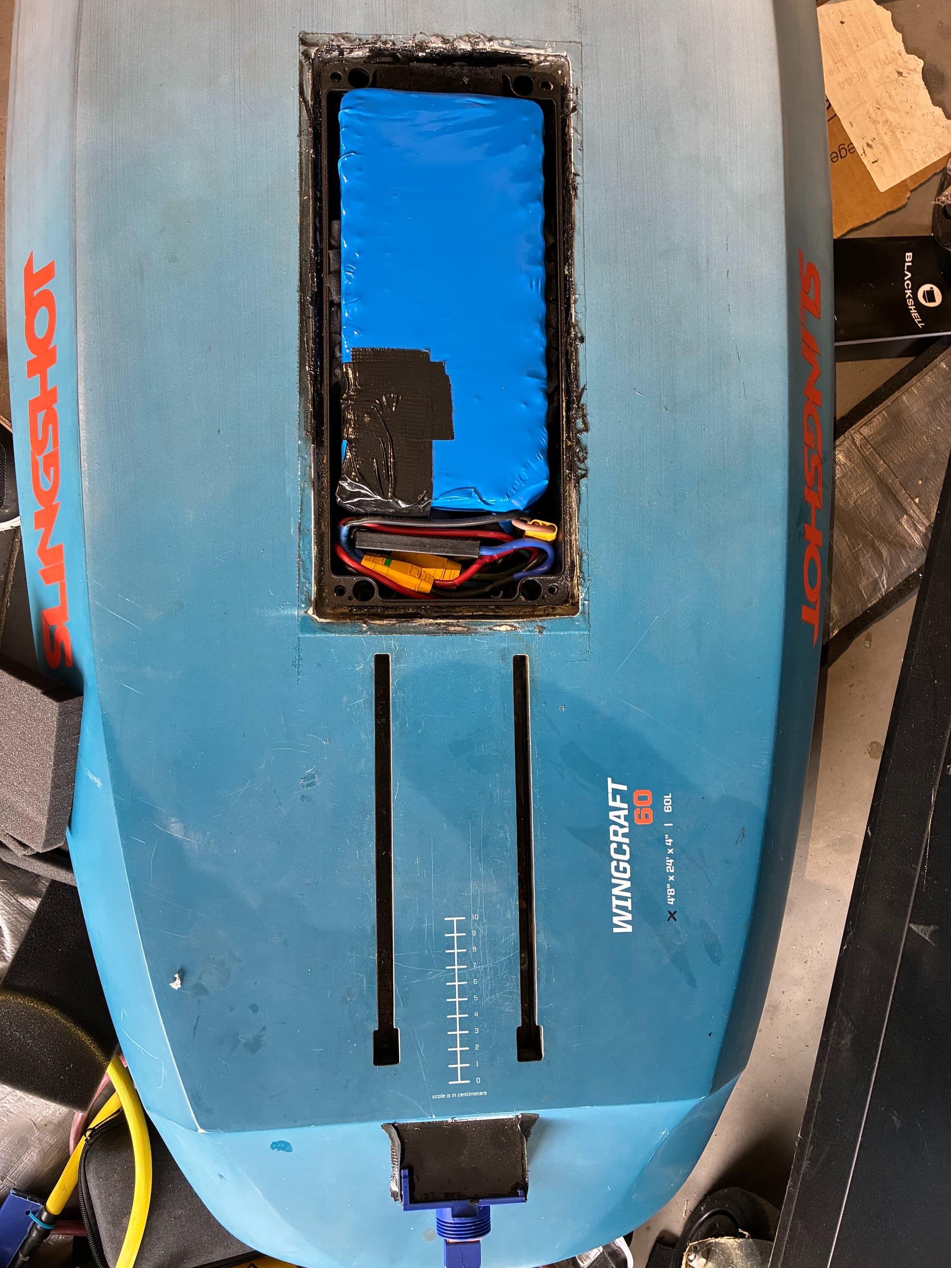

Can you please elaborate on the process with Epoxy to make the battery pack water proof?
How does this solution handles heat coming out of the batteries?
Thanks

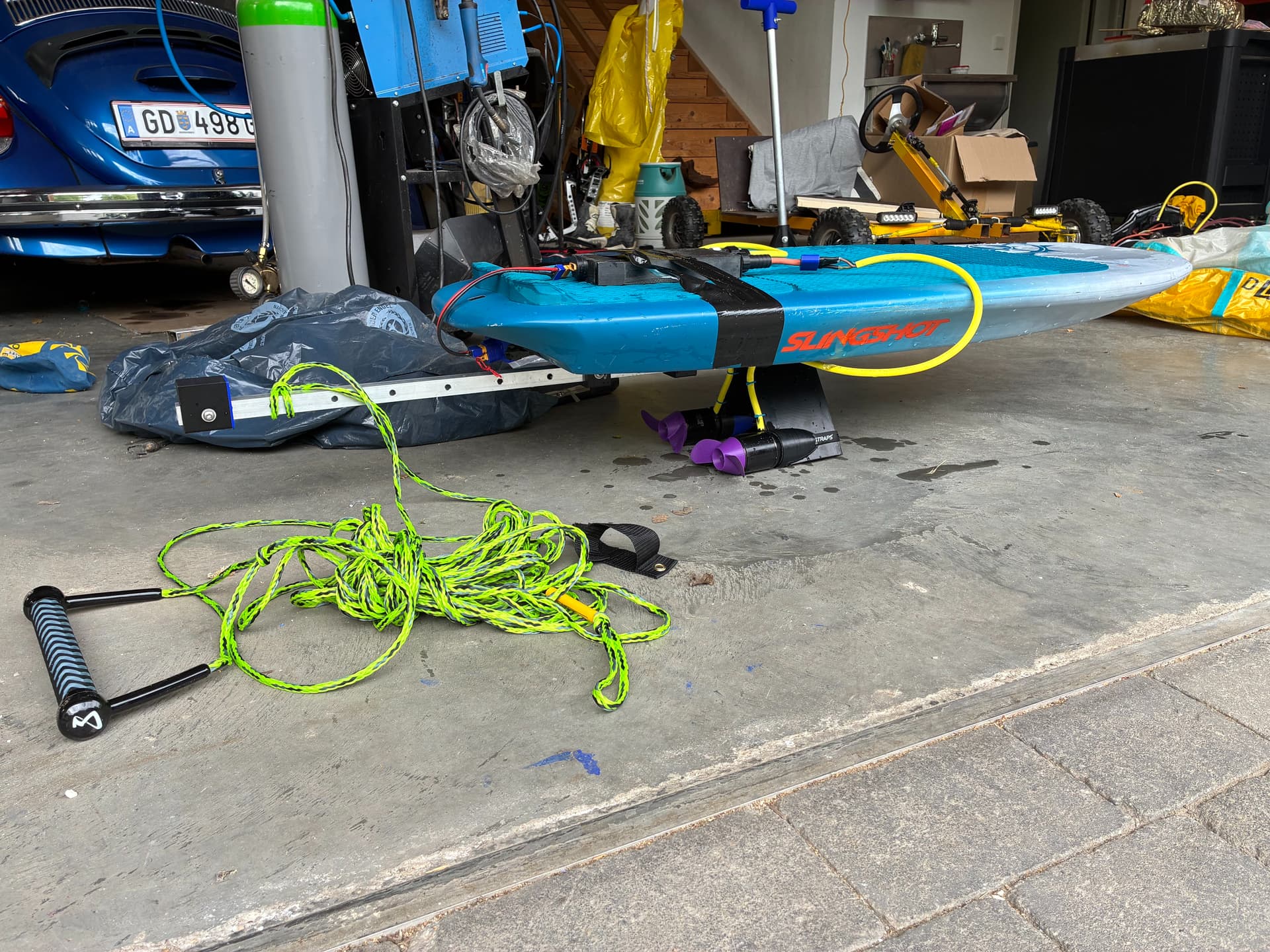

next step tow option:
more files soon at GitHub - robertzach/efoil
epoxy has good heat transfer. using the same for an electric winch for paragliding which has only air cooling and more amps without any issue since >2 years.
It is important to pot it all around.

looks awesome! do you know if the antenna is waterproof or did you pott it in epoxy?
yes, it is potted in epoxy.
first towing tests:
It is really fun!

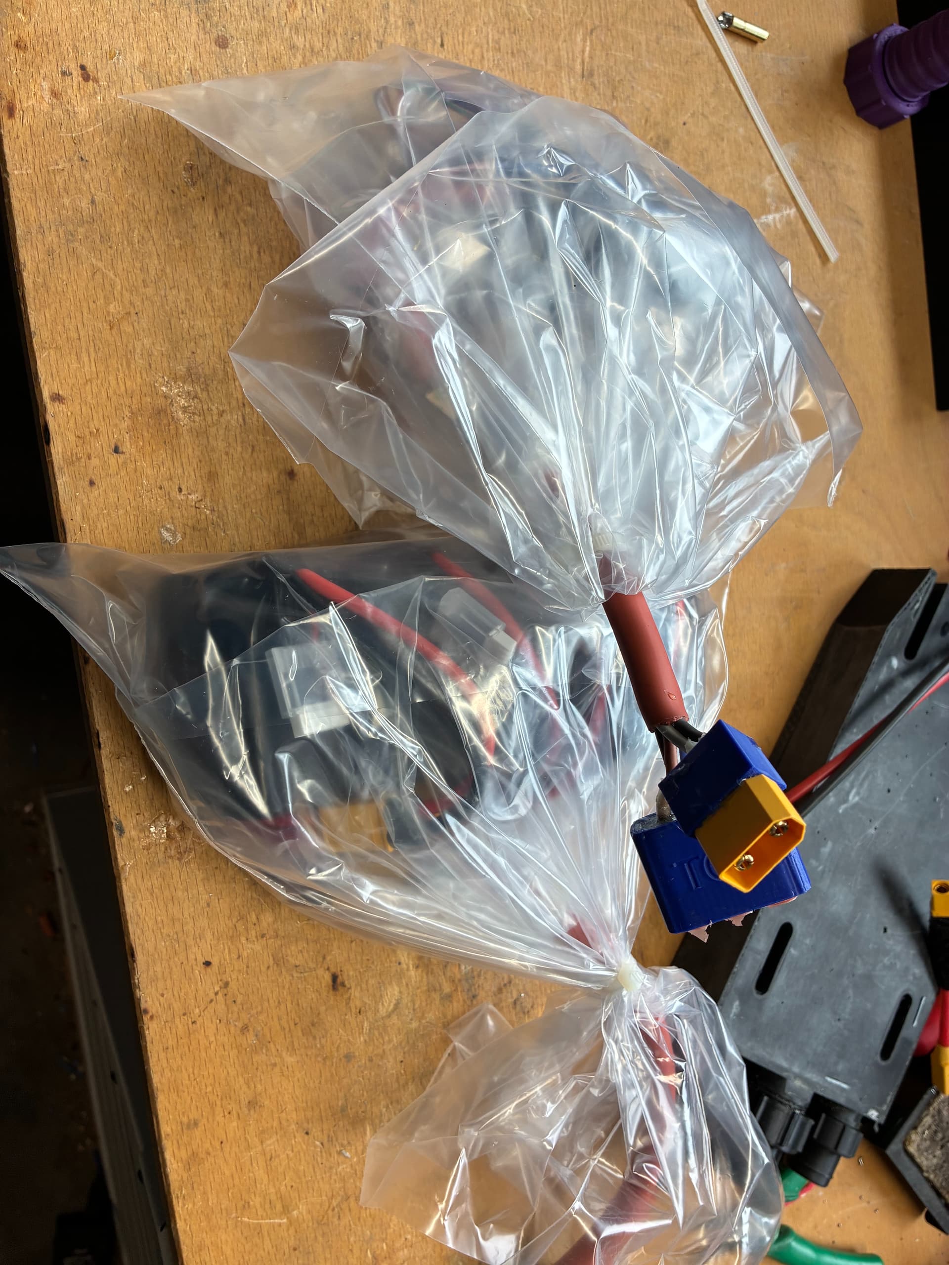

After testing a lot of different assist designs, I ended up in using two plastic bags.
One for the battery, one for a vesc.
I put both in a waterproof backbag and run the motor cable to the board.
This is somehow the lightest and easiest design possible.
I honestly have to say that I like this assist setup the most.
Having no weight on the board feels just great. And I don’t really feel the backbag.
Do you have a pic of the cable gland into the backpack, and perhaps hints on how to make it reliable and waterproof with some falls and abuse?
