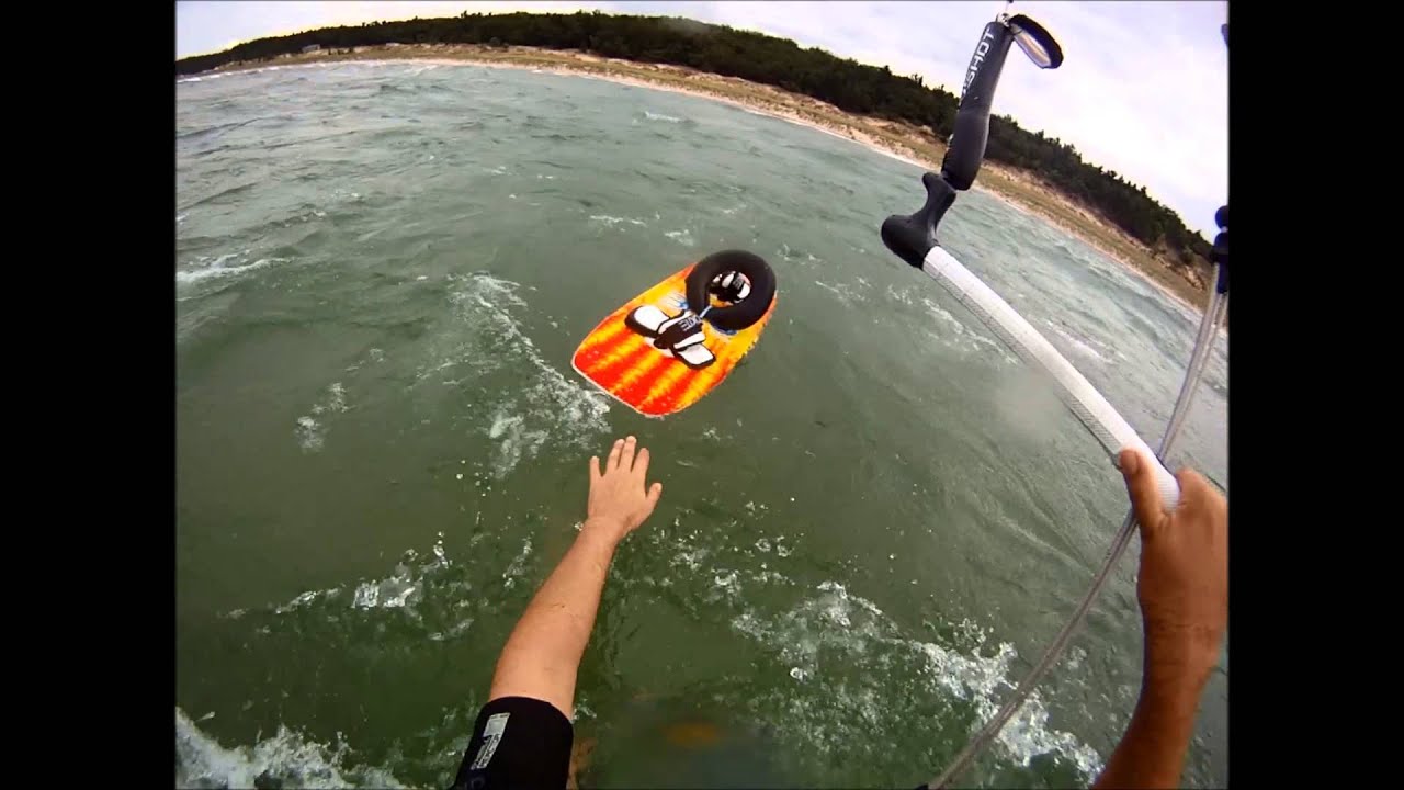

In waves, an anti-rollover system might be needed. Has anybody seen how an inflatable “Go Joe” from Ocean Rodeo work ? It forces the board right side up, and catches the wind so the board slowly travels downwind for you (not necessarily an advantage during off-shore windy days). And you can see the board !!
And because we are on a DiY forum, there is a 10usd inner tube alternative (wheelbarrow, golf cart, lawn mower, …):
