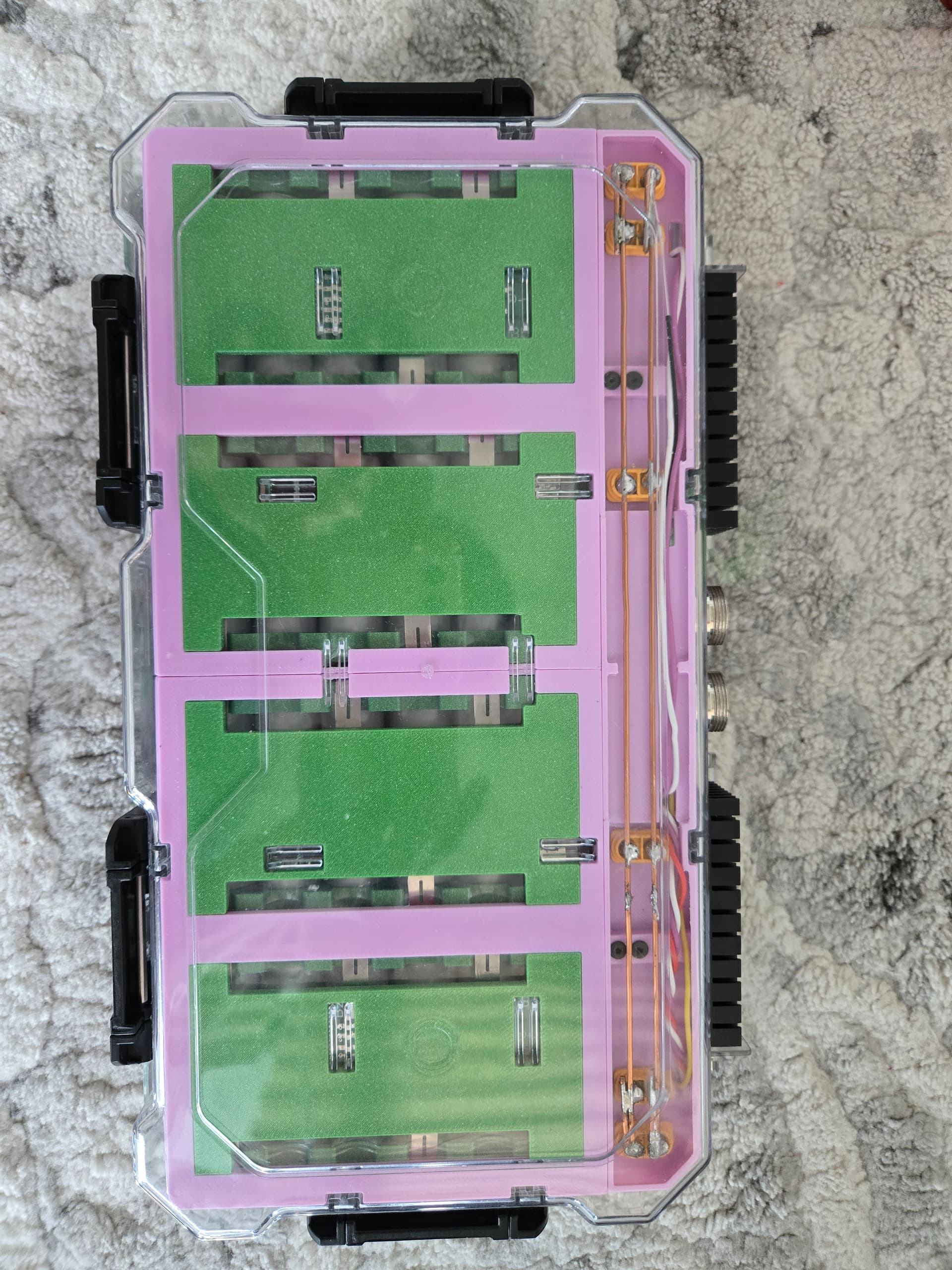

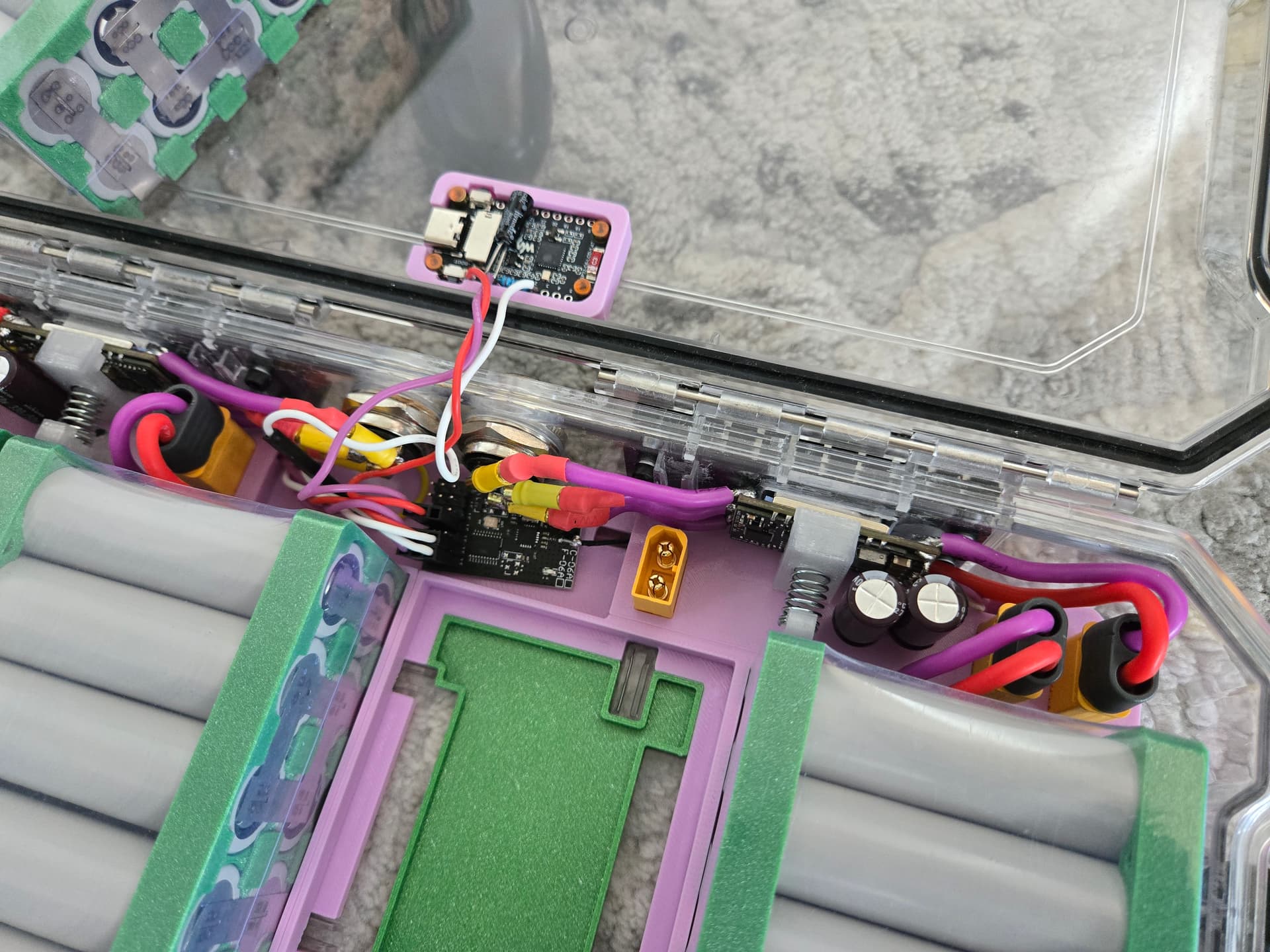

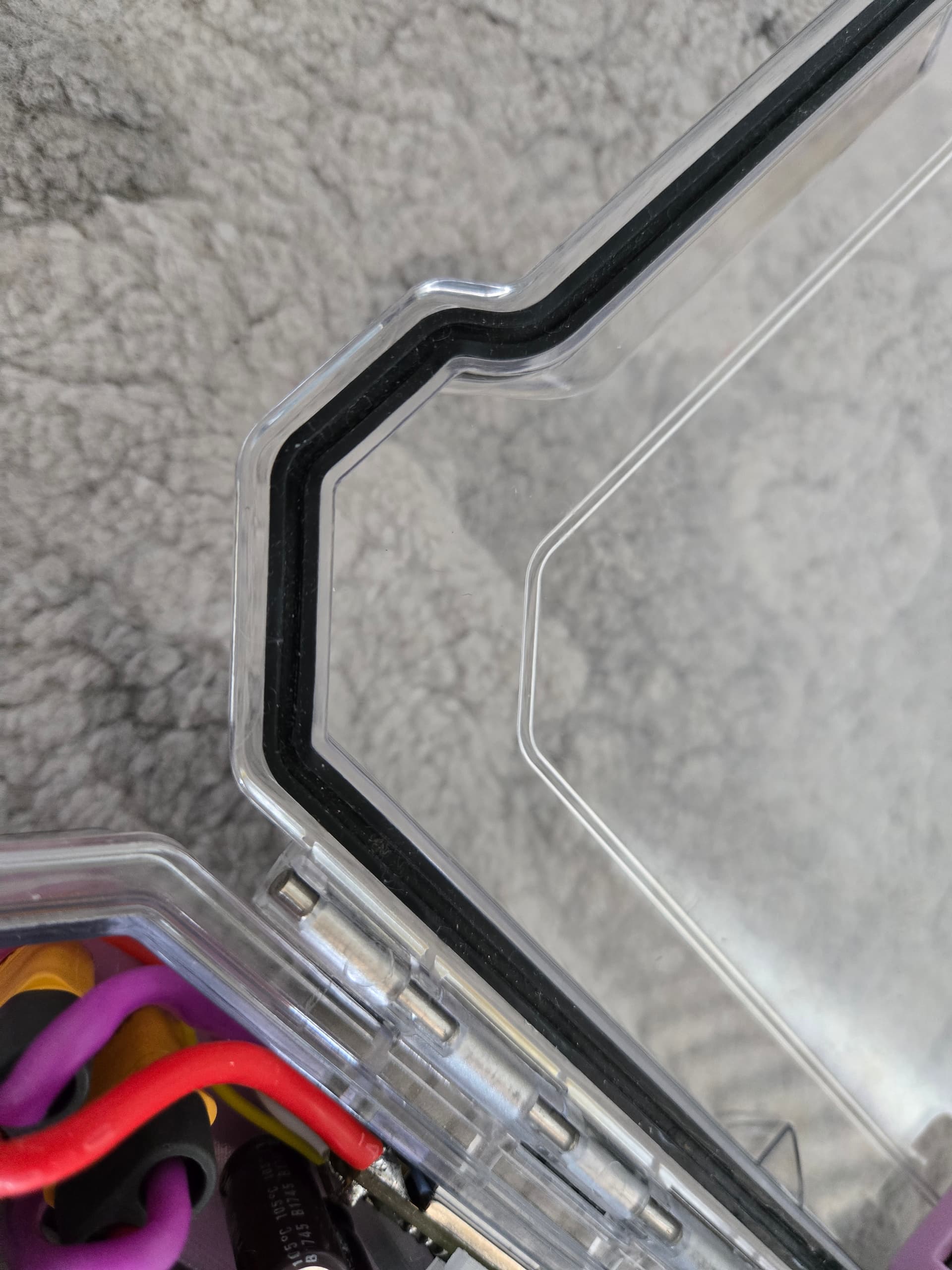

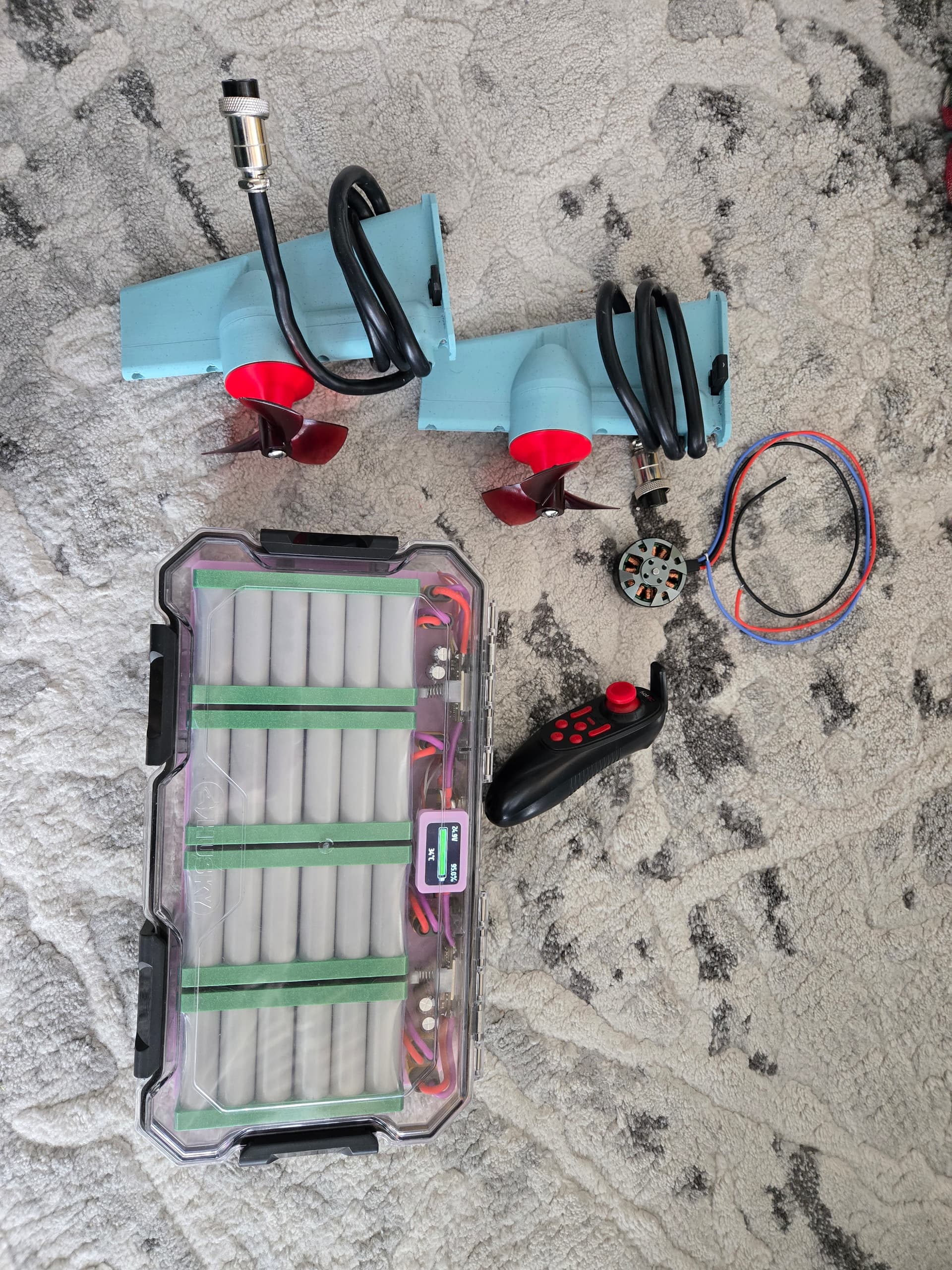

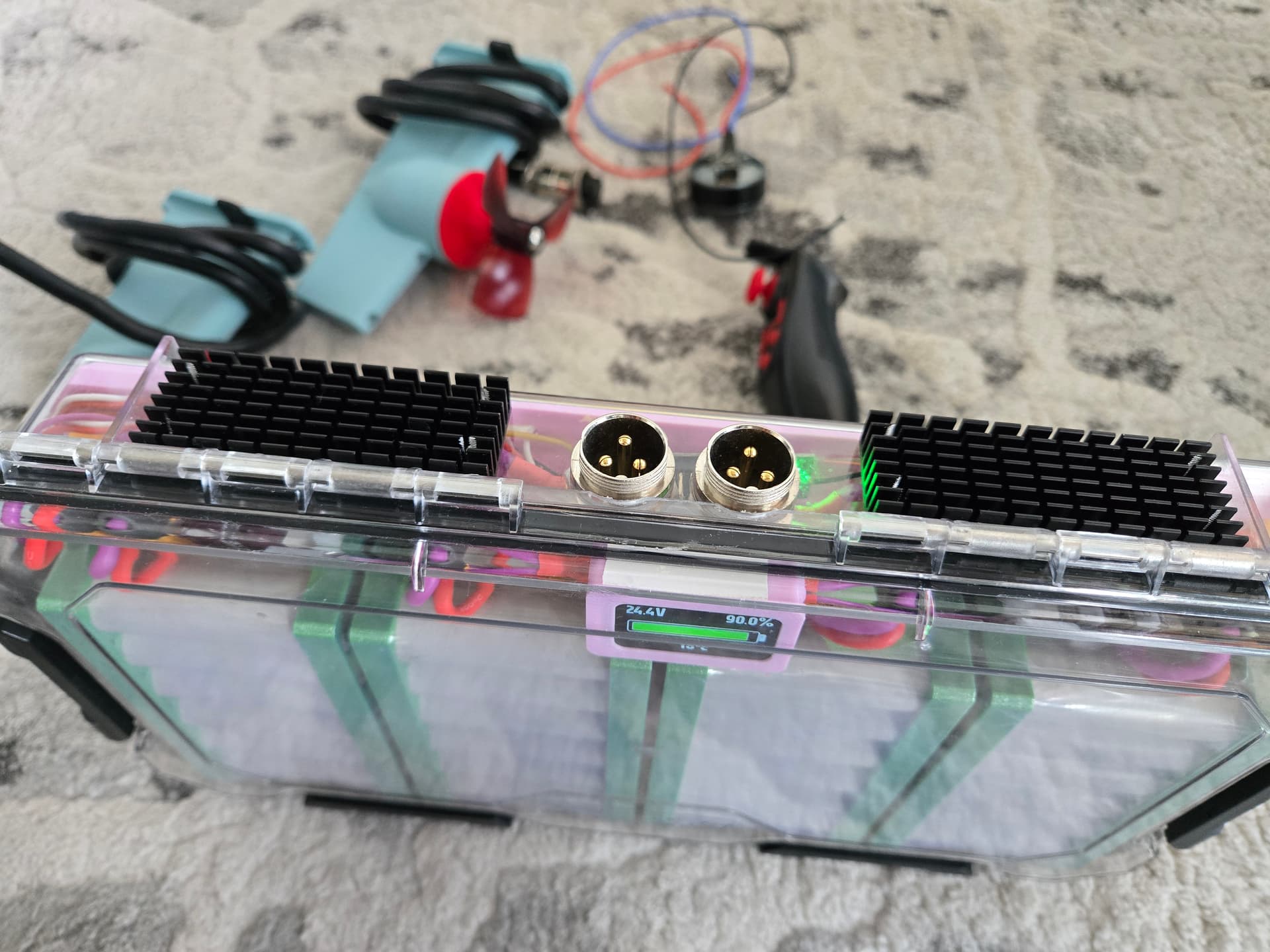

I have been experimenting with SUP since three years and this is the latest build which performs really well. I have used 70A rated AM32 ESCs mounted on heat sinks. A really good waterproof case from home depot which has thick gaskets that are much better than gaskets in the waterproof grey junction boxes I used before. The case is very low profile so very stable when tied down on the board.
I used 4208 brushless motors which are drawing 30A each with a 80mm propeller. I have no issues with ESCs overheating now. The heat sinks get warm after few minutes of use and perform as expected.
It is a 6s setup with 48 molicel p28A. but in future I am planning to convert it to 12s and use it as a tow boogie to get into foiling. The current setup performs great and is able to get up to 10km/hr. Would this speed be enough to get foiling using a kite foil or wing foil board?
