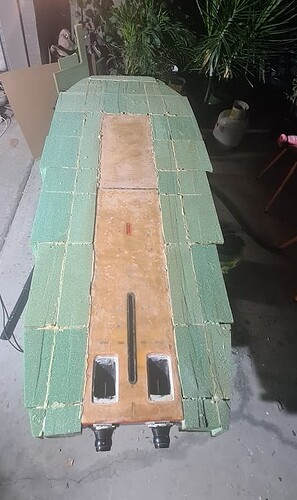

The plan for the board is to build a plywood frame and then cover it with masking tape and then fill it with two part expanding foam. This should expand past the frame so that I can then sand it all back and cover it with epoxy. The board is heavy, but I should have plenty of power - about 45kg of thrust.
Cutting each block is painful, but the result is incredibly stiff and strong. No idea how I will cut the board to shape at this stage.
The red insert is the cooling water intake, the long black slot is for the fin.
