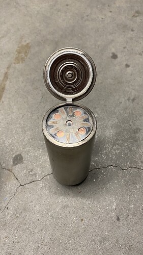

-16s 1p 4680 cells (30ah each, 1776 Wh total)
