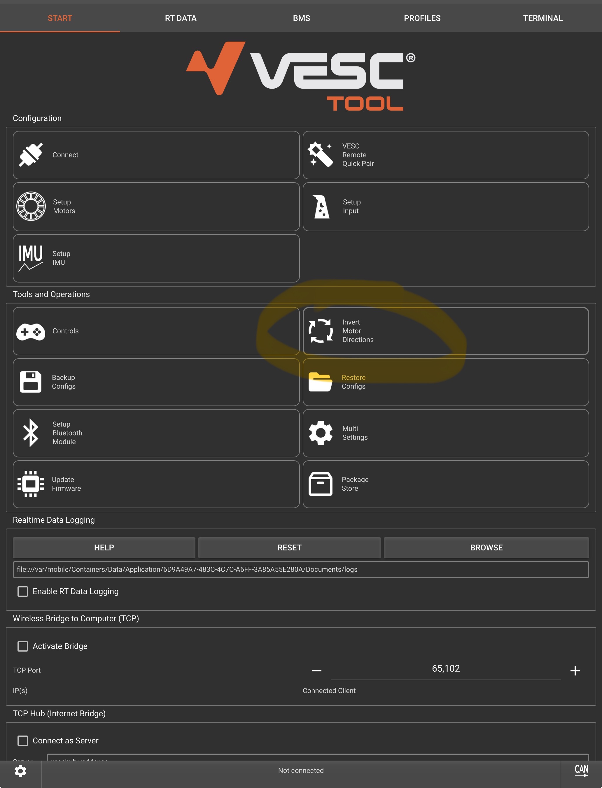

You can do so under motor settings, there should be invert motor direction and put it on. Or you can just try to swap one of 3 phase wires and it should invert direction.
It’s on the main page in IOS VER OF VESC tools
