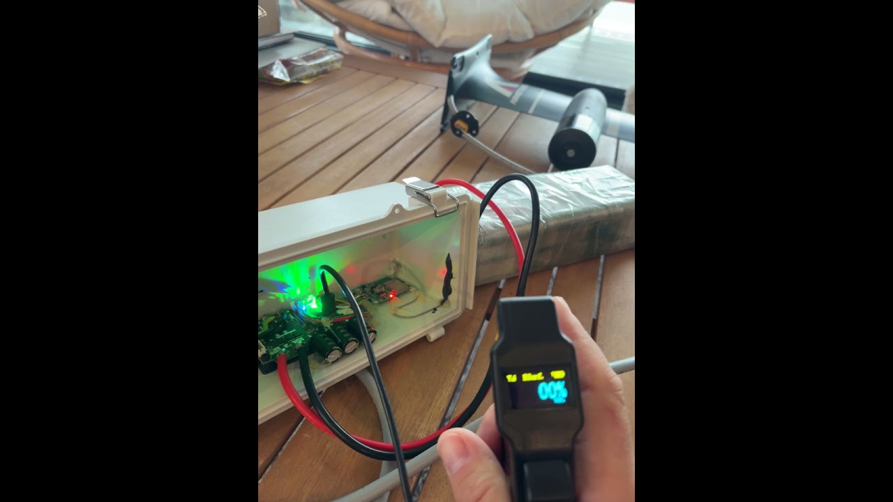

I am on the brink to pot my first built and try to cull out all uncertainties…as if that would be possible :smiley:
So when all completed, I watched a few you tube videos, as recommended.
Main questions I have at this stage:
PPM mapping: It did not save the values despite clicking save (tried to app and to motor)
I also did try to detect the FOC parameters. But I am a bit surprised about the values.
Motor Current Max: 44.70 A
This looks a bit low to me, as it is a original Foil drive motor.
Any idea why it is popping up so low?
Thanks,
P
