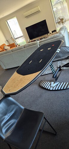

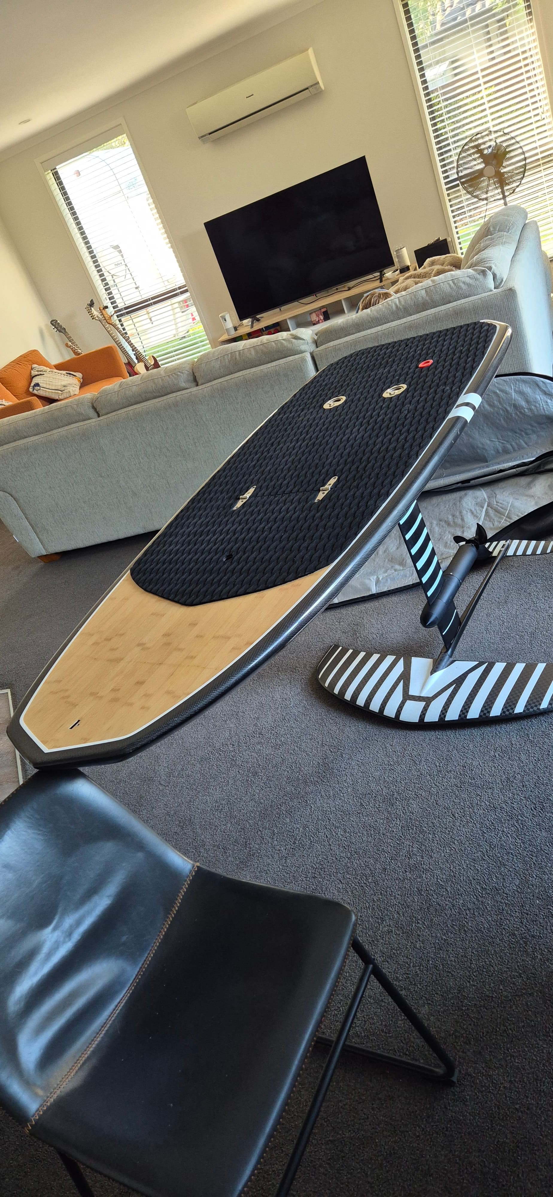

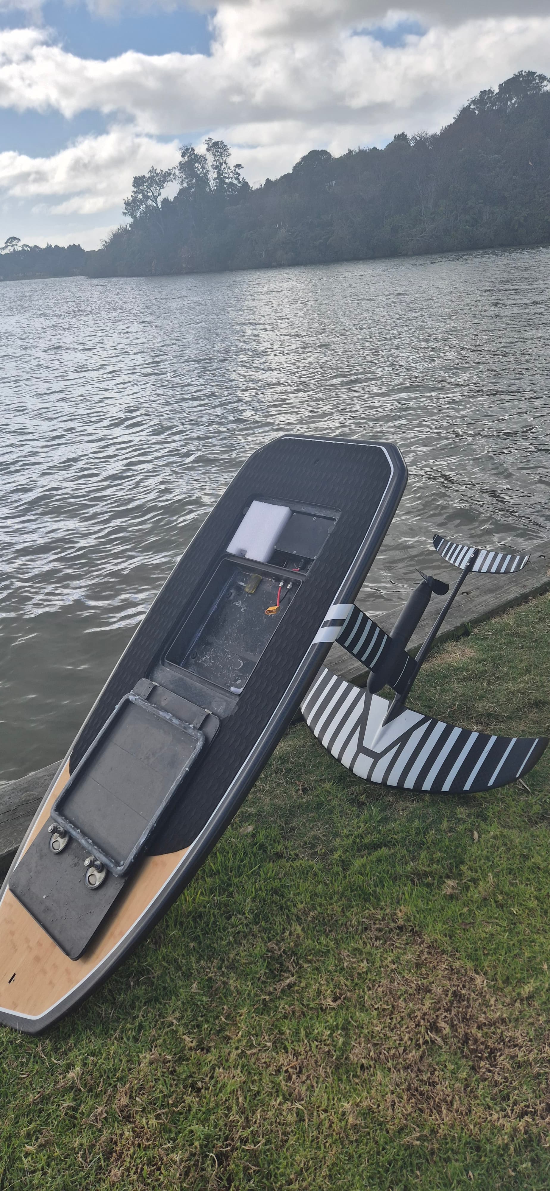

Ps also a pic of my board for fun,goes really well and very quiet with the flite prop.

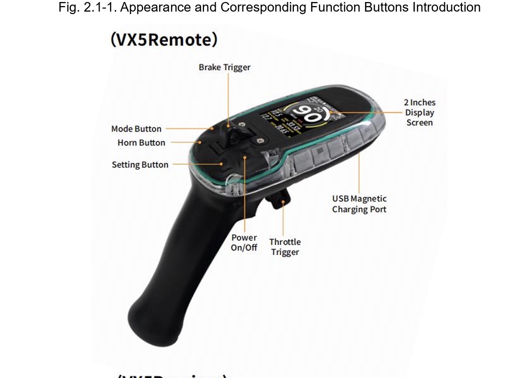

vx 5 you can put gear in L M H (like the vx3) and manual up tp 20 gears
you can change gears by pushing a button (right side under )

So you say there is a button underneath? And this allows gear control like the fliteboard and some of the other high end boards.

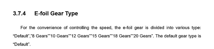

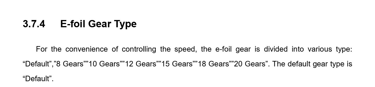

I highly recommend downloading the VX5 manual as there are a LOT of variables to choose from.
To answer your question about gears the following might help
I learned to ride with a vx3 in H mode and when I tried the gears in VX5 it didn’t add much for me although I have had people learn with it and they found it a lot easier than just L M and H modes
