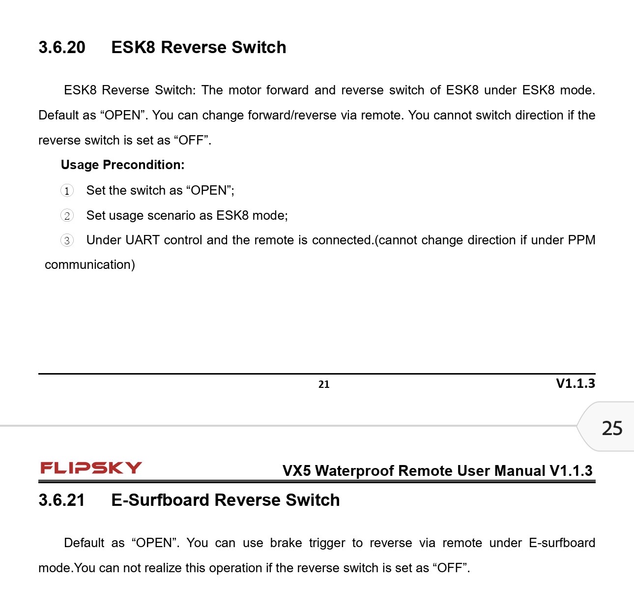

The main one is that I can’t get the motor to run in reverse. I believe I have been through all the VX5 related settings but no reverse. The brake trigger does operate a brake function stopping the motor quickly but I have not been able to get the motor to actually run in reverse. I am planning to use this thruster on a Kayak. I also have the Bixpy motor and it does both forward and reverse. Maybe I have to actually change settings in the ESC? I have some RC buggies and and the brake operate an actual brake on the first press but operates reverse if I release and press it again. So I guess that is what I was expecting (or hoping for).

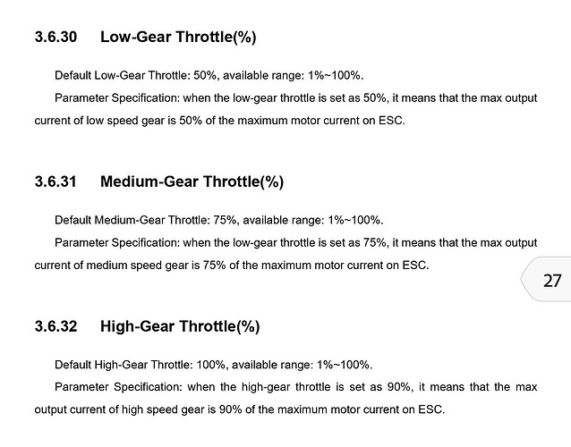

The second thing has to do with the default “gear” setup. In the Default gear setup, there are three gears L, M, H and you can set throttle % for each. What I see when I run in this mode is that the throttle is basically on or off. Maybe that is intended but not what I intuitively expected. Once I get past some deadband, the motor runs but the speed doesn’t change with throttle position. If I change the gear setup to 8 gears, then the throttle does vary the motor speed as I would expect.

Pretty sure you will have to enable reverse in the ESC
Out of the water or with load? This behavior is normal for current control, without load it will go straight to maximum rpm
Try it in the water, it will be fine

I guess we’ll see about the throttle control. It’s just that the throttle was variable in 8 gear mode but not Default mode.

In VESC setup in my 75200 there was an option for “no reverse” which I chose. I would assume your vesc would need to be “enabled” to allow reverse to happen at all.
The VX5 has a lot of variables so my recommendation is to download the full user manual that matches the ver of firmware you are using. See VX5 topic for the link.
The reverse option is a little different if you are using esk8 or surf. Here is relevant page from manual
The gear stuff in a little confusing. The VX3 version of the remote came with the H,M and L ability and that carried over to VX5. The VX5 added in the ability to use “gears”. They are both ways to limit the max output. The number of “gears” just chops the max into more than the 3 pieces of H,M and L.

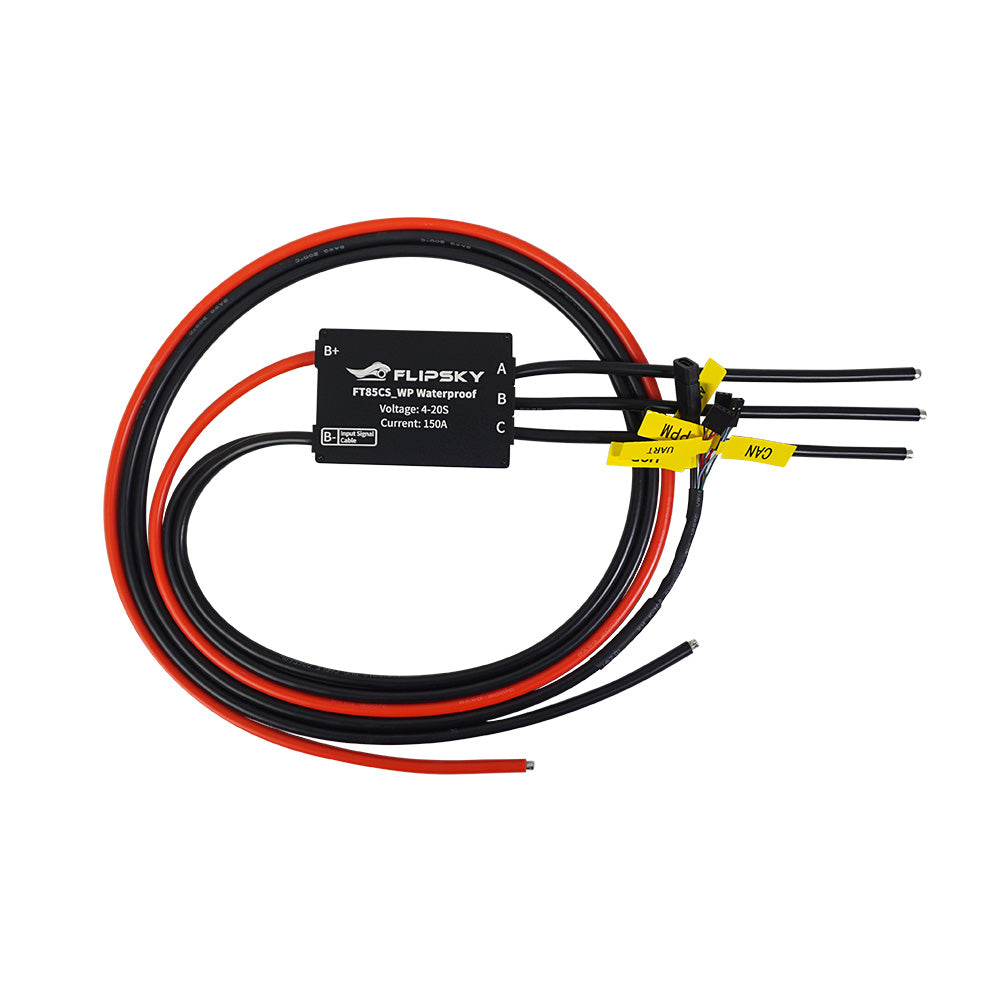

Well my ESC is a non-VESC. Here is the product link if want to take a quick look.
In the description under features is says:
  • Programmable via Flipsky ESC Tool to be compatible with multi-types of motors, different battery voltages and multiple control methods.
  • Programmable via Flipsky remote controller VX4Pro(remote firmware version: VX4Pro_V1.2 and above).
So ESC Tool is the non VESC version of the PC software. It also mentions programming via the VX4 remote which may mean also with the VX5 but they didn’t update the website. If you look in that full manual, there are two main sections in the setup menu: Remote and Board. The Board setting (look to me) like typical ESC settings. The question though is whether they ported 100% of the available settings or just some of them. Unless they tell me in chat, there would be no way to know without firing up the ESC Tool and comparing. But in any case, a lot of the ESC settings are available in the VX5.

" VX5 Esurf mode supports forward only with braking; reverse isn’t available there yet."
Perhaps you can run it in rsk8 mode and get what you wanr
I tried Esk8t mode and I did not see and reverse actually working. I did get another reply from Flpsky:
Yes Mark, in Default mode the throttle is basically on/off at each gear; only 8‑gear mode gives smooth variable control.
We’ll pass your reverse request to our engineers.
So what I observed in Default mode seem to be what they intended. It looks like they are open to adding reverse. Hopefully it’s just a firmware change.
