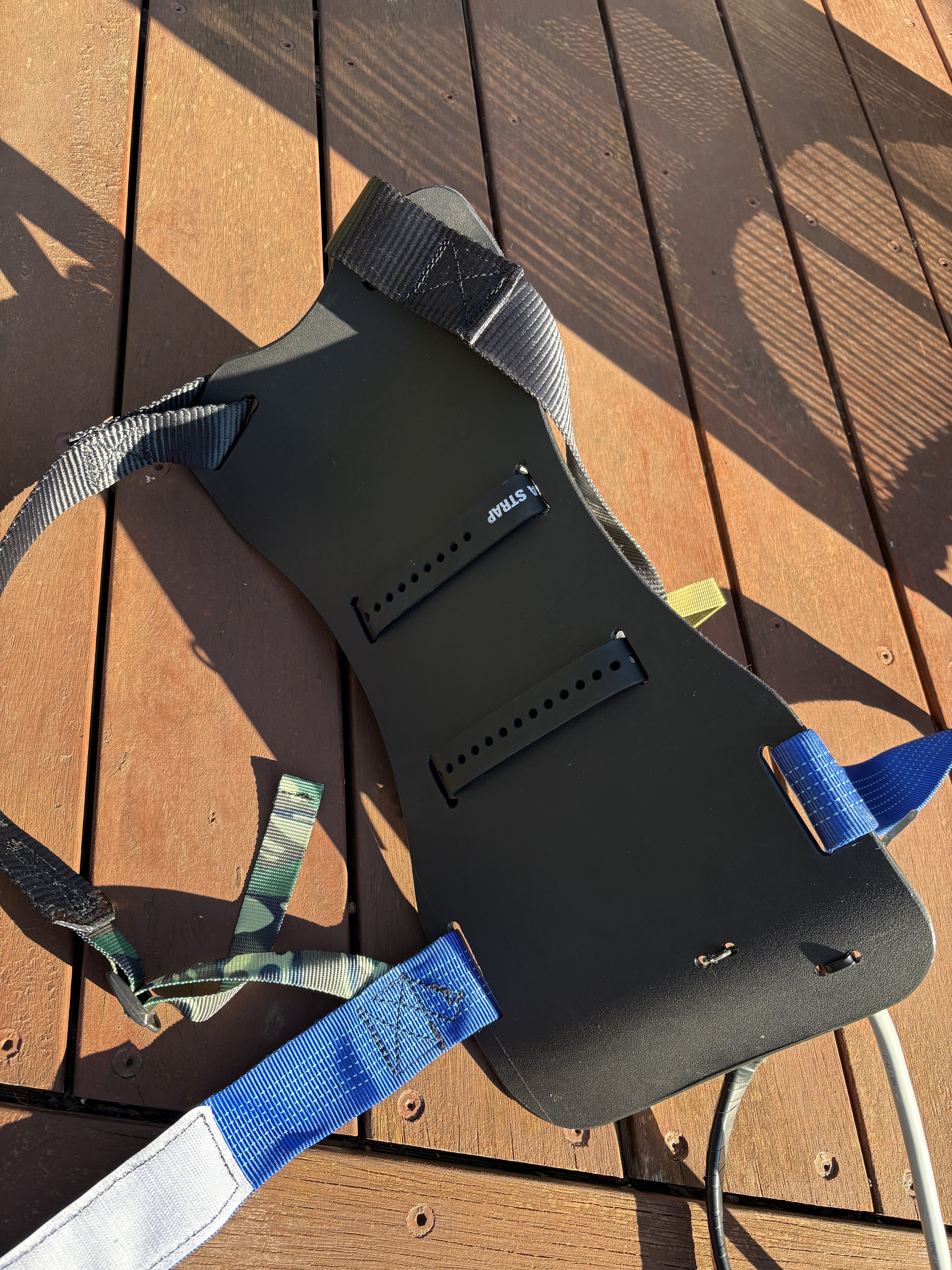

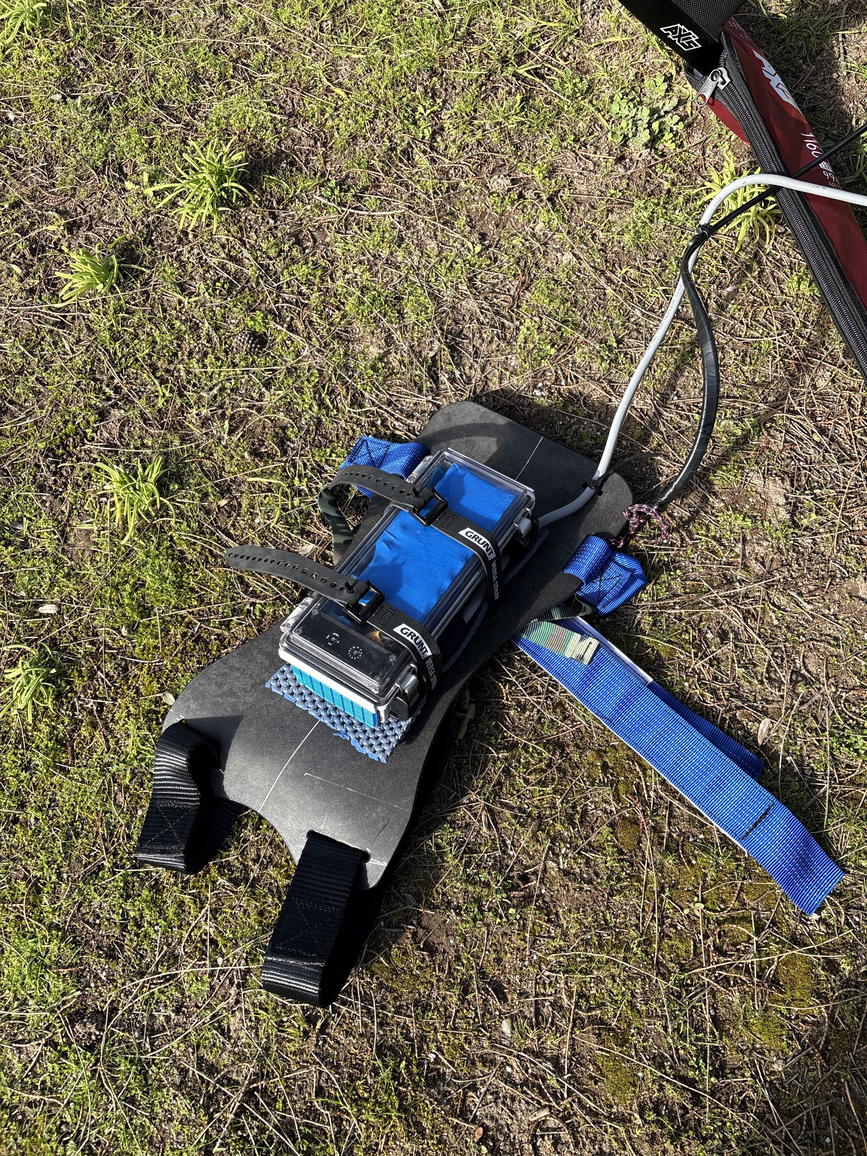

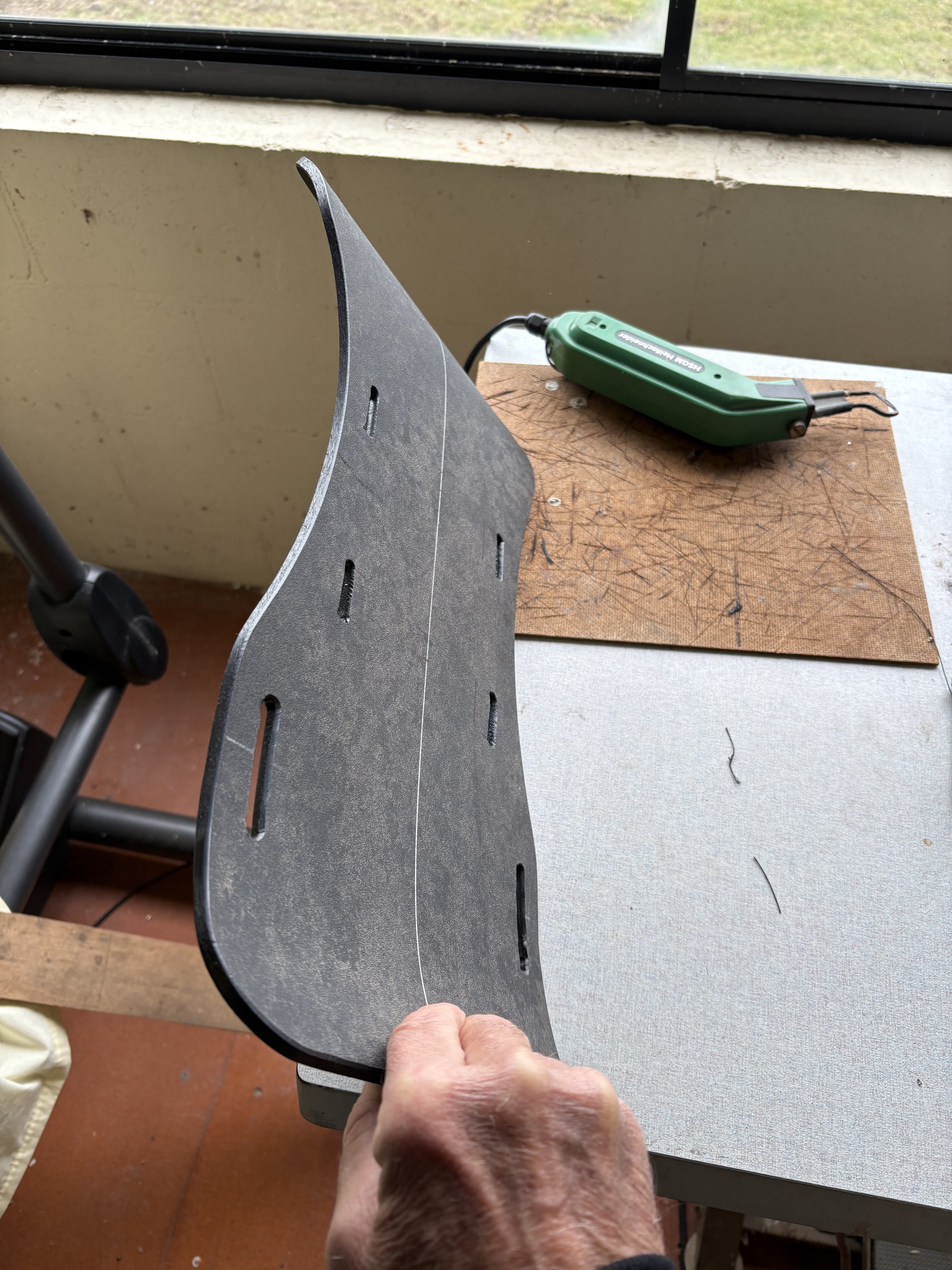

Simple and light and effective. This is made from 6mm Starboard and takes all my different ‘experiments’. Shoulder straps with waist and chest straps stop it bouncing. Been using it for a few years now, nothing has changed. Routed out the slots and bent it into shape after softening with a heat gun. Starboard sheet is HDPE - marine product, super easy to work with.
Initially I modified a Dakine waist windsurf harness, this is so much lighter and actually works better. Shoulder straps change everything, biggest thing is to stop the weight bouncing around.

Having some flex is really nice, when you pop up. It’s really just HDPE, should be able to get something similar almost anywhere. I just had some old sheets in the shed.
You can sometimes find cutting boards for food prep made from the same plastic as starboard. You can get different thicknesses as well.

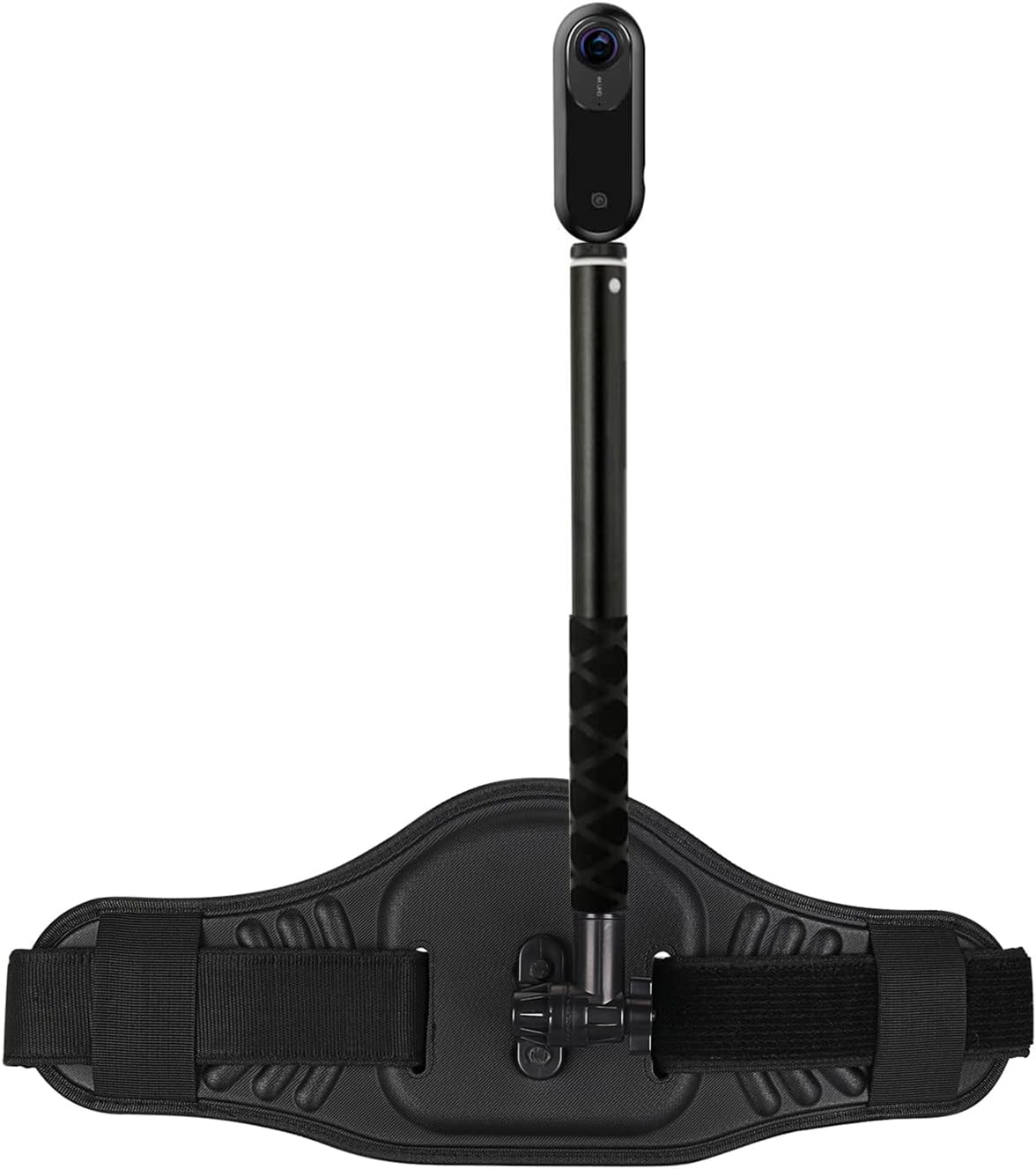

You could use those belts for doing curls they are light and cheap and pretty wide comfortable. I have one from AliExpress it’s foam and fabric.
I bought 3 belts form Aliexpress, they are too flexible, they give me back pain if I pump for several days. I will try with cutting boards
I didn’t try this one. It looks fragile ?
