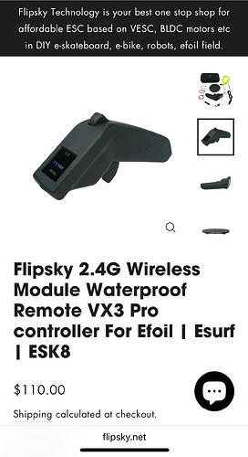

this is vx2 remotes.
so why they sell defective versions

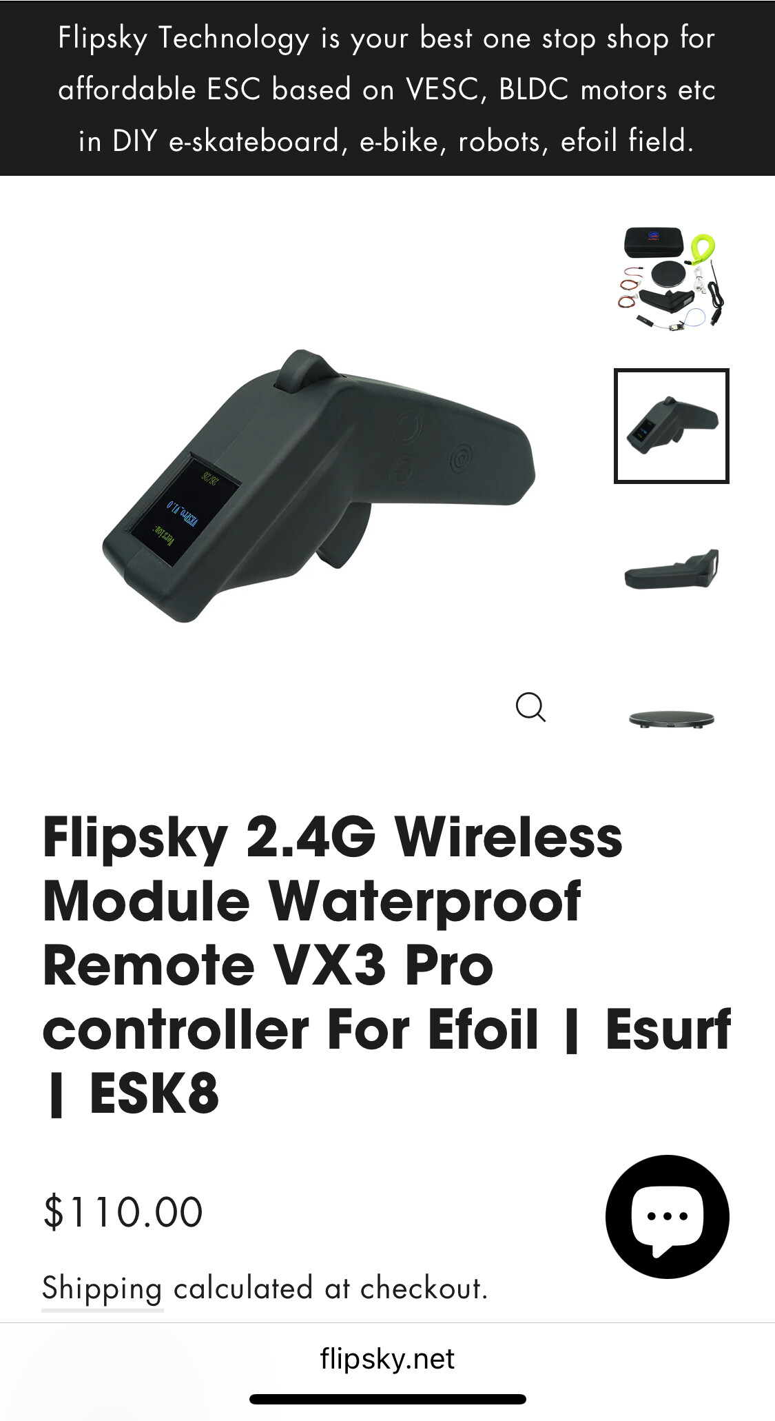

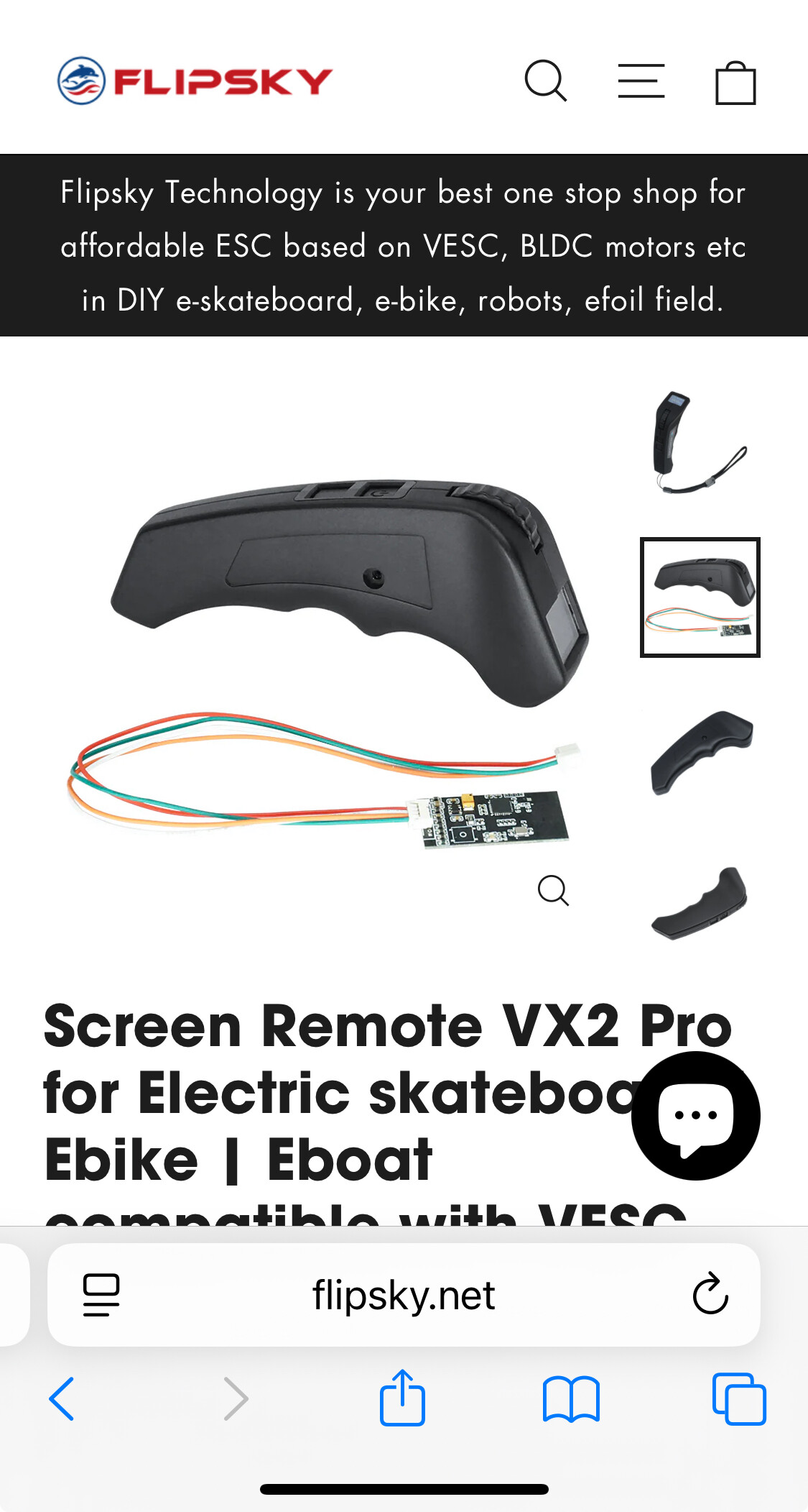

From your photos they certainly look like VX3 remotes NOT VX2 that have finger indents in the handle based on the photos I post below.
I’ve not heard of anyone here using VX2 remotes for our purpose. Is there a reason why you chose VX2?
My Confusion
I meant vx3. Not VX3Pro

I screen grabbed the Pro version but it isn’t really different from the standard one other than a few software features.

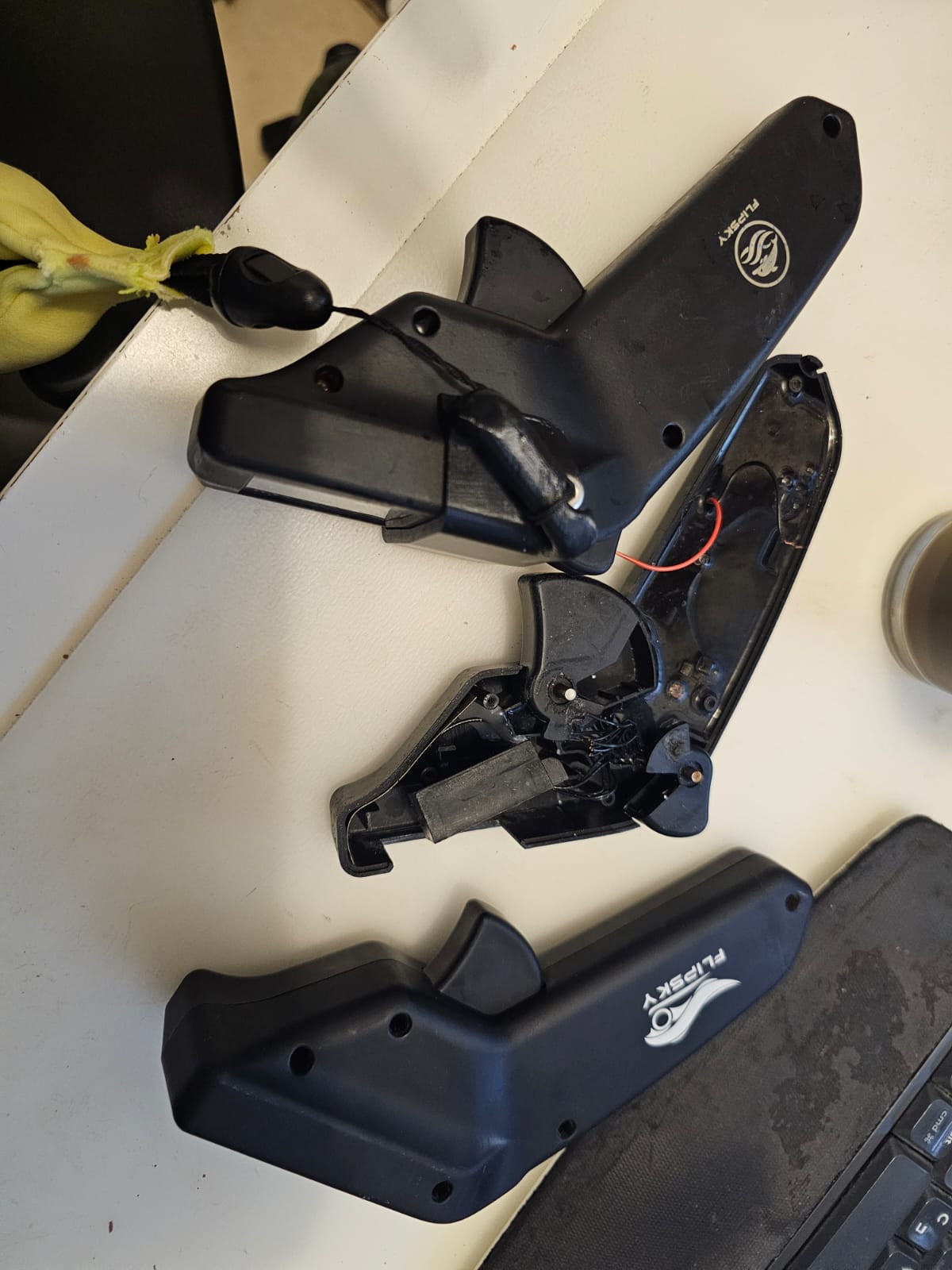

There are two versions of how the waterproofing was done on these:
Early ones used a softer RTV potting compound, water leaks up the interface between the RTV and the battery wires and eats the PCBA.
Newer ones use a rigid black potting epoxy which is better.
When I bought my replacement (with a 50% off coupon for the failed one) I immediately took it apart and painted the innards with epoxy. Anywhere the black potting looked thin, or around any wires, I added more epoxy.
My replacement has been running solidly for a year. Mix of fresh and salt water, mostly fresh.
