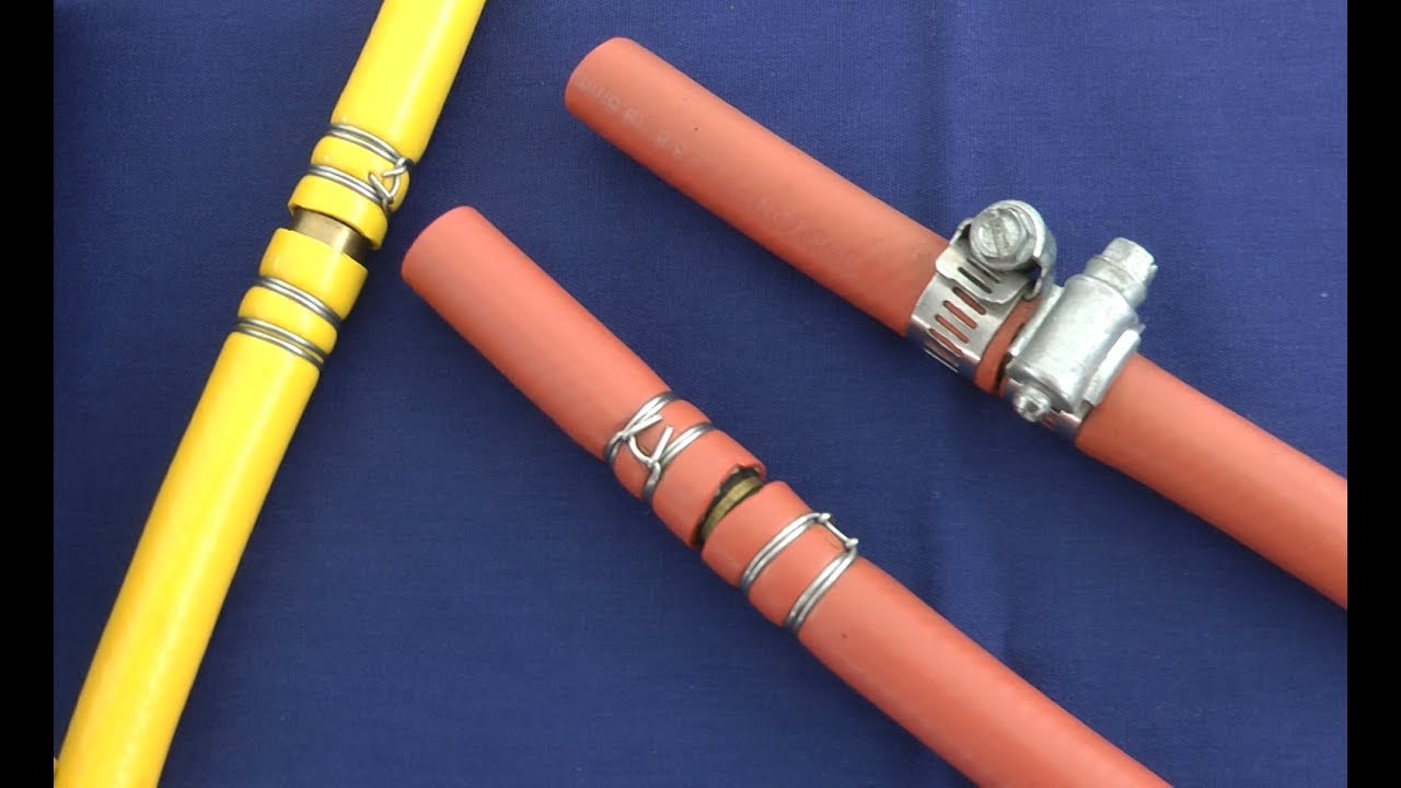

Anyone have a better connector idea for the water cooling tubing on your ESC? No matter how tight i torque these hose clamps the tubes still leak into my waterproof box. If I turn on the screws too hard they start to strip:
Well, if you managed to squeeze these beefy hose clamps in there then you probably be able to replace them with a standard or smaller size zip ties, just carefully tighten them with needle nose pliers
thank you - will try!
Use steinless wire and this tool. https://www.amazon.de/Draper-38896-Drahtwirbelzange-250-mm/dp/B0001K9U5A/ref=asc_df_B0001K9U5A/?tag=googshopde-21&linkCode=df0&hvadid=255989693737&hvpos=&hvnetw=g&hvrand=5492562016177215557&hvpone=&hvptwo=&hvqmt=&hvdev=c&hvdvcmdl=&hvlocint=&hvlocphy=1000695&hvtargid=pla-422783057953&psc=1&th=1&psc=1
It locks like stiff PCB hose. Try with silicon hose.
