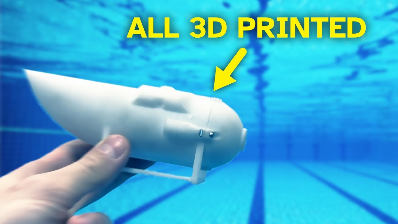

I was looking at a video about submarine building and they were calculating how much water would get inside the prints within a short amount of time.
Perhaps this would explain moisture problems that some have been experiencing.
They suggested submerging parts into a specific solution that waterproofs them post drying.
