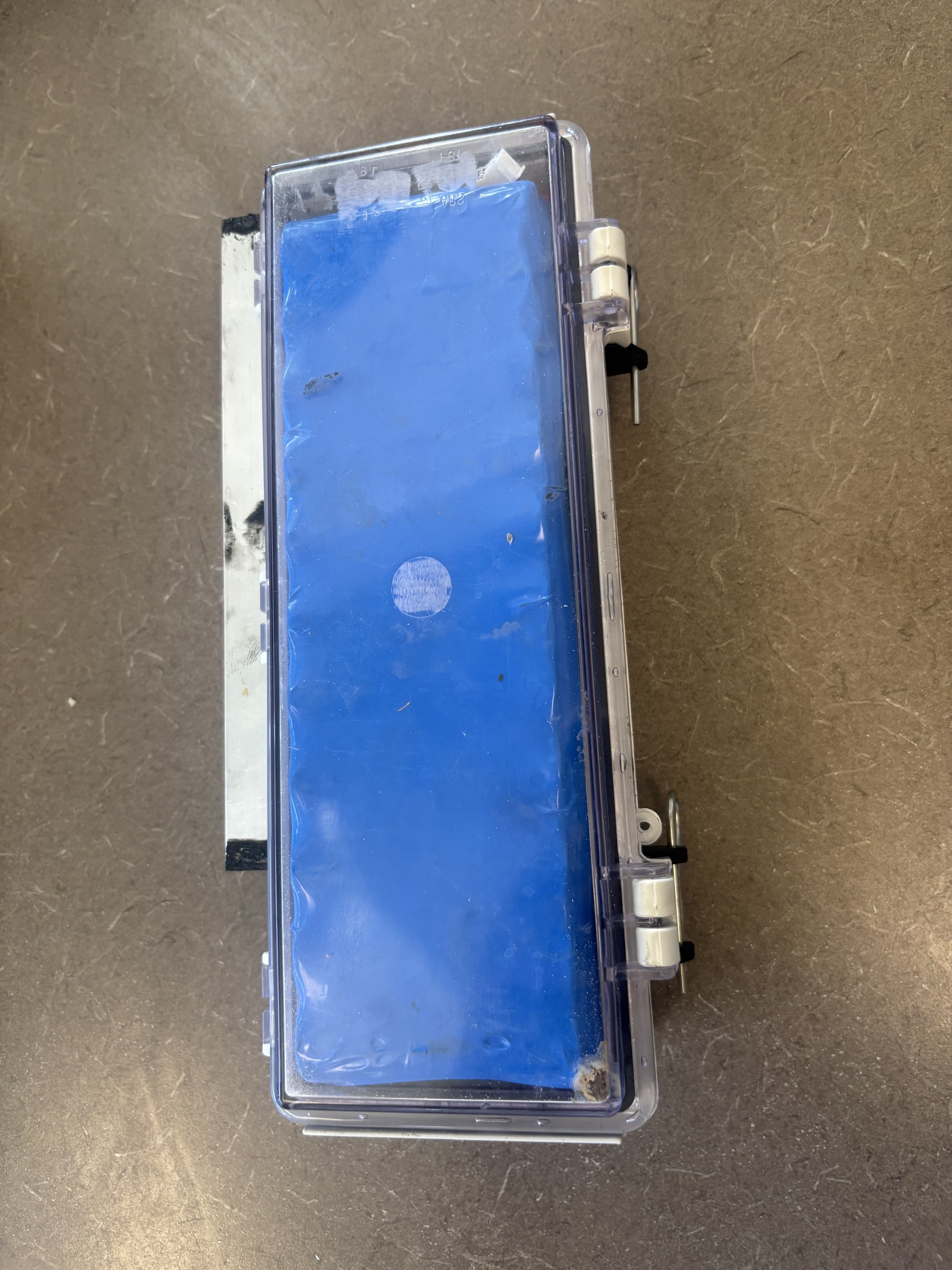

Thanks mate. May I ask what box did you use for a 10/11s?
Did you buy the 140 KV or asked for a customized KV? Cheers
Digikey is supplier
NBF-32408-ND Product number
I use 11s3p however very tight fit 12s 2p makes it easy
Need to sand down ridge in centre of the box.
