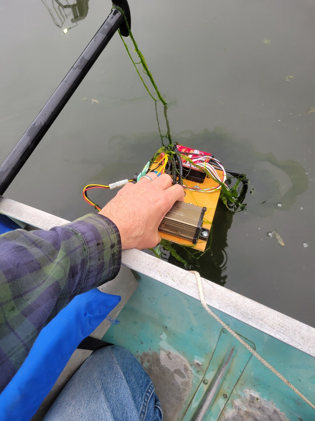

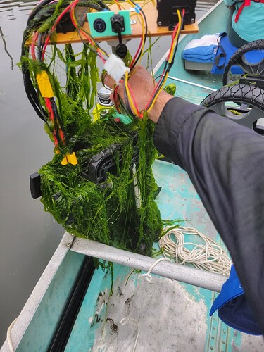

Next step, repair the water damage to my VESC 6 75 after she spent the night on the bottom of the bay (salt water).
